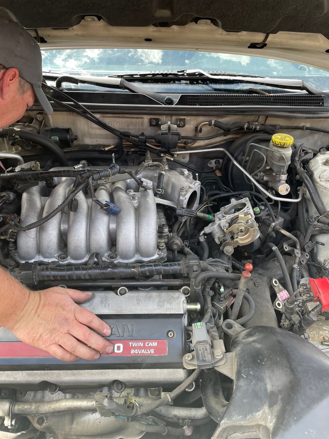

Hoping someone can help me here..
1999 Maxima

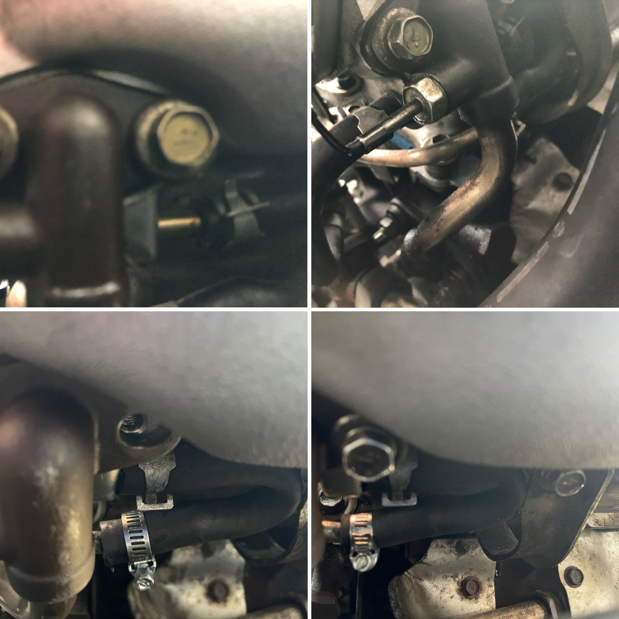

Had a coolant leak at the two small hoses near EGR behind UIM. Caused over heating.
took out battery, intake, unplugged connectors and took off UIM to get a new hose and better collar setting on. Got that done.
A couple days after, started idling at 1500rpm in Park and Neutral.
Read some threads here it could be:
-EGR needs cleaned or sensor
- IACV needs cleaned or sensor
-TB needs cleaned or TPS bad
-clean MAF and Air Filter
-bad IAT (after market aluminum tube grommet, part isn’t snug)
Also saw some people adjusted the screw on top of IACV.. but I won’t do that.
while setting the coolant hose,
-UIM gasket still fresh rubber from replacing 2yrs ago, didn’t replace, made sure mounted back in place at 17ft/lb torque
-cleaned IACV with carb cleaner.. might’ve got a bit of it on the solenoid.. could that be an issue?
then the 1500rpm idle.. so I,
-used MAF cleaner on MAF, let dry
-used K&N filter cleaner/oil kit to clean my eBay short Ram filter
-IACV took off to make sure it is clean ✅, the metal gasket is rare to find online w/o buying kit,. Gasket was bowed a little, I used a light coat of HighTemp gasket between the IACV and gasket, let it cure before tighten onto plenum and operation.
-after market Ram filter plastic mounting and rubber gasket bowed, used a light coat of gasket maker between the parts, let cure etc
Let everything dry and settle, put everything back in place.. drove to store, idled at 400-700rpm and lagged acceleration..
notice my TB Accelerator cable has about 1inch play..regardless of adjustment.
the next day, car cranked and won’t start.
what could I have done wrong or could it be?
thanks,
AM

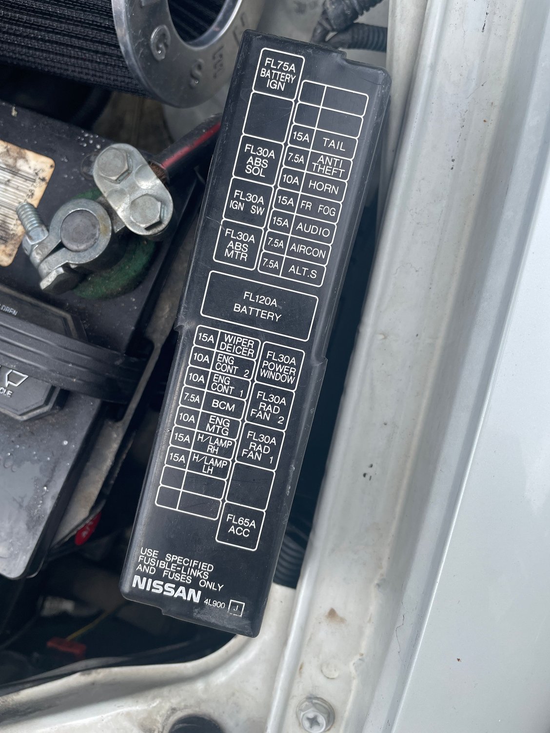

I just checked fuses.. the ENG CONT 2 fuse bad, replaced, started and it turned over, new fuse popped…
help please

Per the FSM ENG CONT 2, FUSE #57
MAIN
MAFS
POS
AAC/V
EGR
IGN/SG
EGVC/V
PGC/V
NATS

car still doesn’t run.. blowing out Eng Cont 2 10A fuse.
car will run on 15A fuse there.
