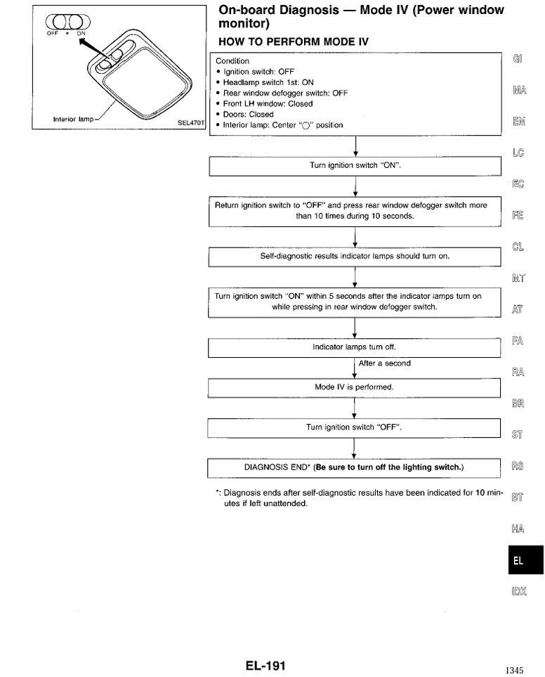

Instead of just living with the totally unacceptable extra 0.5 seconds of leaving my finger on the switch and calling it a day, I go spend the next hour digging into the ELectrical (EL) system section of the service manual and find the On-Board Diagnosis Mode IV test within the In-Vehicle Multiplexing System (IVMS), page EL-191, because clearly I have nothing better to do...and my best interpretation of the function of this test is as follows:
1) Mode IV test automatically rolls down the driver's side window until either,
a) it reaches the bottom, OR
b) it is interrupted by the window LOCK switch or actuation of ANY of the remaining door window switches.
2) Either condition, a or b, causes the window to stop and diagnostic mode to exit
When I initiated this test, the window started to roll down, but moved only about an inch before it immediately stopped on its own. I'm not 100% sure, but this just seems to be wrong. I believe the window should have rolled all the way down on its own unless interrupted.
The KEY COMMENT in the FSM may be as follows:
*** "Power window motor (down) ON... during electrical ripple detection" ***
I'm purely guessing at this point, but it would appear that the AUTO down feature works by the control switch (LCU01) electronics board monitoring the motor's ripple current until the window hits the bottom of travel, at which point the ripple signal ceases, and the microprocessor within the door control switch sends a signal to the Body Control Module (BCM), telling it to UN-latch the down control signal to the window. Whew.
HYPOTHESIS: The running characteristic of this aftermarket motor is somehow different enough that the "ripple current" detection circuit is simply not working. In other words, when I fully depress the switch to the AUTO position, the microcontroller thinks that the window is already all the way down and does nothing.
At this point, I'm ready to pick up an OEM motor off of Ebay just to check the theory, but If this theory proves to be true, I'm going to be blown away that this has not been documented somewhere already. Maybe no one who still has one of these cars really cares about losing the auto down feature, as long as the window goes up and down...always possible. Anyway, The only other possibility at this point would be something wrong with the BCM, but I'm thinking that would be a very distant second to the motor theory.
If anyone with a functional AUTO-down driver's window has the time and the inclination to run that MODE-IV diagnostic (page EL-191), I'd be very curious!
Procedures to run test shown here.
