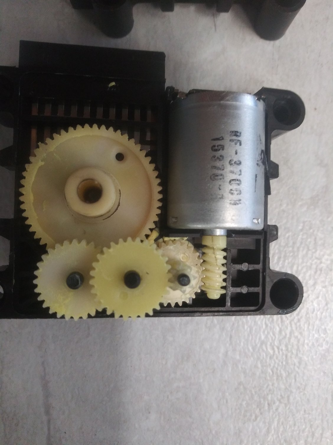

Old Feb 10, 2023 | 06:39 PM
Reality sucks's Avatar
Joined: May 2007
Posts: 621
The mode door actuator is located Just above the drivers gas pedal on the hvac box. You will need to verify how many pins it has first. If it's digital its likely a 10 pin which is similar to infiniti. I just went though this with this my 95 GLE with digital control. The motors get weak or the worm gear crack's (Pictured). The actuators listed for sale in my case at least, were not correct for my 95 at any parts store I could find and non existent aftermarket. But what I could easily find in the mean time were replacement dc motors on Ebay for $3.00 (RF-370C) is what I used I fix my OEM one. Weeks later I did eventually find a OEM brand new NOS one as well which is installed now.. PART: 27731-40U00 pics below are of the motor and the inside of the 10 pin Mode door actuator of a 95 GLE with Digital Climate controls. I have 1 left. Lmk
