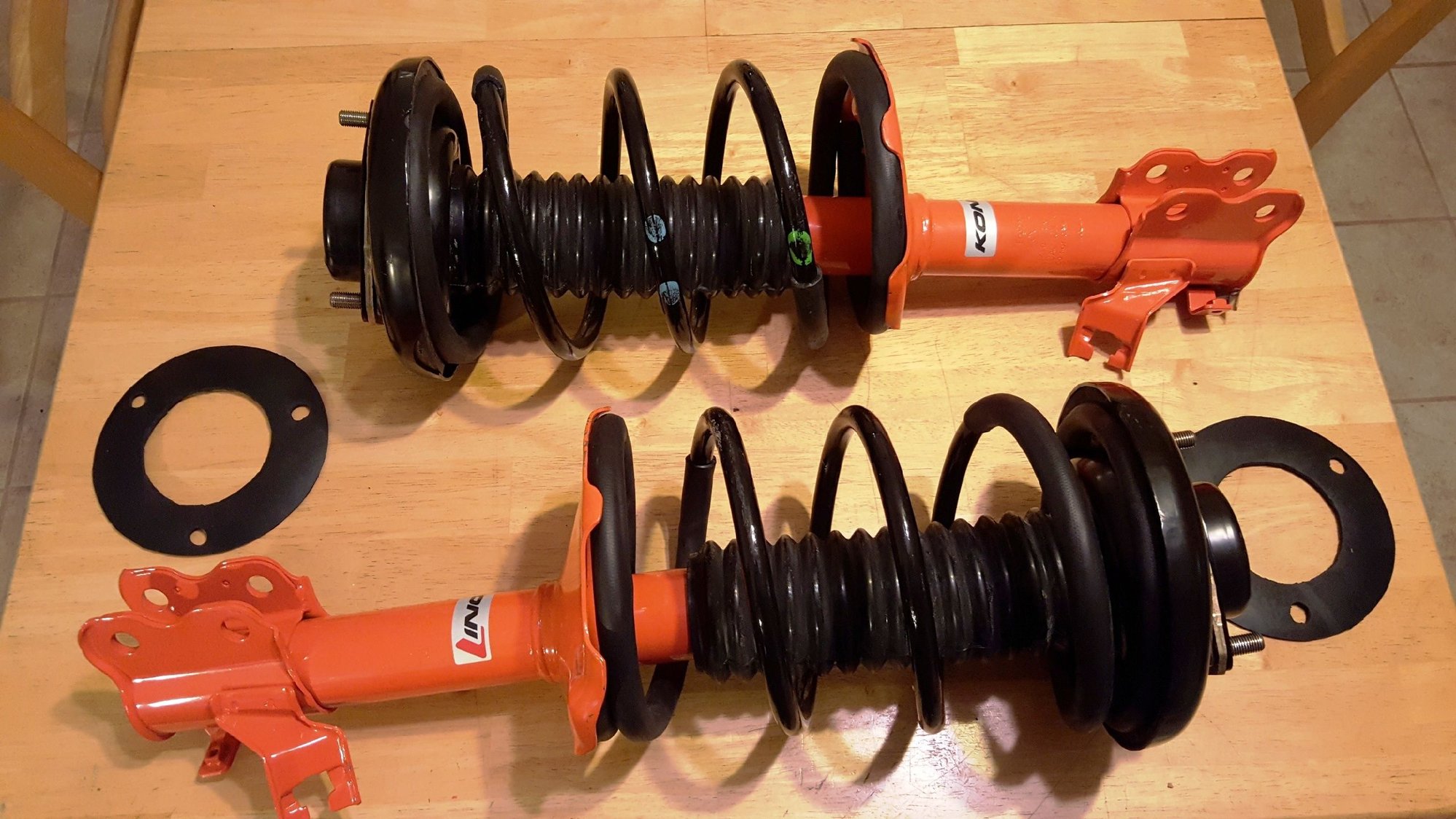

Alright so i got one assembly off and took it apart to find the gabriel strut mount (rubber with the D hole that goes on strut thread) has just been spinning around on the strut, D slot has rounded out, large gap leaves me to believe this part was just junk and the hole spec was off. The strut bearing that came with it barely spins( it was like this before installing) and there is some grinding when it does spin.
I reinstalled the original strut bearing, and the mounting plates and found the strut mount spinning smooth but when i release the spring compressor it binds up and i cannot spin the strut mount by hand (off the car).

I have now removed both strut assemblies and reinstalled the original strut mount plates and strut bearings.
Like Dsonnylal mentioned when i put them on the car i was able to turn them smoothly. Reattached the knuckles and tested at the steering wheel and found the clunking completely gone.
I removed the struts again because in haste i left the gaskets on the old mounts. Reinstalled them with gaskets, tested again and no clunking.
I then put the wheels on the car and gave it another test with the wheels up in the air and found only one small click (its a higher pitch than the clunks were) when during the wheel from about a ¹/² turn to the left from center to a ¹/² turn to the right from center (only when turning right not left)
Going to remove the wheels and test again.

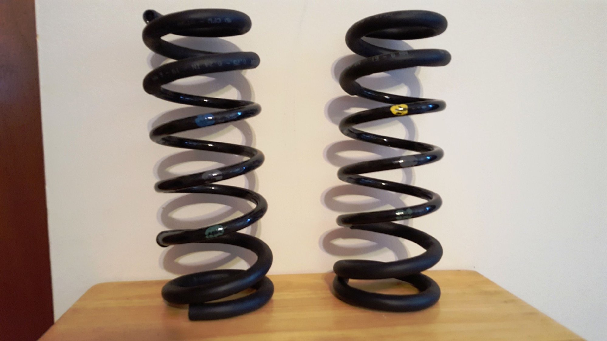

I used Thick Walled Heat Shrink Tubing on each end of all 4 springs. It is SHRUNK on TIGHT and THICK so it will be stable and silent for a LONG time.
And once I spec'd out all the Nissan Parts I needed, I searched on Google with the part numbers to find the BEST LOW DELIVERED PRICE. With the spring compressor and everything else, came to over $900. SO WORTH EVERY PENNY! I spent more than that going full circle to come back to Nissan OEM. Always problems and NOISES. KYB, Monroe and MOOG. JUNK!
The Heat shrink tubing I used is: DSG-Canusa CFW 0750 6 years ago, I bought 4 foot lengths for $13 on Amazon. Unfortunately, not selling it anymore. Maybe they changed the model number or try other retailers online.

Thanks for the idea of the heat shrink im going to need to do the rears next but hopefully can hold off until spring.
