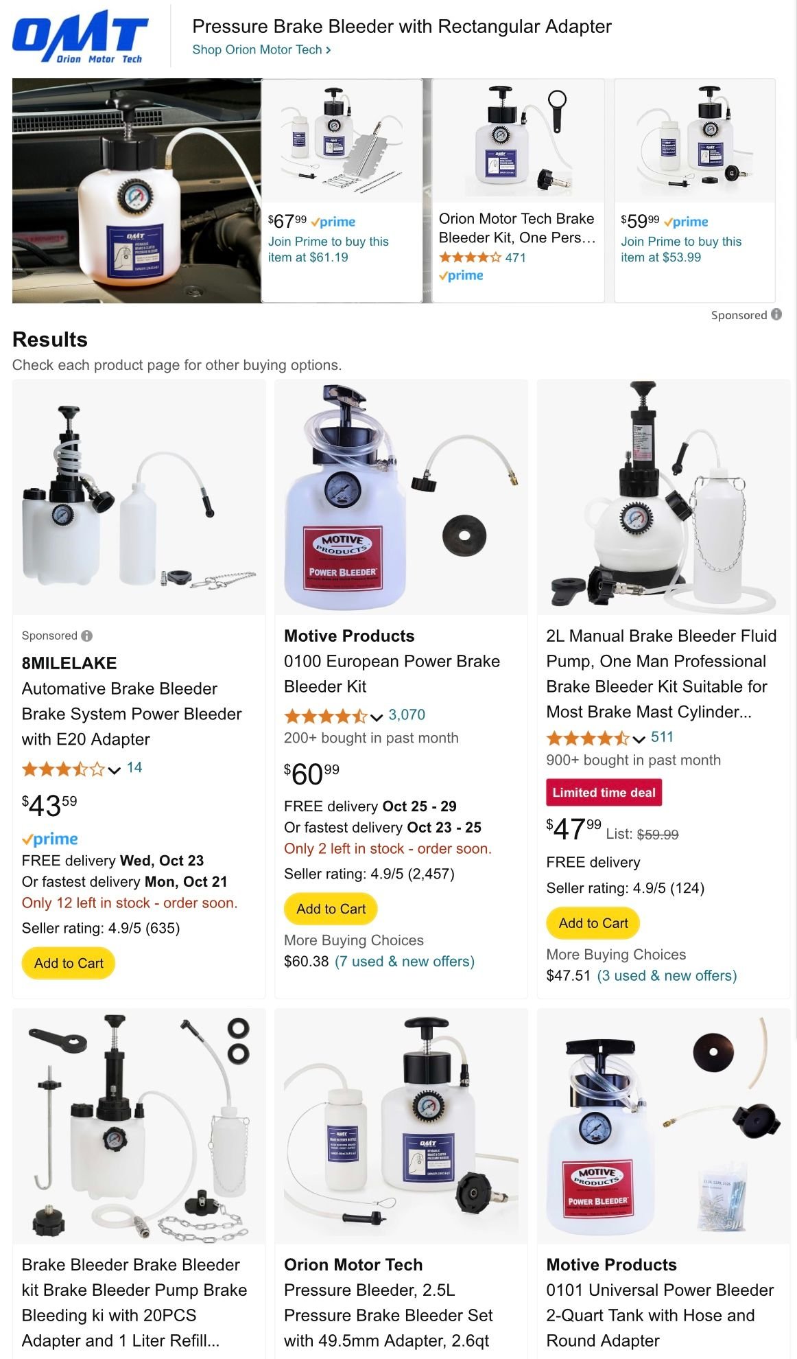

I’d recommend that you get yourself one of these.
It makes things a bit quicker and you’re able to complete the bleeding process in one-fell-swoop.
