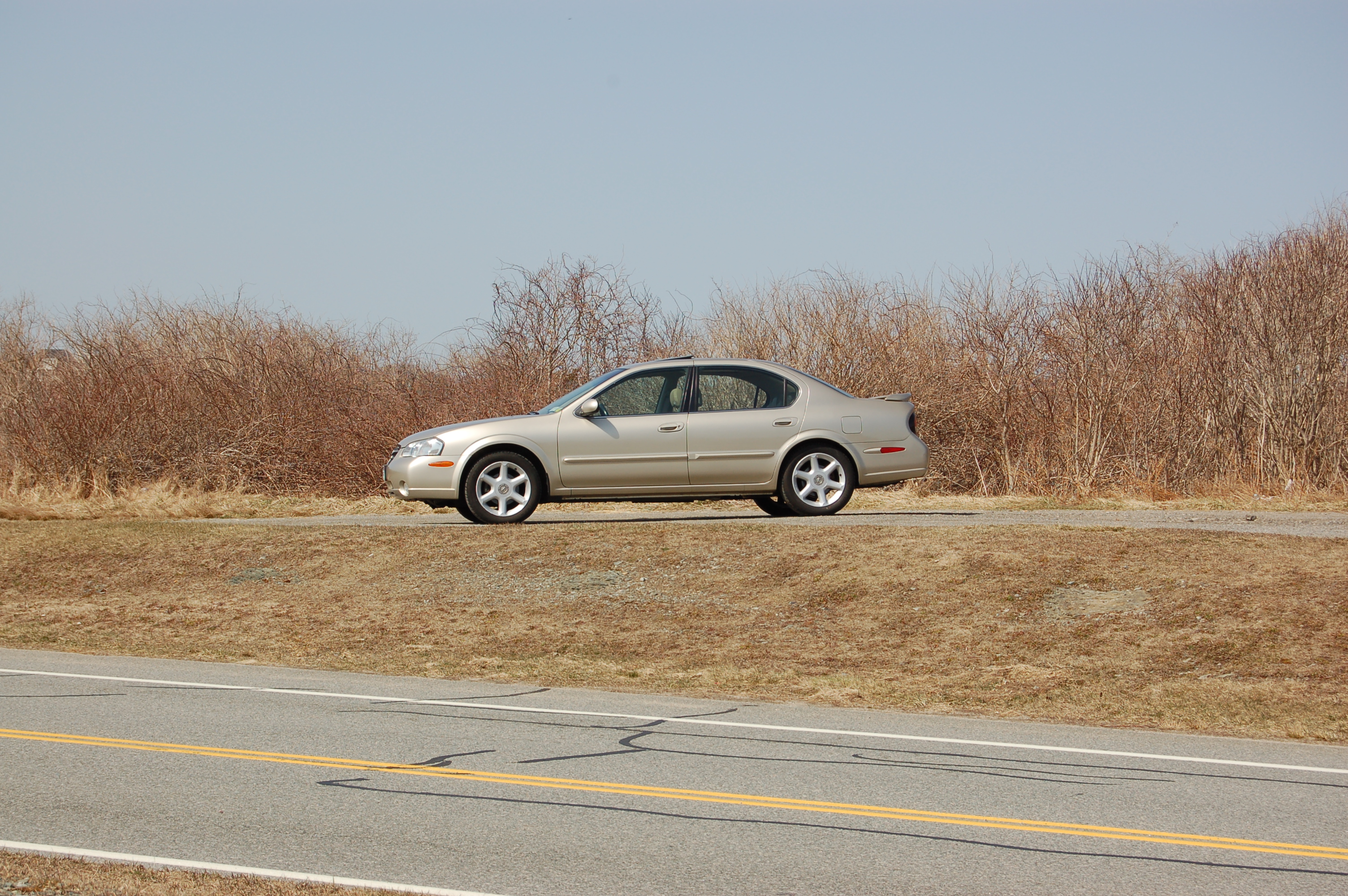

Damndest thing. For the last 3 days after work, my Bose has been blowing me away. It's been years since the subwoofer fired, but the heat - and I'm using a windshield screen - has it working.
At least until it cools down after dark.
I noticed it right away Wednesday, Metallica was pumping on 104.3 I want this full time lol, might be time to pull the rear deck apart.
In her better days - 1 owner car
