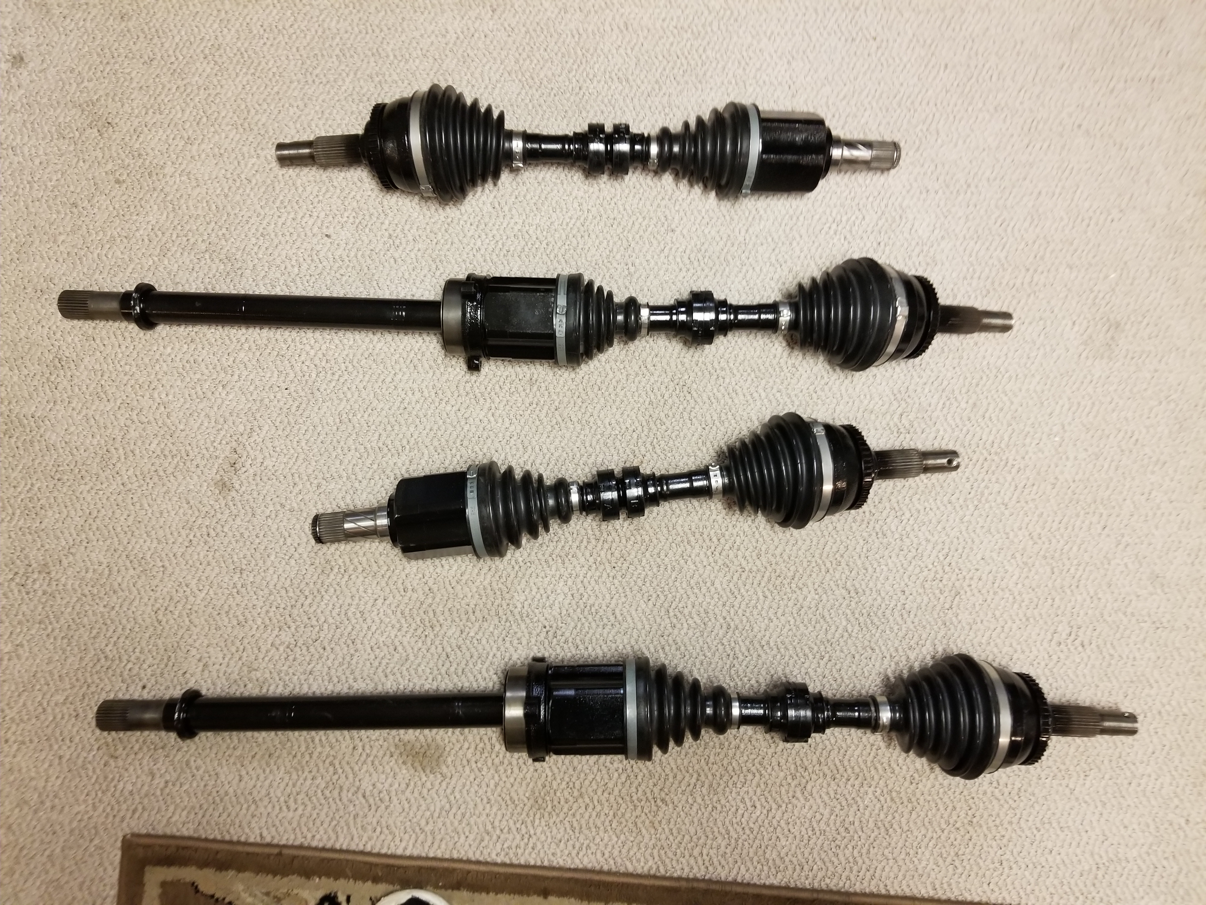

A quick follow up for everyone. Attached is a pic of my rebuilt OEM CV axles that I received back from Axles Unlimited in NC. They look great, and they only charged me $40 per axle + return shipping back to Philly. The final bill for 2 complete sets was $229, and they have been completely rebuilt with new boots, new clamps, grease, painted, splines refinished, etc... They feel 100% better than when I shipped them, no looseness or clacking from inner plunge joint or outer joint at all. I'll follow up with an update after I install in my '02 Maxima tomorrow...
Just to clarifiy since I received multiple responses to my first post... I bought my '02 max in '15. I replaced the oem cv axles as preventative maintenance while gutting the entire exhaust back in '16 since I needed the space to drill out broken manifold / precat bolts (another horror story chronicled in multiple posts on the org, but we live and learn), and I also saw that the boots were wearing down (not leaking, but rubber was looking bad). Unfortunately, I disposed of the OEM cv axles, and wasn't aware that 5th gen Max do not like aftermarket cv axles, and I have been getting a horrid rumbling / vibration on acceleration ever since. I replaced the axles on each side over 10 times with various aftermarket, reman, and used units with no success. I'm positive that it isn't other suspension parts or bad wheel bearings as all of those items have been replaced (some multiple times), and the vibration / rumbling only occurs on acceleration. At this point, I am totally insane, but have thrown so much money into the car that I am not stopping until I find the solution. As posted, I've purchased a low mileage I35 which I am now in the process of refurbing to perfection, but 2x fully restored low mileage 5.5 gens is a good problem to have!

$40 is a bargain! That's got to be cheaper than buying boots alone. Did they give you a deal since you sent them so many?
I love seeing these cars get the attention they deserve. Keep them on the road for years to come.

Good news to report, after a week of driving the '02 Max with refurbed OEM Axles from Axles Unlimited, my rumbling / vibration noise is almost non-existent. I've got a small vibration that I can feel under my feet a little bit on acceleration, but it's mild compared to what I was getting using any of the aftermarket axles that I've ever installed. Today is a good day. Many lessons learned. STAY AWAY FROM AFTERMARKET AXLES!
