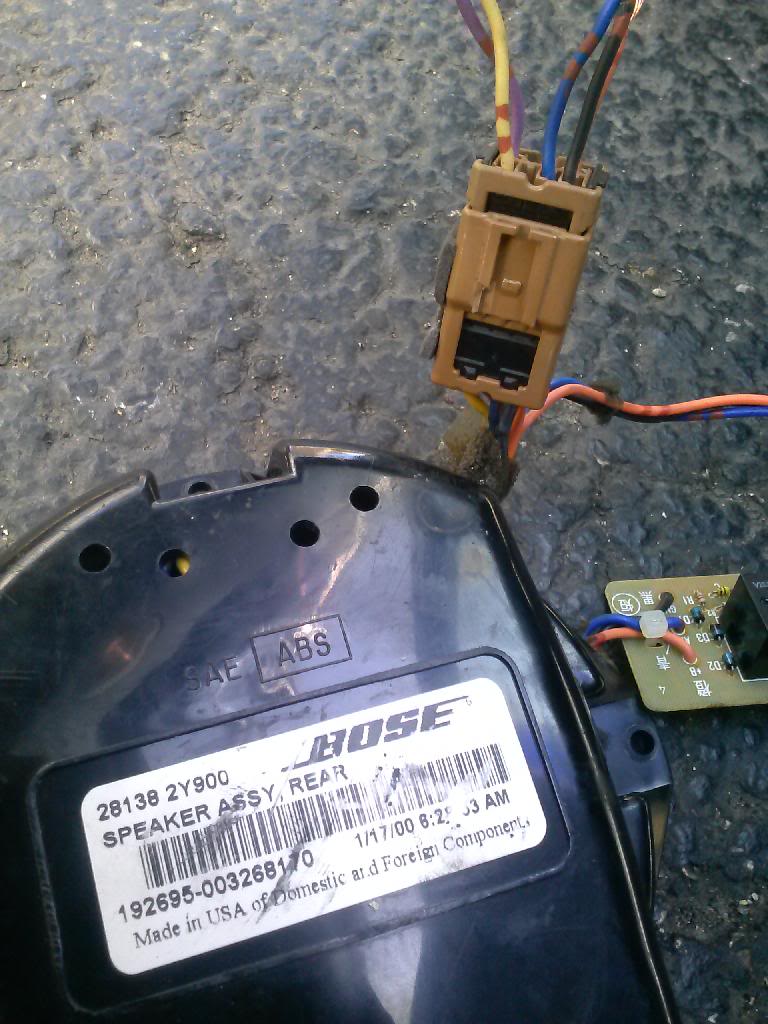

Size:  102.3 KB can someone help!!! If you have your rear bose speaker can you look and tell me which color goes to the yellow wire?white or black? Thank you!
What connector is that? The FSM for the 2000 doesn't have those colors at all.

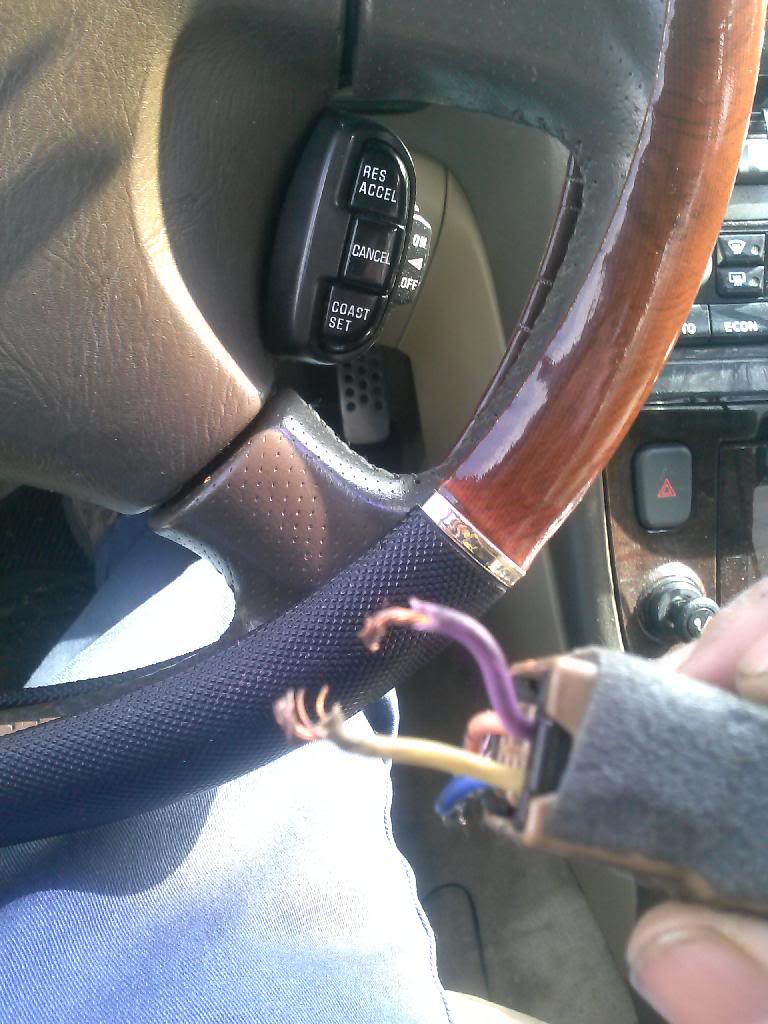

Size:  113.0 KB i know orange:red/ blk:blk/ blue:green/ is the blk and white one idk about the two that are together. ..
OK. That speaker is the woofer for the Bose system, a poor substitute for a subwoofer. I think what you have is a kind of a serious problem.
In your original photo, that connector, or more accurately, the wires, belong inside the woofer. Under that black plastic cover is a metal box that contains a printed circuit board that amplifies the signal for the woofer speaker. Those wires are supposed to be soldered/connected onto it. The Nissan FSM does not show that wiring and I've never taken one apart, so I can't help you.
Maybe if you re-post this in the Audio forum and call it the woofer speaker, maybe someone else can help you.
Yes i took off the connector from the sub and from the car, re-solter the navis and extended the red and green wires to the speaker and tucked the lil cb case behind the trunk liner. I was just confused if purple(sub)went to blk(car) or yellow (sub)went to blk car ...but i got it it was yellow:blk purple:white....
So far the woofer if working...i figured maybe if the cb is not so close to the vibrations I'll stop cutting off and so far so good....i have another cb and i'm waiting for some better relay..
