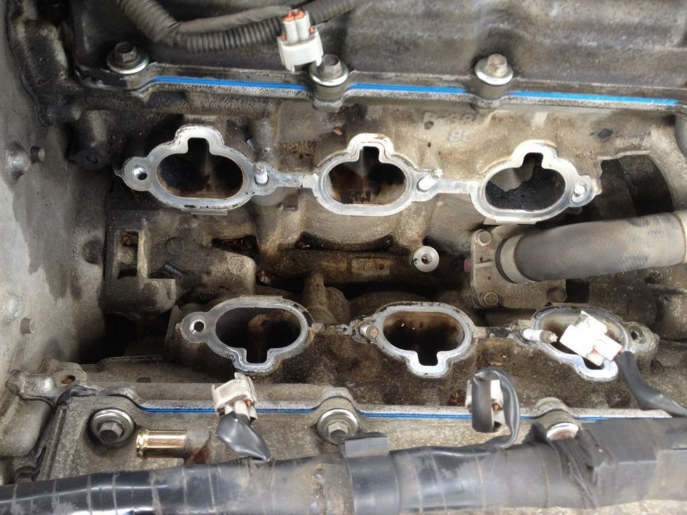

Removed intake to replace detonation sensor - P0325. I'm seeing remnants of oil around the inside of the timing chain case - re seal, rebuild, or just swap with used engine?
It could be fuel because my oil smelled like fuel. I couldn't determine whether it was exhaust related or Detonation sensor related.
Re-Seal the timing chain case too?
