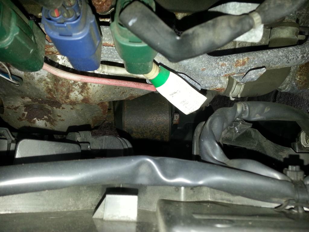

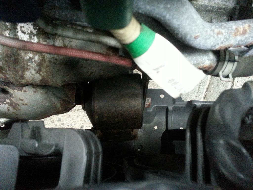

Happy Holidays djfrestyl. I was wondering if you have installed a few sets of the torque mounts and if so, have you noticed any differences in quality between OEM and ebay mounts.
Long story: my OEM mounts wore out so I swapped them out with ebay mounts that lasted a year before failing. I had the mechanic use the ebay brackets to install the ES torque bushing and still think the drivetrain has more play than the 1st day the ebay mounts were installed (before they broke in).
I look down at the ES front mount and I swear that it looks like it is loose/twisted in the mount. I'm seriously considering going back to OEM mounts and pulling out the ES/ebay ones.
The pics don't show it, but the ES bushing appears more twisted in the bracket.

Yes, there absolutely is a difference in quality between eBay and OEM mounts - the bushings in the eBay mounts are much lower quality. But the metal itself should not matter.
If the ES mounts when in properly, there should be significantly less play than both OEM and eBay mounts. Coupled with a minor increase in general vibration felt through the car at idle.

Thanks. there is definitely some play. I reinstalled the NWP brace link and feel less play with that so I just think I may order some OEM's and get them installed.

Very very strange. Hard to diagnose anything further without looking at it myself.
Let me know what you find.
Since you're in NYC, if you want to venture out to Jersey for me to do the work, let me know.

@djfrestyl I checked the dust shield but it didn't appear to be the problem. Made a quick vid of the noise, ignore that loud chirp at the end, stupid belt tension I'm ignoring. The noise is louder when turing the wheel to the left versus the right. I'm guess it's the strut mounts.

Before we go further, need to know if anything has been changed, uninstalled, reinstalled, etc with regards to your strut.
If so, it sounds like the upper spring perch not correctly aligned. ("OUT" is not facing out) - this would have occurred only if anything has been recently changed.
If nothing has been changed, the perch should be aligned properly, then I'll bet its your strut bearing.
If you can, take a video during daytime, with the wheel off, but aimed inside and towards the underside of the strut tower, while you turn the wheel.
