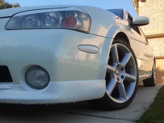

Old Oct 28, 2013 | 03:57 PM
  #814
nestorlugo's Avatar
Joined: May 2013
Posts: 1,584
Size:  109.6 KBLowered on a blown strut But it looks nice tho' One baby finger gap tire to fender.
