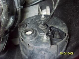

Papo, what I did on mine, take the fogs out, then drill a little hole where the adjuster screw sits on the bumper, then you can slide a 5/16 deep socket through and adjust them while tighten and mounted on the bumper....
I did the same thing about 9 yrs ago...........
