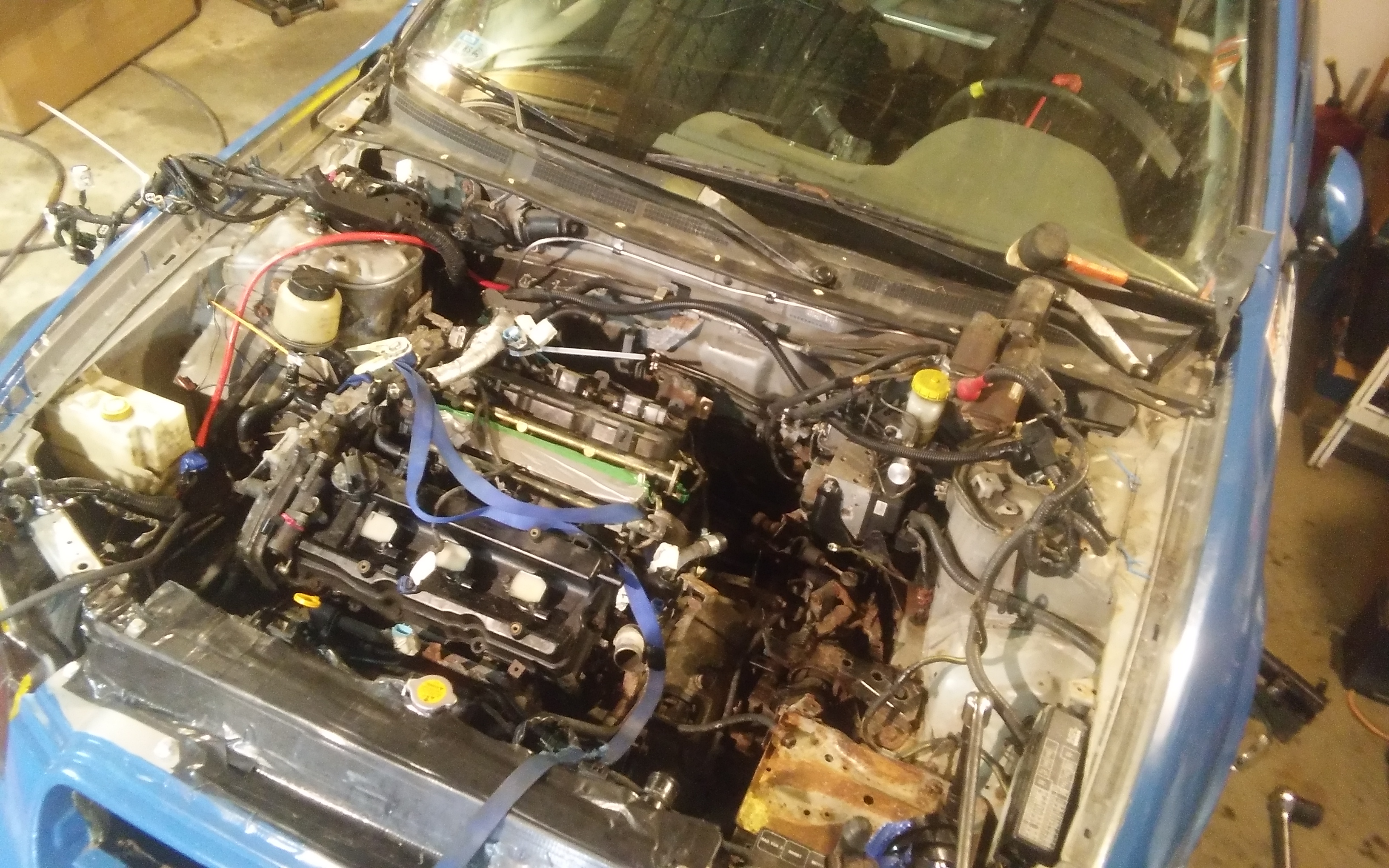

So we are planning on pulling the entire engine out with the transmission so we can freshen up the motor. So the tranny will be out soon and I wanted to find out if anyone has links or suggestions on rebuilding this 6 speed.

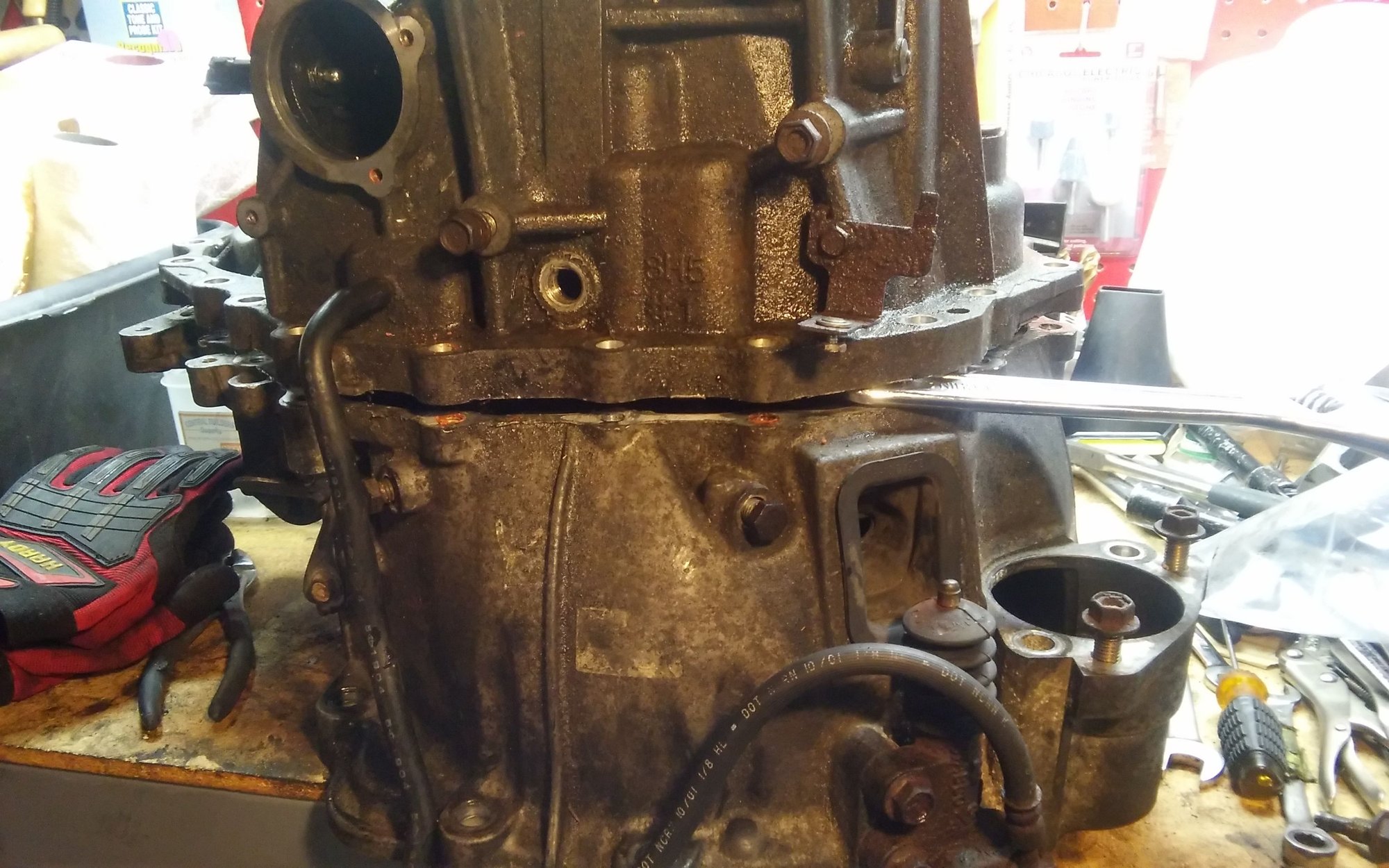

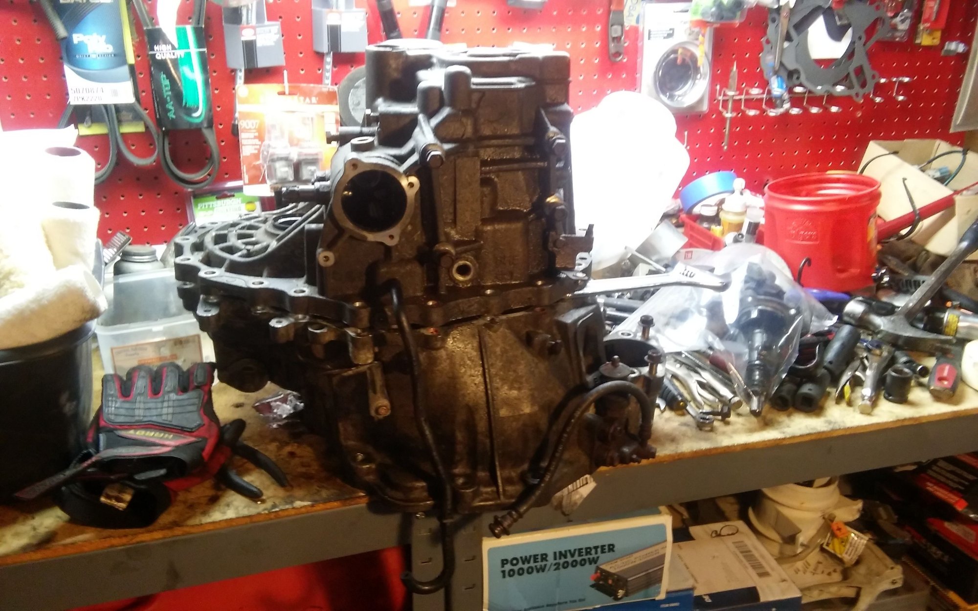

Thanks guys for the awesome replies! And the link to that other post was very helpful. We have the trans on the bench but we can't remove the bell housing. It feels like we are stuck on something, suggestions?

Mike, if you haven't done so already, download the FSM for a 2k2-2k3.
http://www.nicoclub.com/FSM/Maxima/2002/MT.pdf
Read through the MT.pdf. You have to remove a LARGE c-clip on the transaxel side BEFORE separating the cases. The end of the Main Shaft is locked in by the c-clip.

Ok, our gears look great. Our synchros are a bit beat up and the 3rd gear wire retainer was busted off and stuck to the internal magnet. Can anyone recommend links to purchase a synchros kit, that hopefully comes with that clip retainer.
