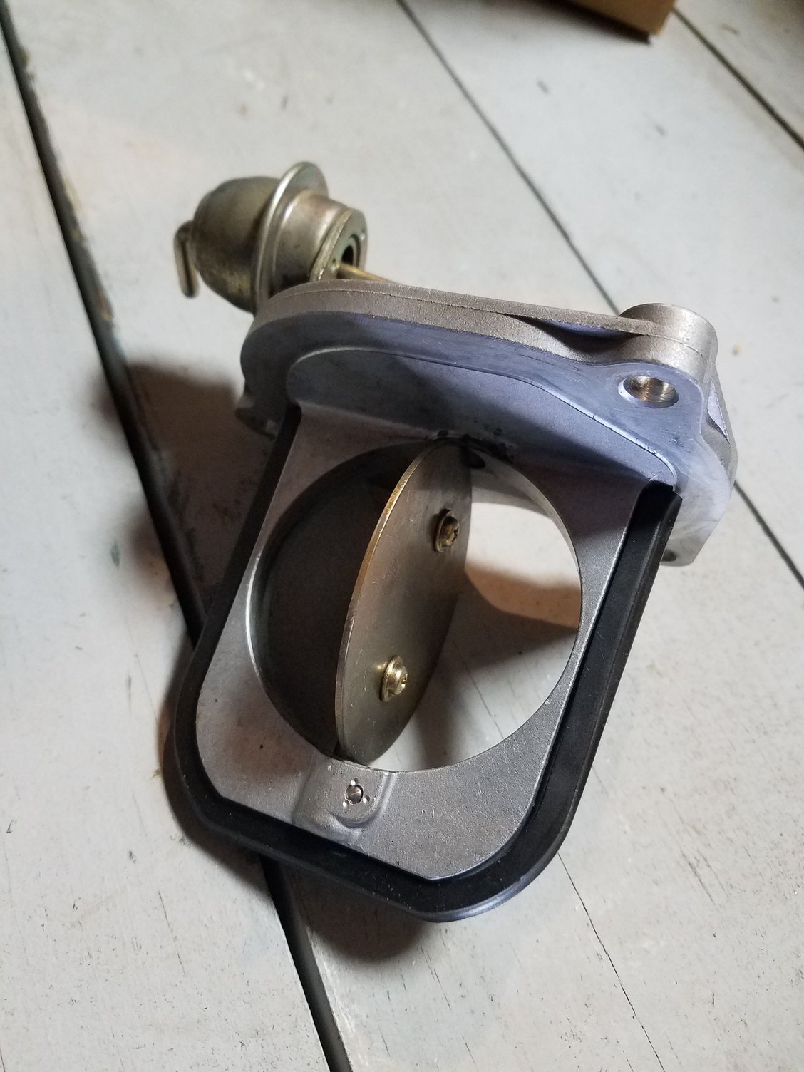

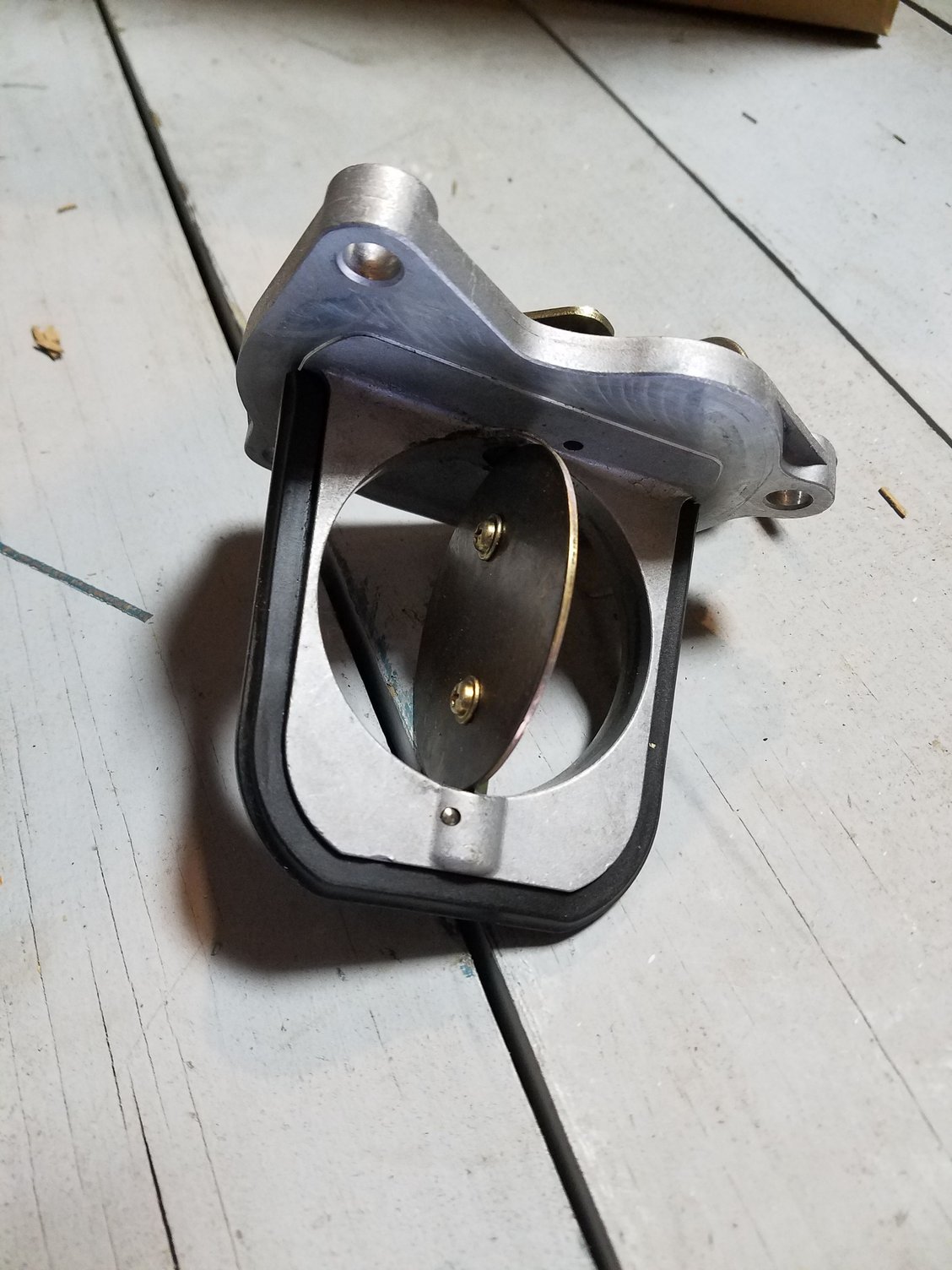

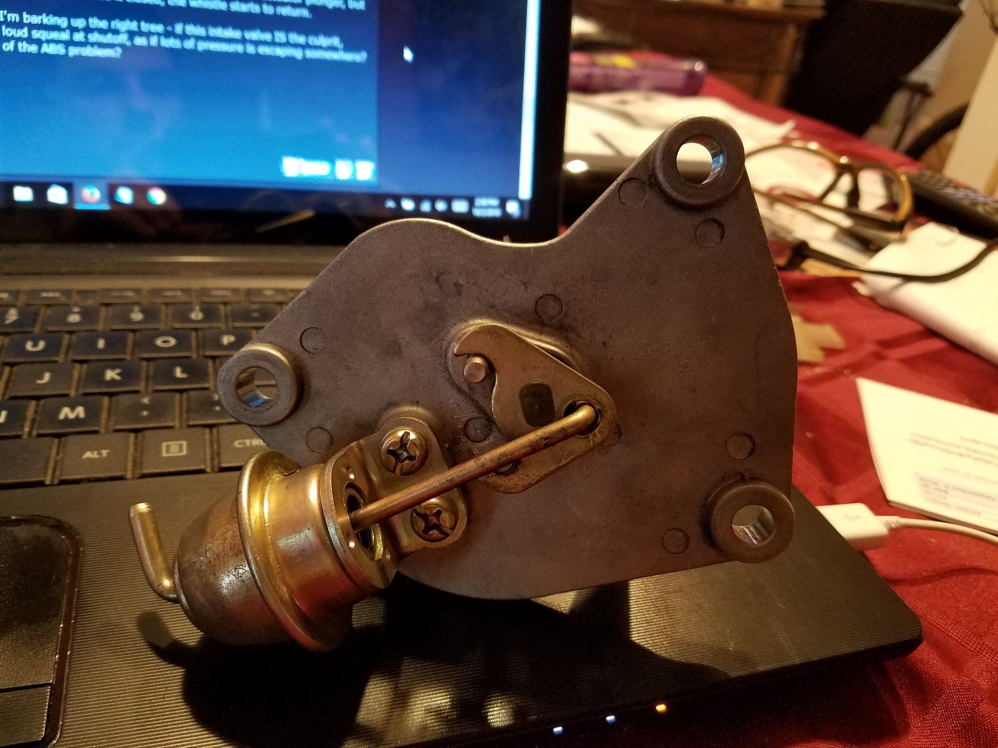

I don't think it's from the valve inside the intake. Here's a pic of the other side of the VIAS. These are of one I took off my car a few years ago. The shaft on the valve has a small amount of play in and out (less that 1 mm) and no side to side. There is a seal on the shaft but it won't leak after shut down since there's no vacuum.
You could have a leak inside the metal vacuum canister/actuator. The big plastic canister stores vacuum for the actuator. If the actuator has a leak in will bleed off the vacuum stored in the plastic canister even though the actual manifold vacuum goes away as the motor is shut down.
Try removing the line going from the intake to the plastic canister and capping it off. See if this gets rid of the squeal after shut down.
I don't think this has to do with the ABS problem though. If you're not getting any codes it could be the ABS computer itself. This is exactly what happened to mine. Light came on and ABS quit working but no codes. The owner of the shop I work at said it was the computer if there were no codes but I wasn't sure. Sure enough, swapped in a used computer ($200) and it came right back online. I don't remember any rumbling though.
