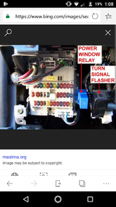

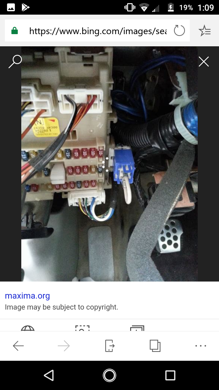

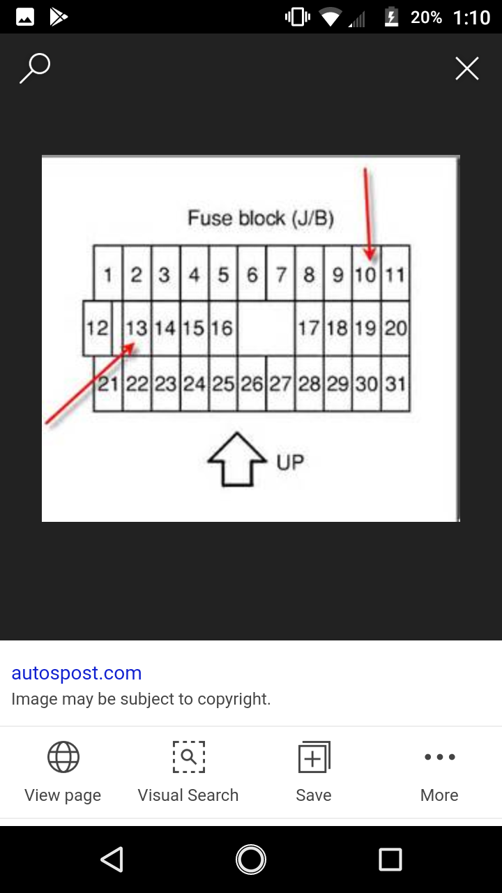

Check these 2 fuses, check this relay, if you don't know how, don't have a relay to replace it make a jumper wire like this, and jump the white red wire to the whit blue wire only those 2 just like in the picture. Leave the top 2 should be purple and black alone. Your windows should work now. Know this that jumper is perfectly safe and won't cause you any harm. However as long as the batter is connected the windows will go up and down any time any switch is pressed. It won't drain the battery and will be fine until you get a relay. Just know that those switches work if the car is off, locked, and alarmed even. If the jumper doesn't work you're either out the 40amp fuse able link under the hood(not likely) or the master switch is bad (drivers door switches actually controls all other door window switches) (most likely if jumper doesn't work) . If only one e window doesn't work it's that switch (also not likely) (you didn't give me much info so I gave you all I could)

Forgot to add the pics I do that all the time.
Attached Thumbnails Power windows dont work-screenshot_20180322-011010.png   Power windows dont work-screenshot_20180322-010901.png   Power windows dont work-screenshot_20180322-010854.png
