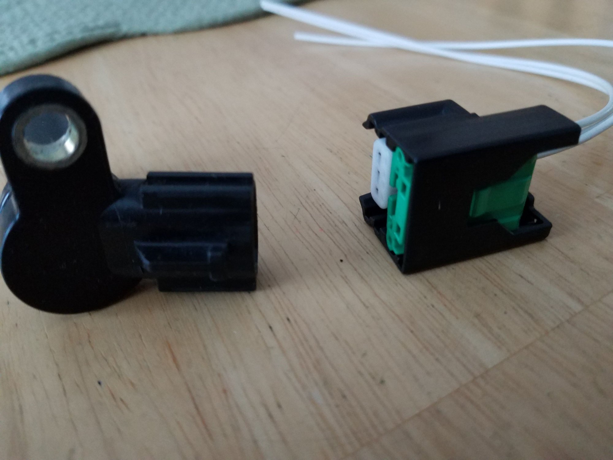

I just went through that problem and it was the front camshaft sensor connector. I replaced the connector and sensor. Start real fast now. I have not replaced the one crank sensor yet and probably won't unless it gives me some trouble

anyone tried aftermarket or dorman? Also what does one do for worn out pigtails on the harness, how does one replace that? extract the pins and to uncrimp and recrimp on to new wires using the old plastic casing of the connector (that sounds janky as hell)? you can buy cam pigtails but, not crank.

I replaced both connectors for $20. They were not OEM but they work just fine. I used OEM camshaft sensors
