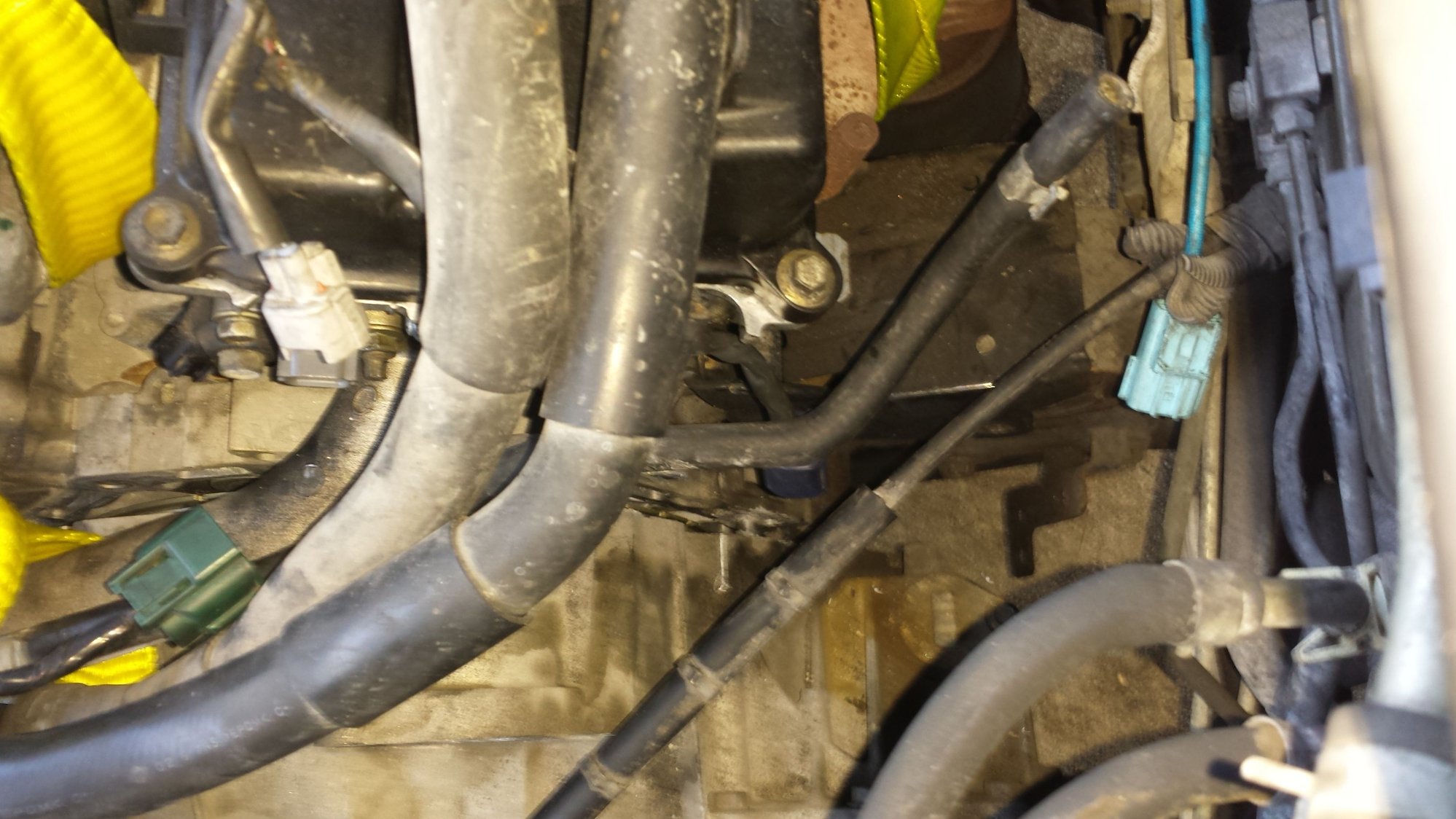

I'm flying solo with the labor in this swap because I don't know anyone that can help. I have the engine attached to the hoist and ready to pull. I have the engine and tranny separated approximately one half inch all the way around the bell housing (see pics, sorry they suck). When I begin to lift, I just can't seem to separate the two enough to release the engine. I am pulling the engine and tranny separately and out the top, but I will be installing both as a single unit. I'm at a loss at this point and have quit for the day. Am I missing something? How far apart do the two need to be in order for the engine to rise? Any advice would be greatly appreciated. And I'd like to extend a special thank you to all whom have helped me thus far!

Leave the mount on the pass side and lower driver's all the way down and slide off the tranny (remove crossmember). You're fighting the input shaft and weight, plus there's not enough room.
Good luck dropping them in together. I could barely get them out in one piece and had to bend stuff. It's easy to just pull the tranny up and slide it back in. I've done this several times and a few times by myself.
Child, you have come through once again. I don't know how to thank you. I will try again tomorrow.
To clarify;
1) Remove tranny mount
2) Remove crossmember
3) Lower set and pull tranny away from engine
4) Lift engine
5) Lift tranny
6) Deal with installation later

I don't know why you didn't pull the transmission first? Take the axles out, take the stuff of around the transmission,take the bolts out of the transmission and drop the transmission. Don't take the engine out till then.put a cushion like a couch cousin or something similar if your alone . And just let it fall. use a jack to get it off the dowel pins.

Oh, yeah, forgot you're auto.I think you can leave the mount on the tranny as lowering it will make it all clear (fuzzy on auto details). If you have the car high enough, you should be able to slide it out.

Drop the tranmission, then pull the engine... you might wanna remove drivers LCA as well to make it easier removing the transmission.

Definitely possible to pull with the tranny attached, but its a project. I had to tilt the motor+trans all the way to the trans side (so trans was much lower) otherwise the bellhousing would get stuck on the chassis. You need to mess around with lowering and raising your hoist a bit, i also had a floorjack underneath to help with angling things where they had to go in conjuction with my hoist. Its all going back in tomorrow, going to attempt to get it back in with the tranny on but i know already that its gonna suck a big one getting the perfect angle. Worst case scenario i just zip the trans off again and put it in from the bottom.
