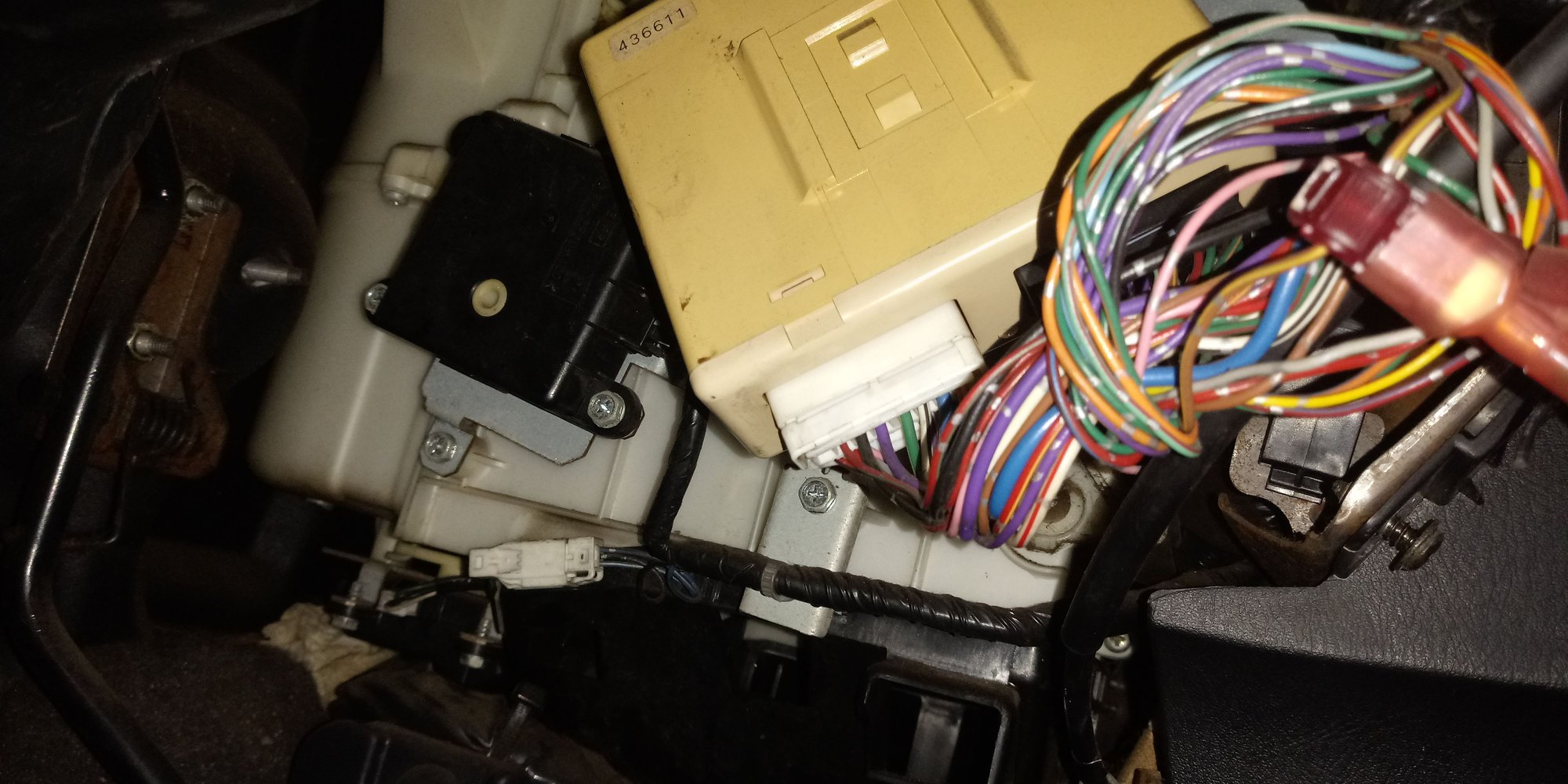

What about the SECU located under right side of steering wheel. When I push my lock button I hear a click and that's where it comes from. All fuses are good. Under dash and in engine compartment. I'm just learning all this so I'm open minded for any ideas.

Thanks Dennismik I will be checking that out tomorrow. I know that i hear a slight clicking noise when I push the lock button and the sound is coming from under the dash. Is that the SECU? Under steering wheel close to the radio? I will attach a picture of it.
Is this the secu? The clicking sound is coming from this.

Locks make clicking noise and comes from this.

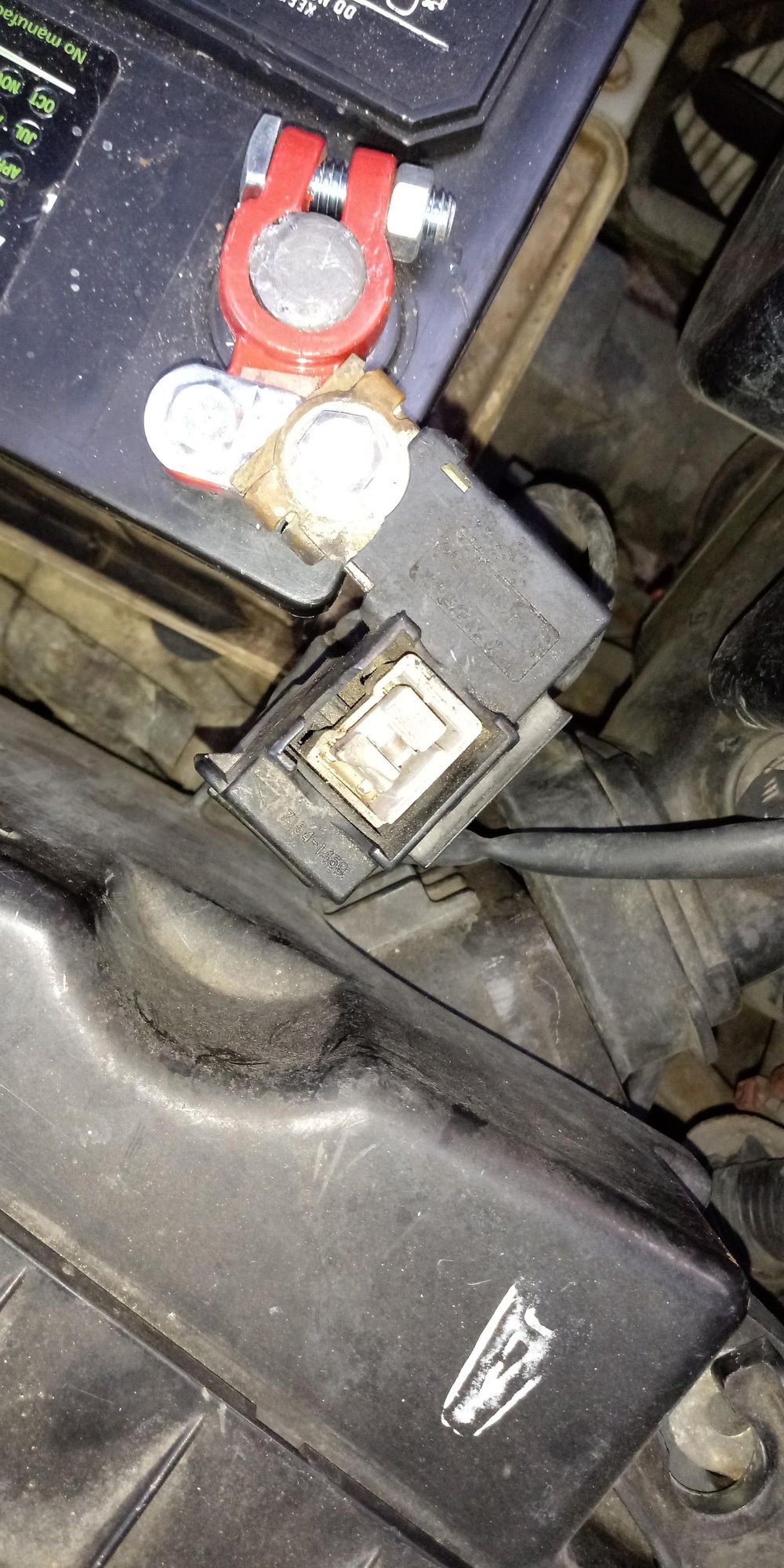

Battery terminal fuse I changed it but didn't disconnect the battery. Was that pointless? Should I start over and disconnect the battery and change it again

No that's not what he means . He means the fusible link boxes under the hood . They have black covers with white ink on them.
