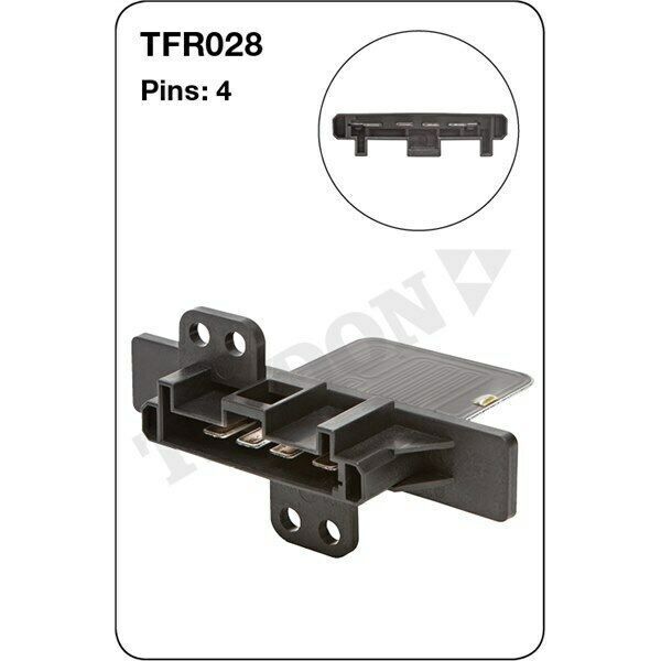

have you checked the heater resistor, this is located close to the blower motor in the heater assembly. it is held in with 2 screws, easy way to check if the resistor is stuffed is it will only blow hot air of full fan speed. the common issue with the blower(heater) resistor is it burns the electrical track and depending on how much has burnt away you may be able to solder the track together again. i did this with my A33 where i soldered it on the resistor it sort of resembles a fusible link. as to the lights not working on the switches it could be a loose plug, if you hit the sides of the heater switch and lights either flicker or come back on it could potentially be a loose connection.

above is what the blower resistor looks like.
