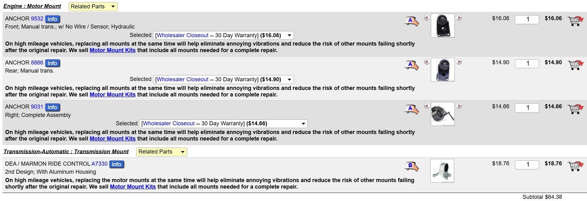

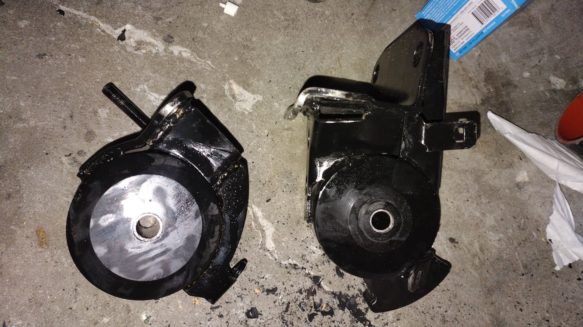

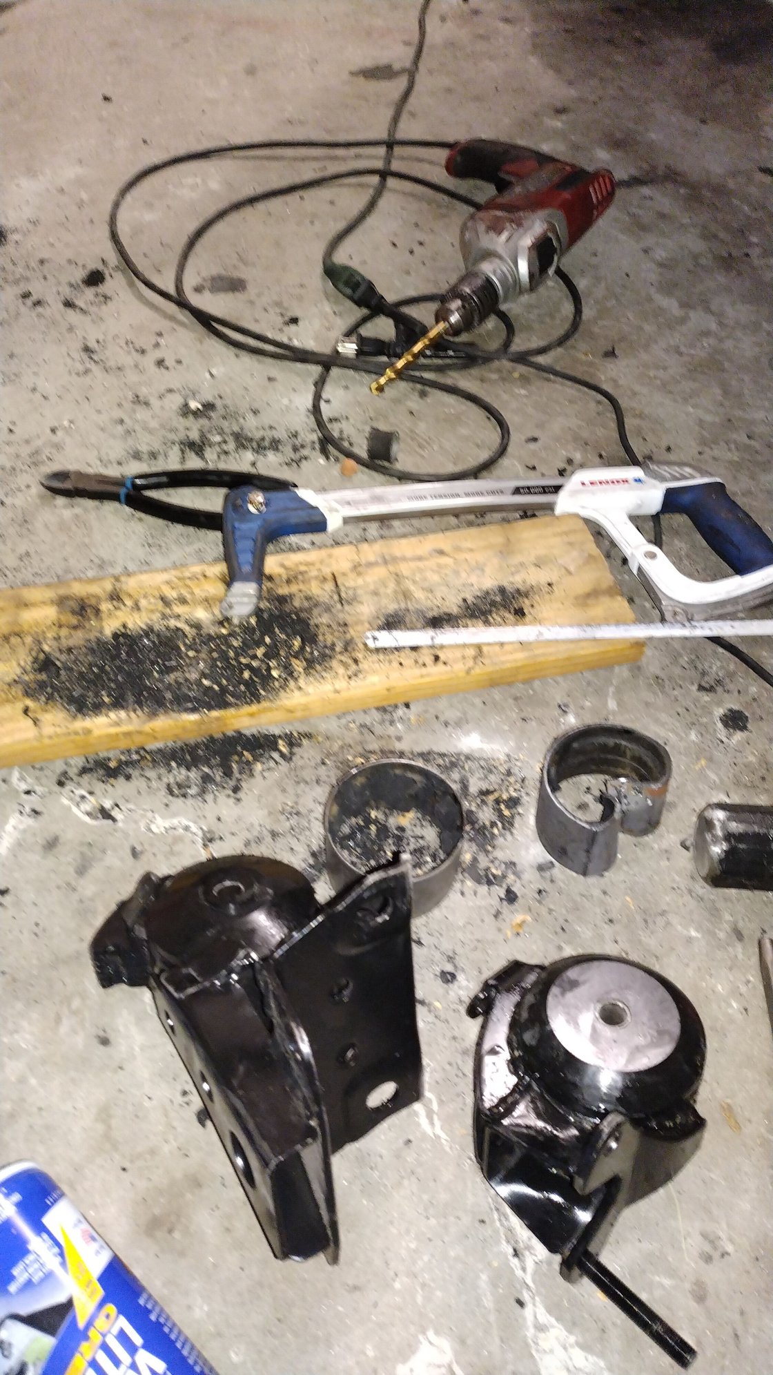

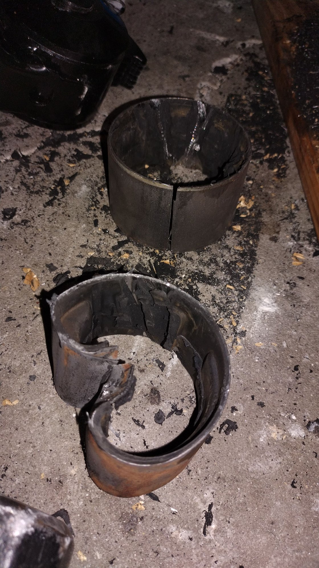

when it comes to mounts you want to change all of them at once. most likely the uppers are worn and will reduce the life of the lowers if you change them.
Nisformance sells mount inserts that aren't too stiff and they're the only ones that has bushings for the upper mounts. since you have an auto you can only get the lowers and the upper on the passenger side from them. as for the upper driver side get a regular replacement.
you can get the lower mounts for the manual transmission for a really good price on Rockauto. the Anchor mounts are a good fit.
to remove the old bushings I drilled the rubber and cut the sleaves.
