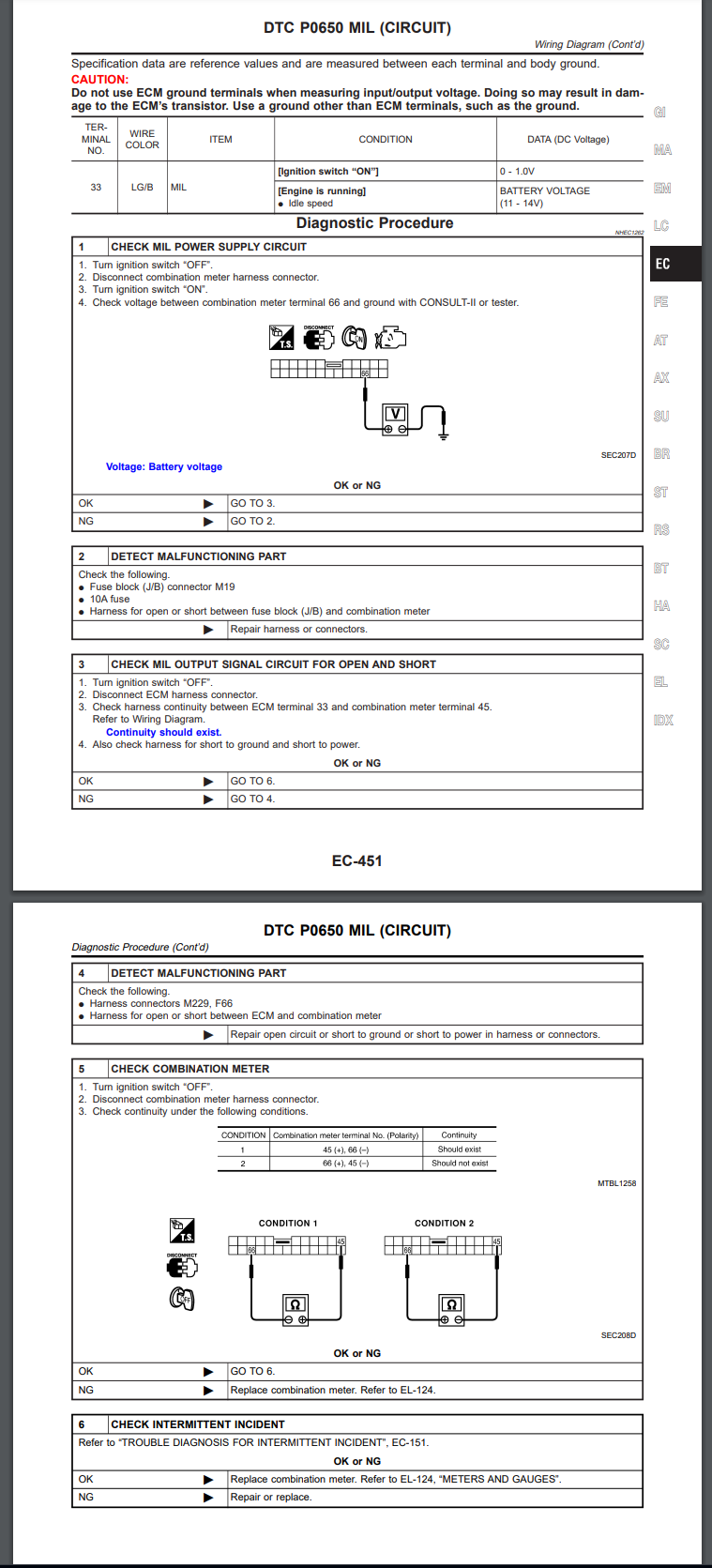

This is for an I35, so the manual is slightly different. I attached those pages below for reference.

Following the manual, I tested for spec voltage hitting pin 66 on the gauge cluster connector. .5V in OFF and 13V+ when running. CHECK
Proceed to 3: Probe pin 45 on gauge connector and 33 on ECM. There is continuity, but resistance is something like 120,000 ohms CHECK, GO TO 6, intermittent issue
Checked all the grounds I could see and everything looks fine. No broken/damaged wires by the timing chain cover ground point. I am no expert digging deeper into this, so ¯\_(ツ)_/¯
So I go back to step 5 and I run into this when testing:

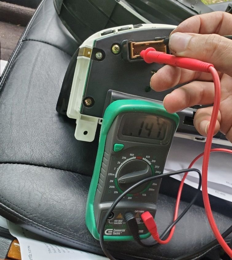

I am supposed to check continuity on 45 and 66 of the gauge cluster. See below pictures for the result:
probing 45 positive 800,000 ohms
probing 66 positive 140,000 ohms
closeup of gauge cluster test says 66 probed positive is supposed to not be conductive
full manual section for I35
The I35 manual has this extra step for testing the gauge cluster. This section 5 is not present for the 02-03 Maxima.
Anyways, does this reading tell me that the gauge cluster is the cause of the problem? It says that 66 probed positive should not have continuity.
