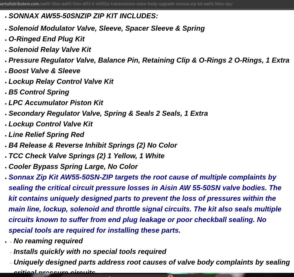

okay sonnax sells and entire VB rehab kit among many other parts.
as far as VBs go where or what brands of VBs are you getting? surely in 2024 you aren't getting nissan oem for $800?
Sonnax used to sel la VB
so two shift kits sonnax and trans go. sonnax is reamerless, no reaming required. sonnax has parts in theres that the trans go does not, from what i'm seeing. the only reamers in the trans go kits is to clean junk out of the solenoids before readjusting them.
i'm almost wondering about combing the kits.
