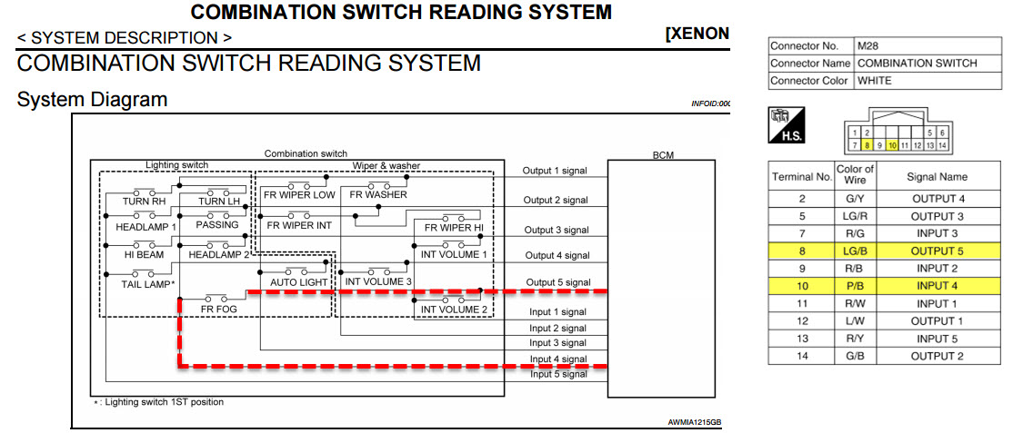

7th gen fogs
I'm installing fog lights on 2012 SV. Car is prewired for easy hook up.
I'm not using factory multifunction switch upgrade. I will tap into column wires with remote switch. Forum posts have been very helpful on install, except for the 2 wires to tap. I got a copy of the fog schematic. Hope this helps others.
Attached Thumbnails Help!  I'm new here and have a question....-fogs_maxima.jpg
