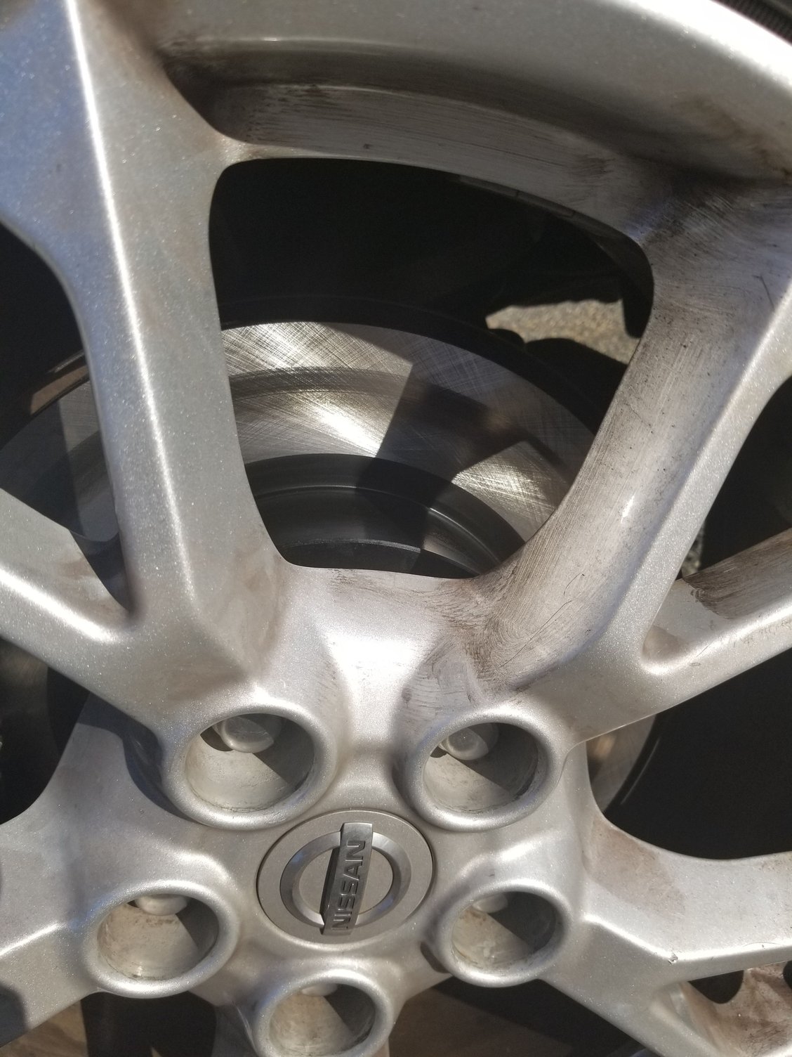

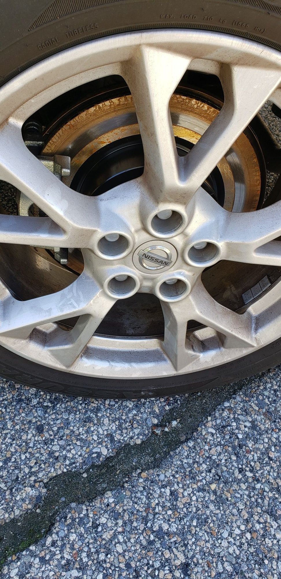

Hi guys, I'm completely at odds as to what's going on, 3 weeks ago I replace the rear brakes on my wife's 2012 Maxima and noticed after about a week the left rear rotor had uneven wear on the surface and a rust ring midway from the top. So I replaced the caliper and rotor as well as the the brake hose and behold a week later same issue. So today I replaced the caliper under warranty and rotor and again after doing the brake embedding procedure I see this is going to happen again. Does anyone have any idea as to what could be possibly going on??

Here is how it looks like today after caliper and rotor replacement. It looks to be happening again.

Your caliper bracket is misaligned. Check that your mounting contact surfaces are mated properly (square). Have someone stomp on the brakes while you inspect. Depress brakes, inspect, release brakes, spin rotor, inspect mounting points, etc. Use a flashlight, even if it's daylight, shine from behind and at different angles in attempt to see light where there shouldn't be any. You're looking for the reason the aft-half of the pad is all that is making contact with the rotor. Your reassembly procedure is the culprit. Easy fix though, you just have to find it. You did it right on the other side

Forgot to add: Check for binding on the guide pins. Smooth action is the game here.

I do truly hate to admit this, but i did but put my pads on backward with similar wear patterns . But it also looks as if if the pads arent the correct size. Do let us know what you find.

Hi guys, I spent most of the day yesterday trying to figure this out, removing the pads reinstalling etc. After many attempts it boiled down to improper alignment due to the wrong series pads being mixed in the box. I pretty much had one pad that wasn't to spec with the rest and causing that improper embedding. Thank you user1 for your input if you had not suggested I go back and re check multiple things I wouldn't of figured this out. LT Thank you as well and as always guys I appreciate the help!
