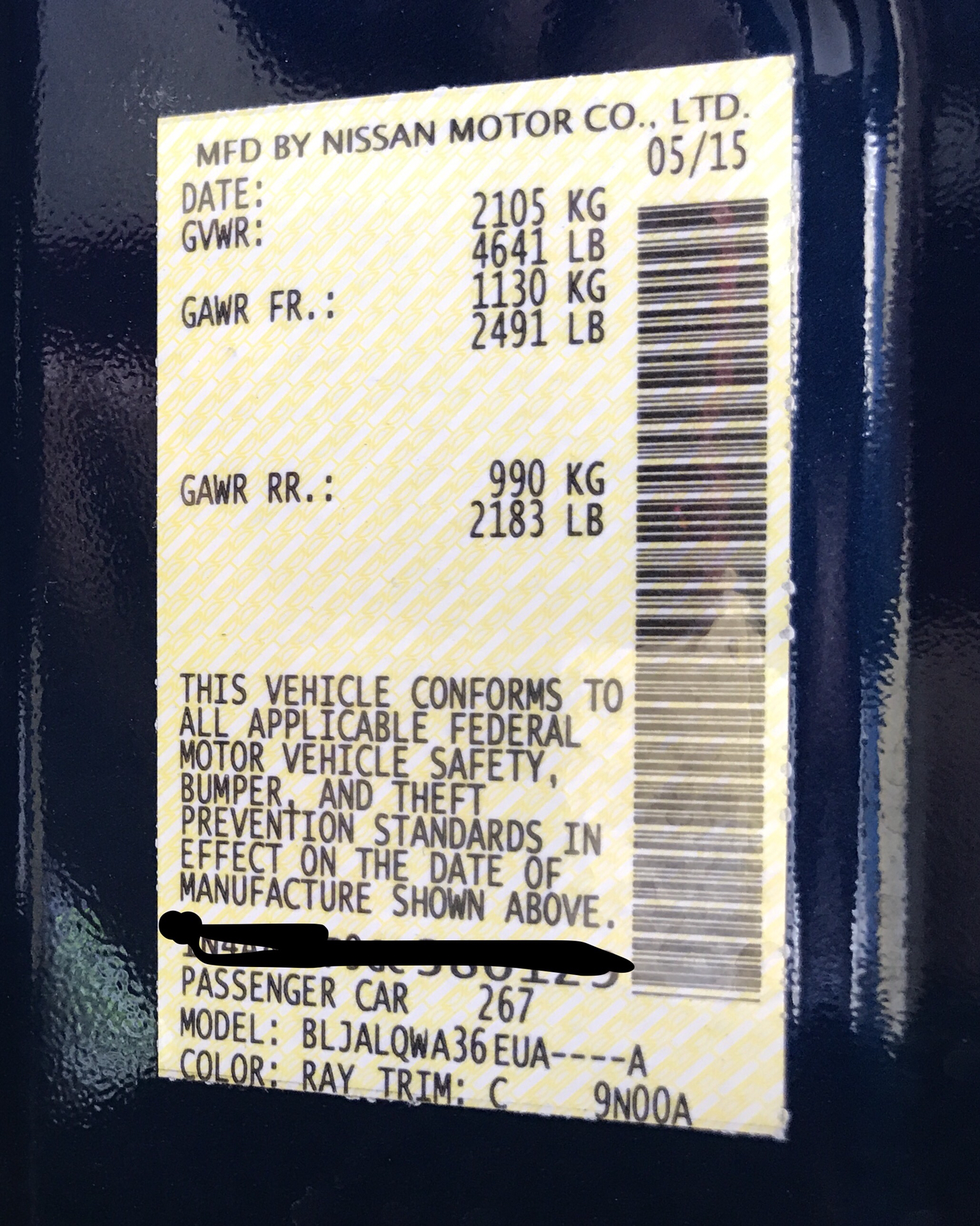

I hate to be that guy......but you're probably going to have to prove you actually have a 2016 model just so we are all 100% convinced this will work.

1. I didn't have to change any connectors at all. I simple unhooked the 2016 radio, and put in the 17 radio.
No worries I can take a picture of my tag on the door pillar. Have no reason to lie! 😂. Just a guy who bought a 16 for a good deal that wanted apple play!
Info about My Car:
2016 S Trim/Without Bose System
Car manufactured in 5/2015
