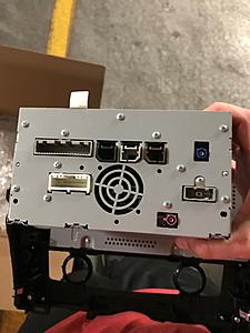

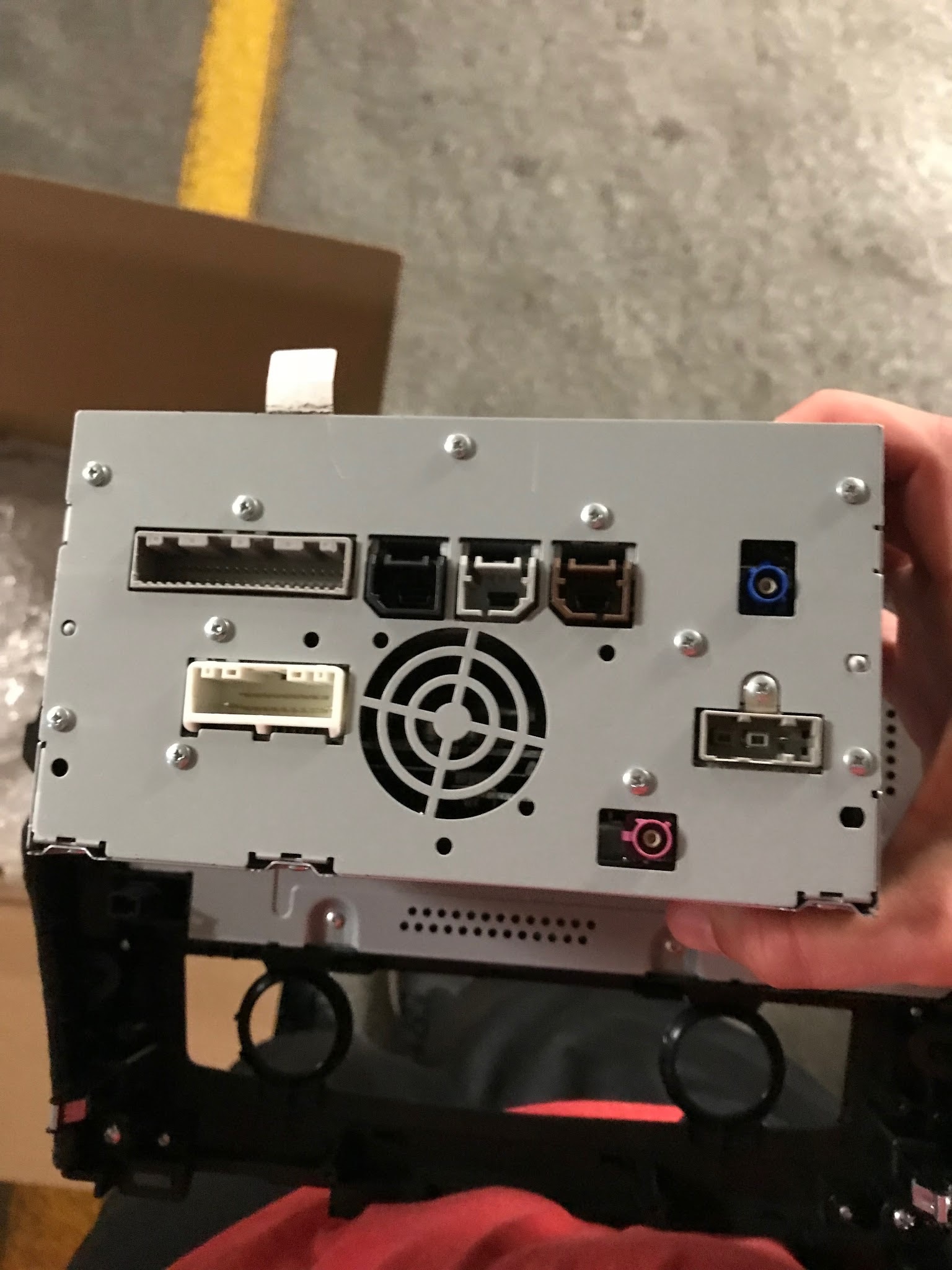

Visual Reference of the back of what Bose units:
And visual reference of Non Bose Units:
Everything else about the units is identical as you can see. The plugs between '16 and '17 models are identical - apart from that 3rd plug/port which appears to be tied to the Bose system some how.

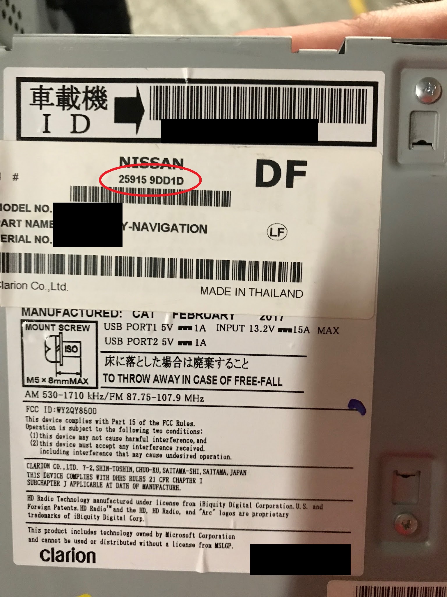

IT WORKED! And was so incredibly easy. Even taking the dash apart is really straight forward.
For those of you attempting, reference this for how to remove the existing unit:
http://www.metraonline.com/files/pro...9-7630_web.pdf
And then once thats all removed, it's literally just unplug and then plug back into the new unit. And put it all back in place. The unit I picked up even still has its XM subscription (and the previous owners address stored as "home" - ha!).
Note: I circled the part number in the first image for reference. What I detailed above is correct. Bose units with carplay are delineated using "9DD1[insert A, B, C, D, etc]". Non Bose units are delineated using "9DD0[insert A, B, C, D, etc]". The "1" distinguishes a Bose unit vs a "0" for a non Bose.
Oh. And can also confirm the third plug outlined in my images here and in my post above is not used on my SR. I'm wondering if it has something to do with the 4G connection option - or potentially something for Platinum models. No matter - its not used/needed in an SR. And I can't imagine its used in an SL either.
Anyway - here's some pics:

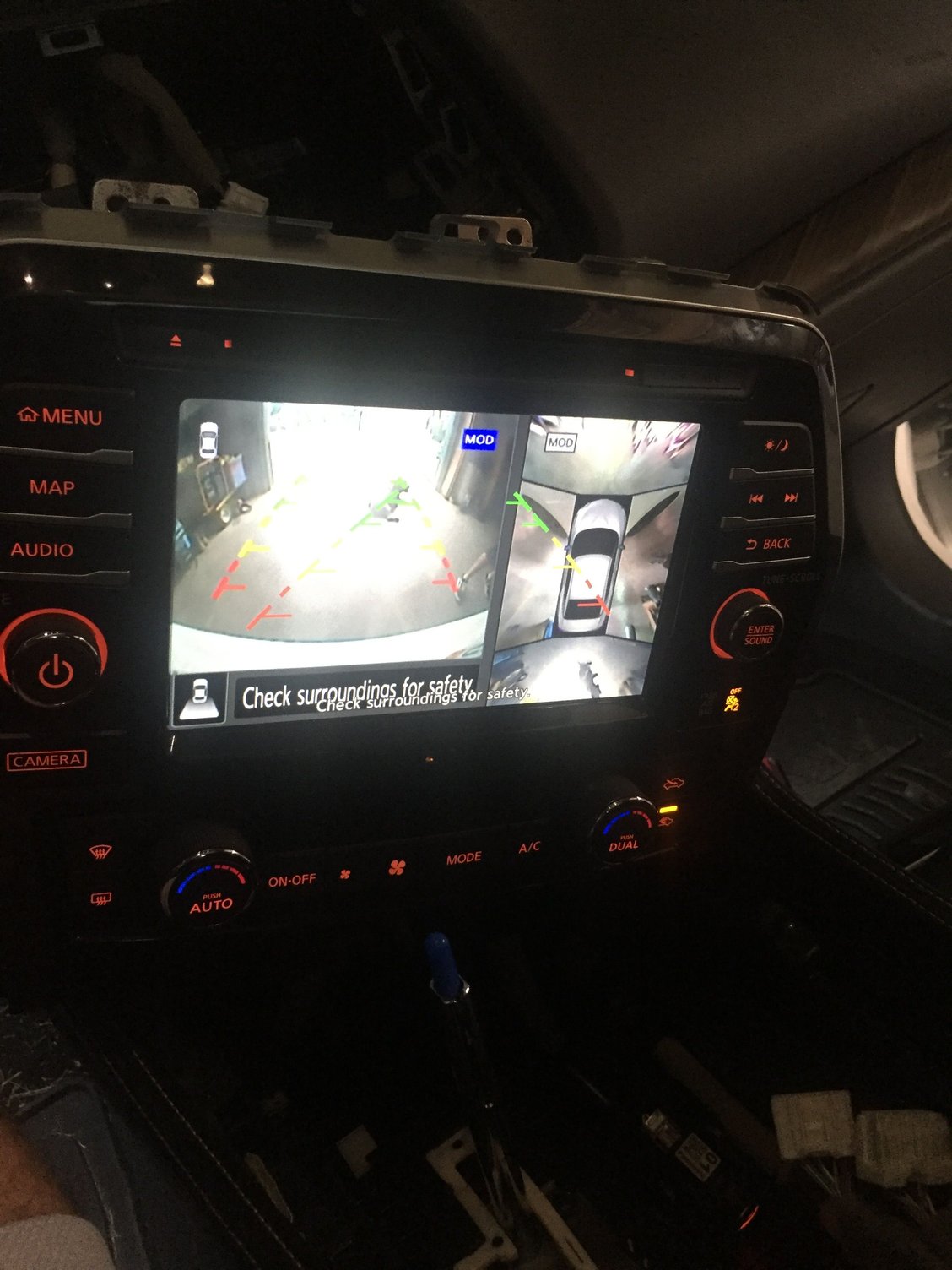

Okay so im running into an issue. I have the platinum, so it has surround view. The unit is behaving as if I have an SR or SL. The part number fits each unit 25915-9DD1A, so what gives? Anyone have any ideas or have run into this?

I am betting you have to go into the hidden settings menu and tell it that it has 4 camera surround.
The following video will get you in that hidden settings menu. You will see the camera selection at about 2:35 in the video.

That did the trick! It has a selection of no camera, rear camera, and AVM. Just had to change the settings and it was that simple. That was my only issue with the install, otherwise would have taken 30 minutes and is super easy. So platinum owners, just make sure to adjust that settings which is apparently super easy. Thanks so much for the help man I was reviewing every resource possible and hitting all dead ends. I was so stressed and you saved me big time!

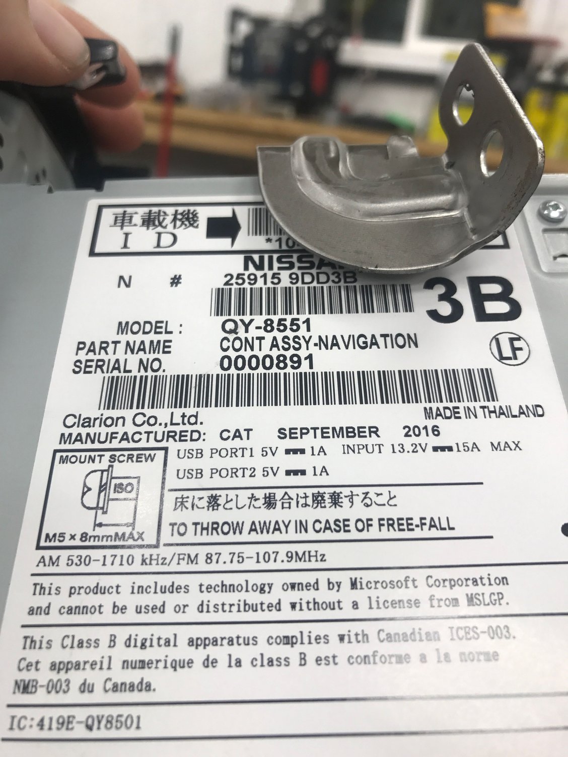

Hey guys, I purchased a 25915-9DD3B from eBay to put into my 2016 SR and it worked perfectly! Bought it with the most current maps for $341 shipped!
I assume your SR has the Bose system, correct? Also, what did you search for on eBay to find it?
