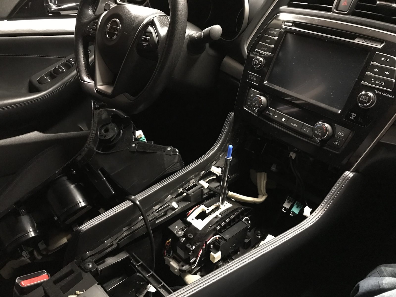

I just completed my installation of the DD0E version that i got off car-parts.com for $275 shipped! All i did was look up the "navigation system" and start calling people until someone read off the part number i needed. Mine came all the way from New York to San Diego!
First impressions? CarPlay is slick as hell but the way it integrates into the regular system is clunky as hell. Particularly flipping between FM and CarPlay is frustrating.
Anyways here are my instructions! It took about 1 hour to do going quite slowly and double checking my work agains't the shop manual. I not new to cars or car electronics so maybe it might take a novice a bit longer. If you don't want to read it here check out the Imgur album: https://imgur.com/a/xjEItJj
First off get the following tools to help you on your quest. The two most important tools are the plastic pry tool and the start driver.

Start by removing the shifter by pushing the boot down and removing the retaining clip on the handle. Slide the handle up and then remove the boot. Then gently pry up the console. Once loose then remove all the connectors and set aside. As a note i wasn't able to remove all the wires but i did get enough off to manage to swing it into the drivers seat. Once the console is put to the side remove the two screws holding the radio in that are under the air control.

Next slowly start prying up the upper air vents using the plastic tool. The vents are probably the hardest thing to remove and takes a lot of work with the plastic tool. Start by sticking the plastic shim between the soft dash material and the outter edge.

Remove the vent and set aside. Then remove the screws from the top of the unit and gently pry the unit straight outward from the dash. Work slowly and don't pull too hard.

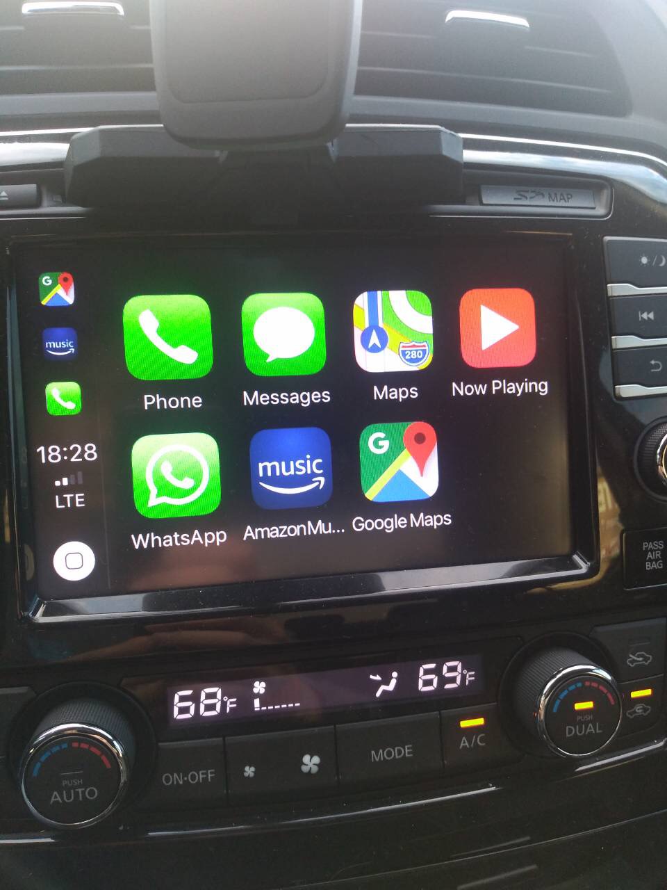

Google maps works on CarPlay
Here is the deck i purchased
Disconnect all the cables and gently remove the clip holding one of the wires in place.
Be sure not to rip your hands up! That **** is sharp.
With the unit removed you are in the home stretch. Here are the two units side by side.
Interesting to note that the units are damn near identical. I would say that they have to have nearly the exact same hardware on the inside.
Here's the decal on the older unit:
When done gawking at how retarded this is that it isn't just a firmware update unscrew the AC controls and then use the pry tool to release the two clips holding it in place. Then use the star tool to remove the white box of unknown mysteries and transfer them over to the new head unit.
Then just re-install!
Success, CarPlay!
