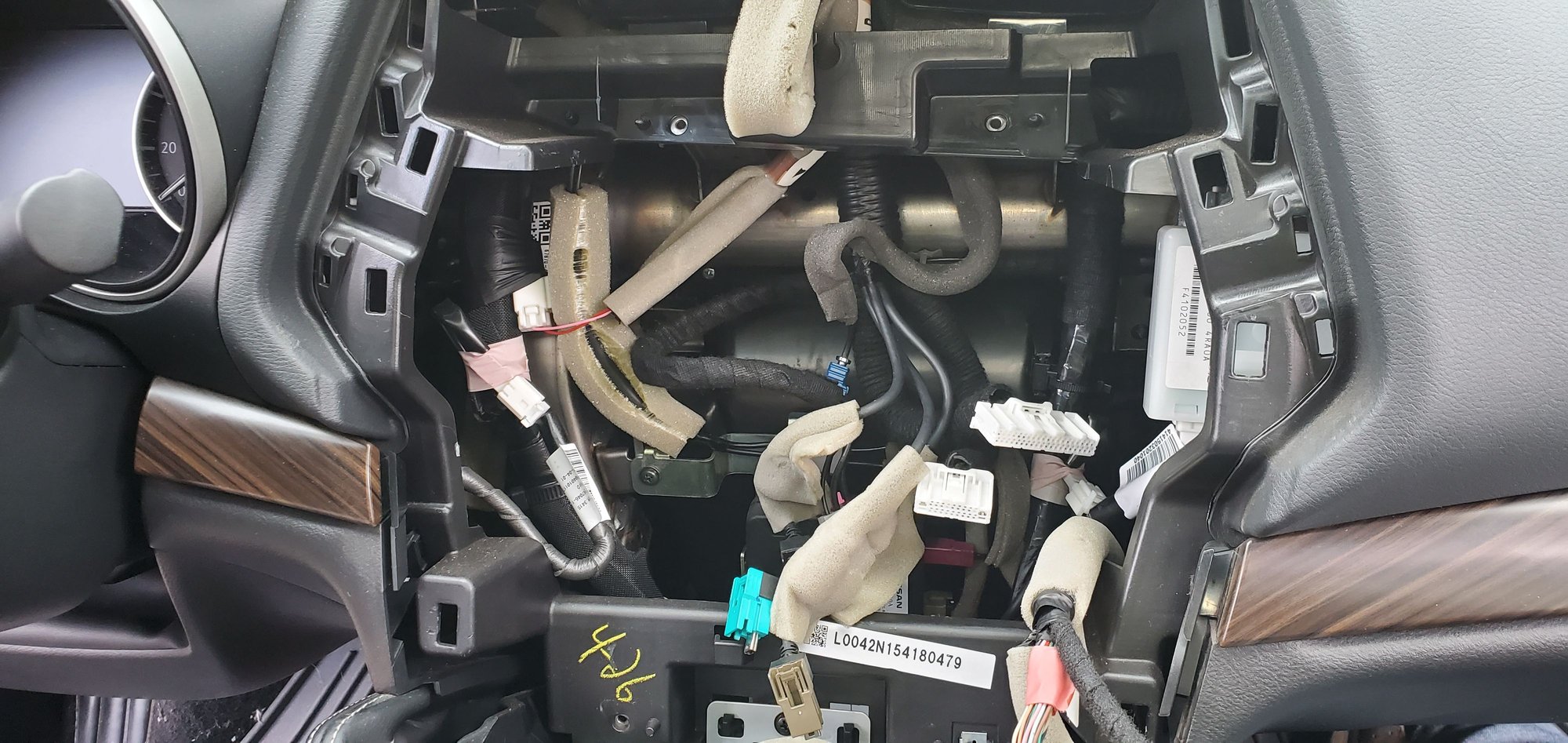

Make sure you check your harness connections
Bought a ‘17 unit
got the entire unit out and reinstalled and the connection clip was broken
all for nothing
now have to find another unit
have them take picture of the connections on back
i will now
kevin
