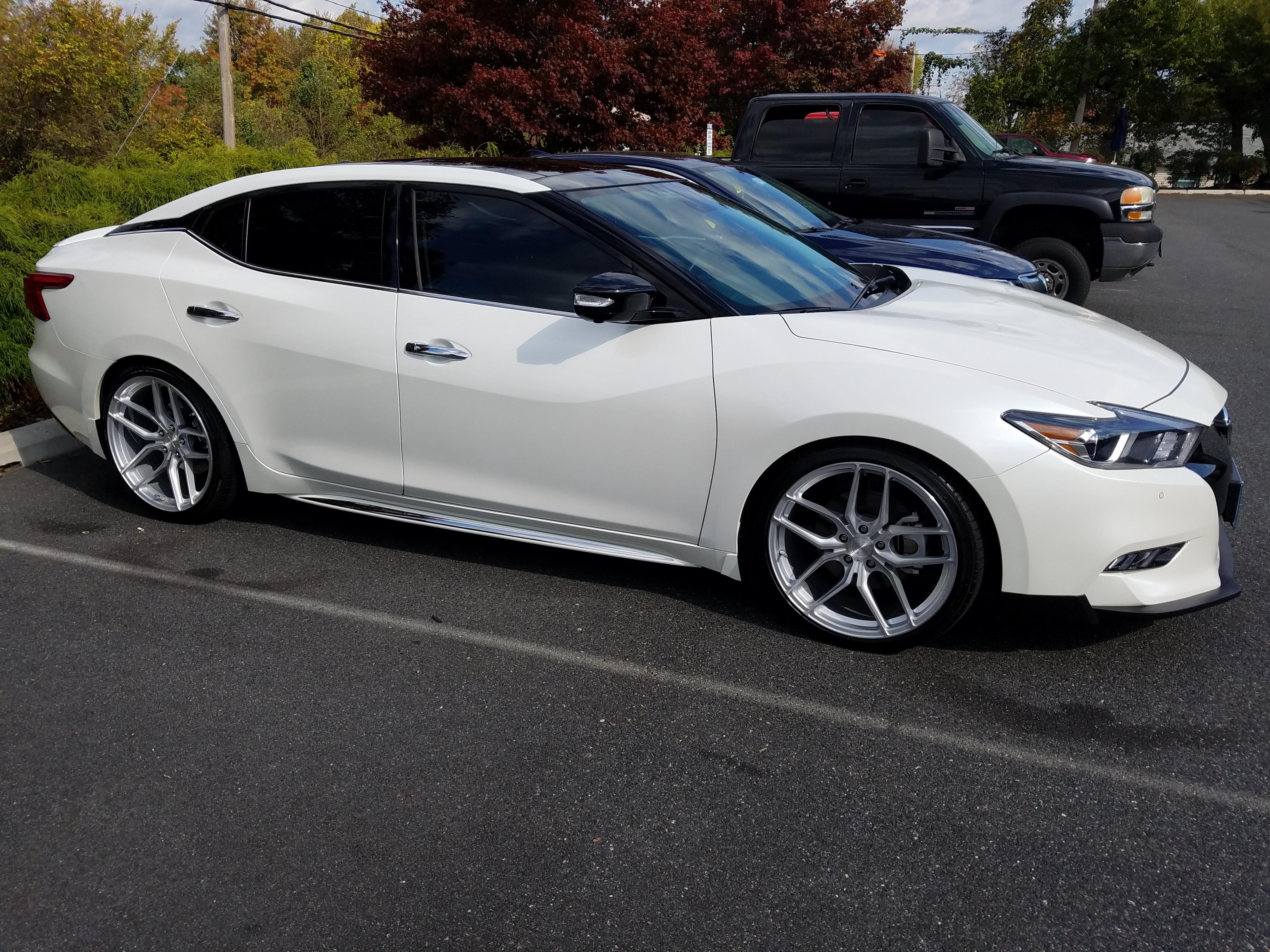

I finally pulled the trigger and got a new set of wheels. I got a set of Spec- 1 spm 78 staggered 20x10.5 rear and 20x9 front. The front is ol. It's the back that's too wide. I was planning on lowering the car but it rubs on the rear. Is there any thing can be done with the rubbing issue?

You might just need to roll your rear fenders. What offset are you running? +35, +45, etc.

in all honesty, I really dont know what the offset was. I left it up to the shop and failed, lol. I might just hae to invest on a fender roller and roll it out.
its almost 3/4" out

You definitely don't need to roll your fenders that's not enough to warrant that. Based on your pic you negative camber is the way to go.

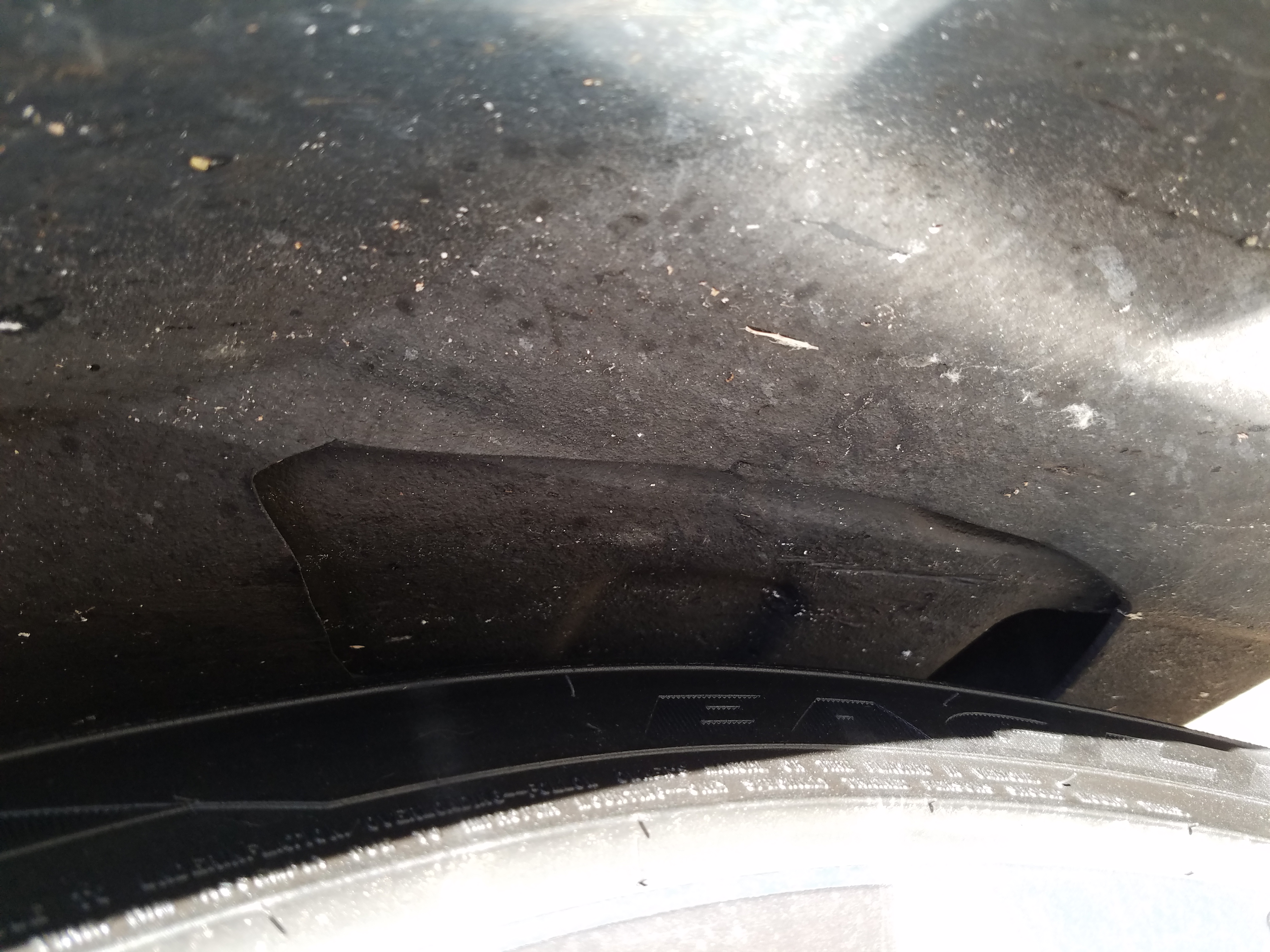

I was told that I could just sand down the plastic cover that is rubbing. Any other suggestions?

I had same issues with mine with 20x9 on fronts. there isn't enough room for the liner to be pushed back with heat gun because there is a secondary metal brace behind the fender liner. I ended up cutting the liner where it rubbed and then banging the metal brace in a little, spraying undercoating over brace.

The retailer is sending me me 4 245/35/20 tires to swap out. He said it should take care of the rubbing. Do you think it will work? And can you send me pictures on how the wheel well looks after you cut it?

Here's some of the of inner liner. I also downsized to 245/35/20 and it still rubbed until I ended up trimming.
