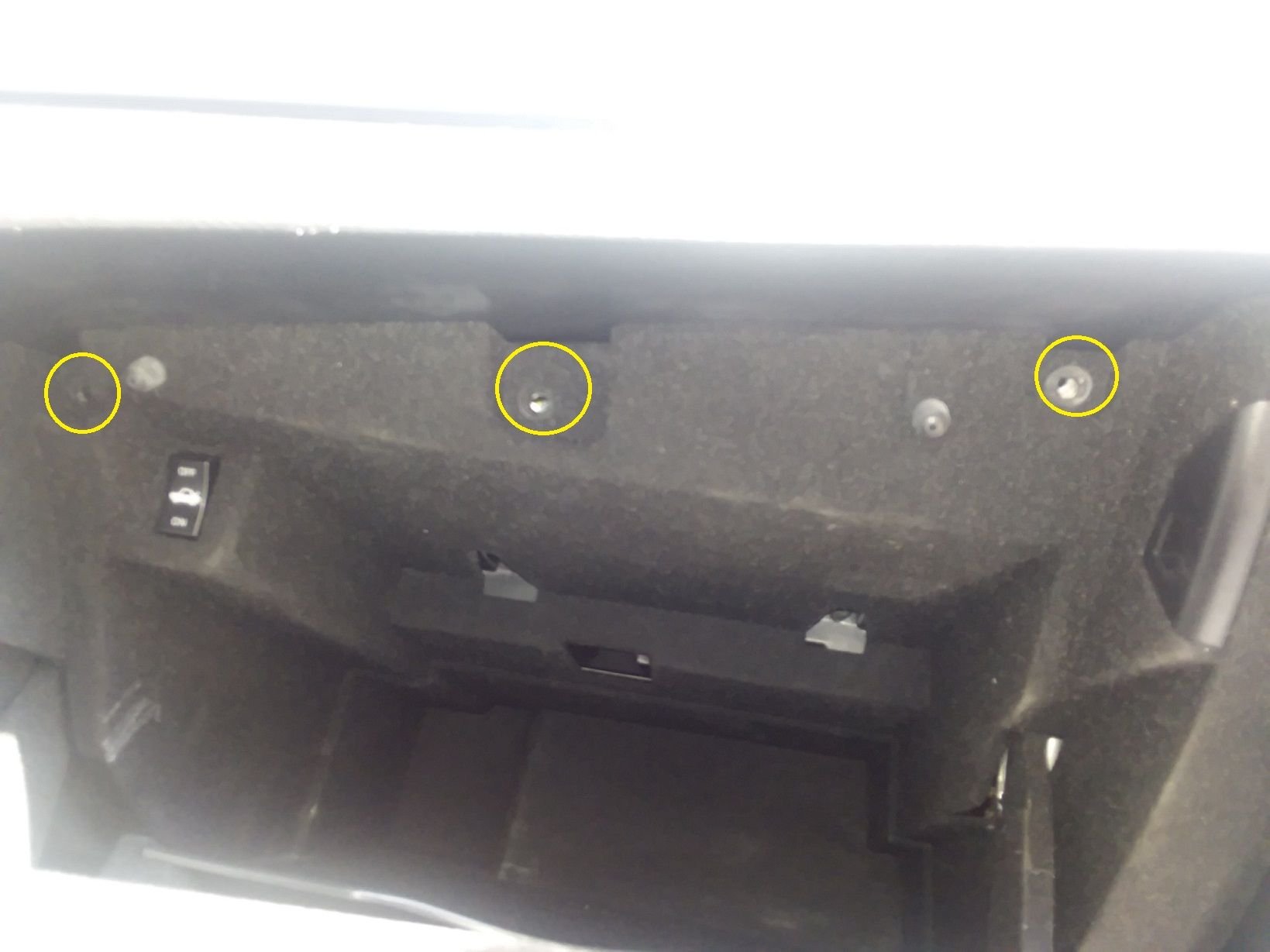

Old Dec 9, 2019 | 05:30 PM
macdonjh's Avatar
Joined: Jul 2017
Posts: 104
Removing the glove box to get to the firewall
I don't know if you have to remove these screws, but I did (see the yellow circles), and the glove box came out.
Screws below the glove box, on the outside.
Screws inside the glove box, at the top.
Screws inside the glove box, back inside.
Pull straight out, firmly. Be careful of the wiring for the glove box light.
