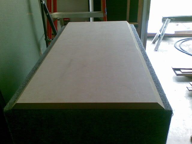

Looks good.
Personally I would have picked a darker color for the carpet.

for the baffle or the whole box?
i tried to tap the knowledge of the audio section, but know buddy had anything to say about gettin the right color carpet.
so this is what i went with it works for my purpose but in the future i wanna try some different carpet cuz this stuff is sort of hard to work with

Isn't the baffle and rest of the box the same colored carpet?
know buddy? do you mean nobody?
What kind of carpet did you use?

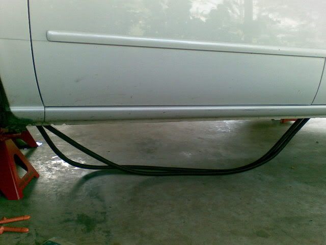

now for the 1/0 being ran underneath the car
grommet the wire will come through
wires in

Underneath the car? Seriously?
And they ran ground the entire length of the car too?

If you bottom out those wires could get scraped and cut, could be some fireworks
Old Sep 26, 2008 | 08:17 AM
  #99
travmaximas1998's Avatar
Joined: Oct 2006
Posts: 986
From: Baytown, Tx
ya the ground all the way to back i know its overkill just wanted to have a real solid ground.
and yes im aware of bottoming out, my car isnt dropped or anything, so im not real worried about it i will keep an eye on my wiring.
i am double fusing the positive run, to avoid a fireworks show if it happens to short out

oh and the real reason i brought the negative to the back cuz i will be running a second battery

A more solid ground would have been to ground it to the sheet metal in your trunk. It all goes back to the same place anyway.
Double fusing is absolutely unnecessary unless you expect something to go wrong in between your battery and your first fuse... ~15 inches? I think not. Once a short occurs, you want the power cut as close to the battery as possible. Think about it logically.

since i was going to run 2 batteries i thought having a fuse ~15" from starter battery then ~15" from battery in trunk
The body probably has more resistance than the wires he ran.

not if he grounded directly to the frame rails or any other solid piece of metal in the trunk. the difference might be negligible.
double fusing is completely necessary since there is a hot in the trunk as well as underhood. suppose something happens between the underhood fuse and the rear battery. without being double fused the front fuse will blow but you will have a hot wire from the rear battery up. a fuse as close to the front battery + and one as close to the rear battery + as possible is the right way to do it.
i've asked about running a ground back up to the battery as well. some say it doesn't make a difference and some say it does (although it may be negligible). i researched a little on ground loops and came to the conclusion that it's probably a good idea because of al the bcu's grounded to the chassis in the 4th gen. one thing is for sure though; a sheet metal ground is not more solid. it is as solid at best.

I was under the assumption only one battery was being used.
Reading >>me.

had a feeling there was a misunderstanding. you're in the audio section way to much to not know what you are talking about.
exactly
thanks mike
and im glad everybody is on the same page now
