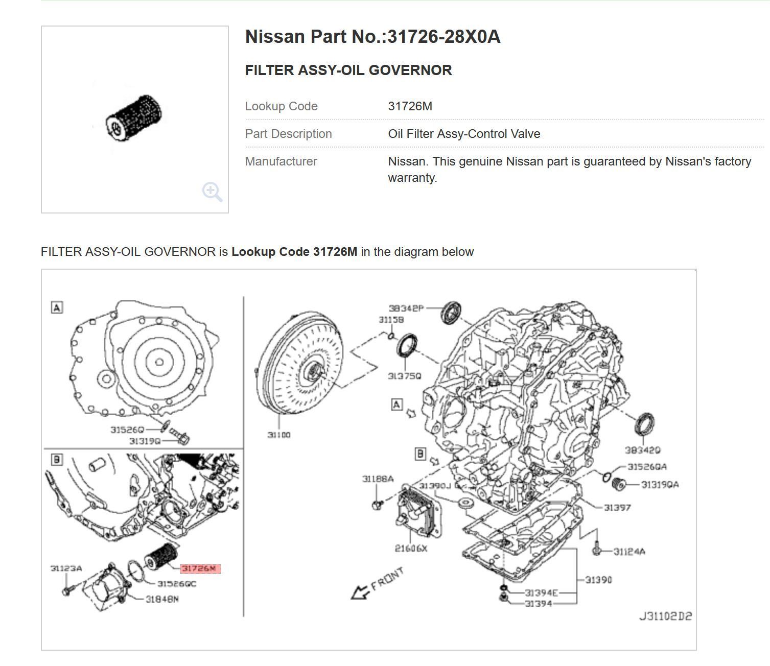

My CVT had a a whine ( metal on metal) as well even after replacing the fluid. That whine appears to have been caused by a restriction due to the CVT filter never being changed when the CVT was serviced. I changed that filter out and the whine is now gone.

sorry if I sound dumb but this is a transmission drain and refill, which is different from doing a full CVT flush correct? I just bought a 16 SV, with 68k miles and no CVT flush has been done yet. Which would you recommend?
Old May 20, 2021 | 03:17 PM
TDGrant's Avatar
Joined: Sep 2020
Posts: 384
They, they are different. Just do a drain and fill, Enzo.
Previous models of the CVT have a external filter. Replace that also if your model has one.

This is what I have for a filter - https://www.my4dsc.com/change-cvt-tr...7thgen-maxima/
This is what you have (@ 15min) -
This is what you have (@ 15min) - https://www.youtube.com/watch?v=fOOtLmGvK2A

Originally Posted by Enzo
when you ordered your filter did you order a new o-ring seal as well or did you use the one on there already? My dumbass didn’t think of the seal
I would just re-use the seal for the cartridge filter if you do not have one. They are easy to replace, since it is an external filter, so I would just re-use it for now. Order a new one and replace it when it arrives. No big thing.
