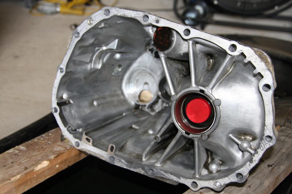

The 5mt is staying for the foreseeable future, but the OEM VLSD unit will soon be replaced with my old Quiafe....and attached to a larger engine

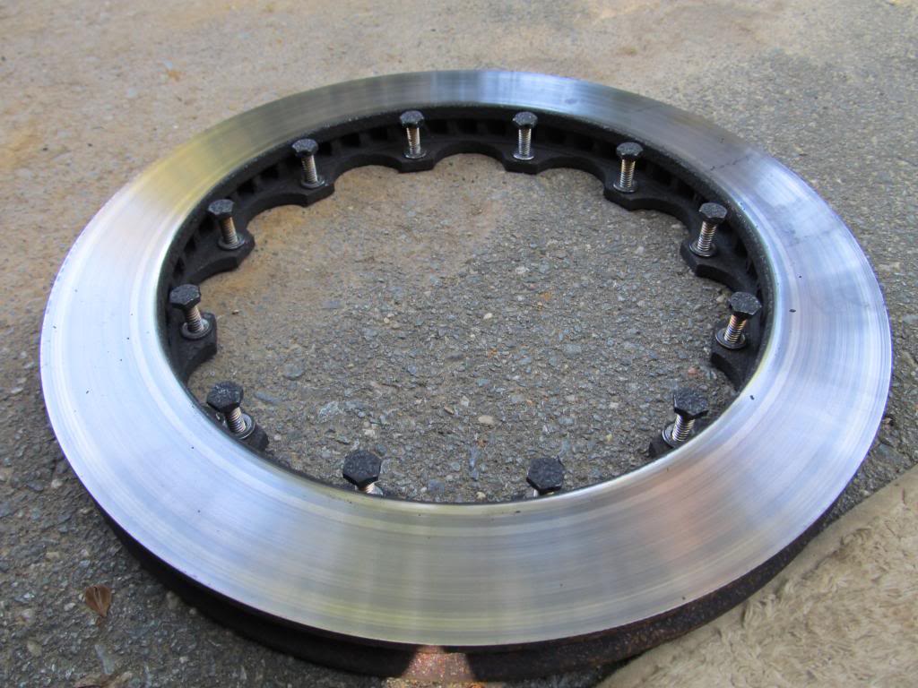

Well after some 15 months my new front brakes were toast (Wilwood 12.9" 2-piece rotors with Carbotech AX-6 pads). I had to switch cars and drive the E28 for the final Solo race of the year due to the parts not arriving in time, but that ended up being quite a bit of fun. More on that later though.
So it seems there was a massive amount of brake dust build up (corrosion?) that seemed to keep the pads from sliding freely, which resulted in uneven pad wear and likely accelerated the wear as well. I couldn't stand the amount and type of dust the AX-6 pads produced. In all my years of detailing cars, I have never dealt with dust that was this bad. Not just in the amount of it (because there was), but more in its composition. After a while, I noticed small amounts of rust building up on the surface of my wheels from the brake dust, and the dust/rust is nearly impossible to remove. The finish of my wheels is pretty much ruined, so I will never be running a Carbotech pad again on the street. I still have the XP-8s for track days, but I'll be sure to clean my wheels off as soon as I get home.
To simplify my wheel cleaning problems and to try something new, I'm trying out the Wilwood Polymatrix E pads which will hopefully give me the initial cold bite I need for auto-x while not ruining my wheels in the process. Since the slots in my slotted rotors had disappeared within some 7 months of use, it was also time for new rotors.
Yeah, that's not exactly ever wear:
I'm assuming this might have had something to do with the pads not sliding freely

Old- 25.77 mm thick
New- 28.05 mm thick

I'm pretty sure that I need to disassemble these every couple months and re-grease them to make sure they're sliding freely, because I really don't want to be replacing front brakes every year.
After breaking them in, I experienced some pretty heavy "whirring" when coming to a stop that I attribute to the slots in the rotors still having edges to them, but this seems to be going away the more I drive it. I'm pretty sure the same thing happened last year when we installed these. I haven't had a chance to really test the pads yet, but when I do I'll post up my thoughts.
