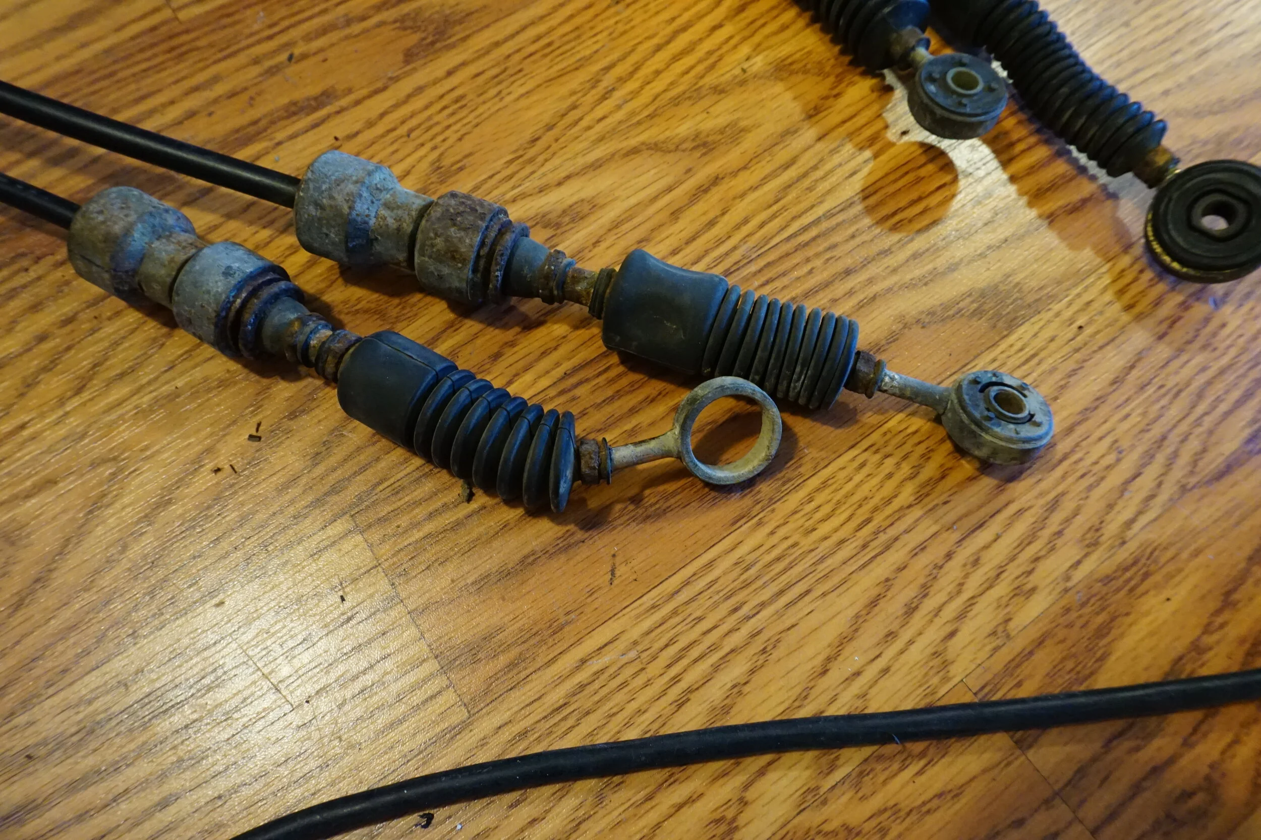

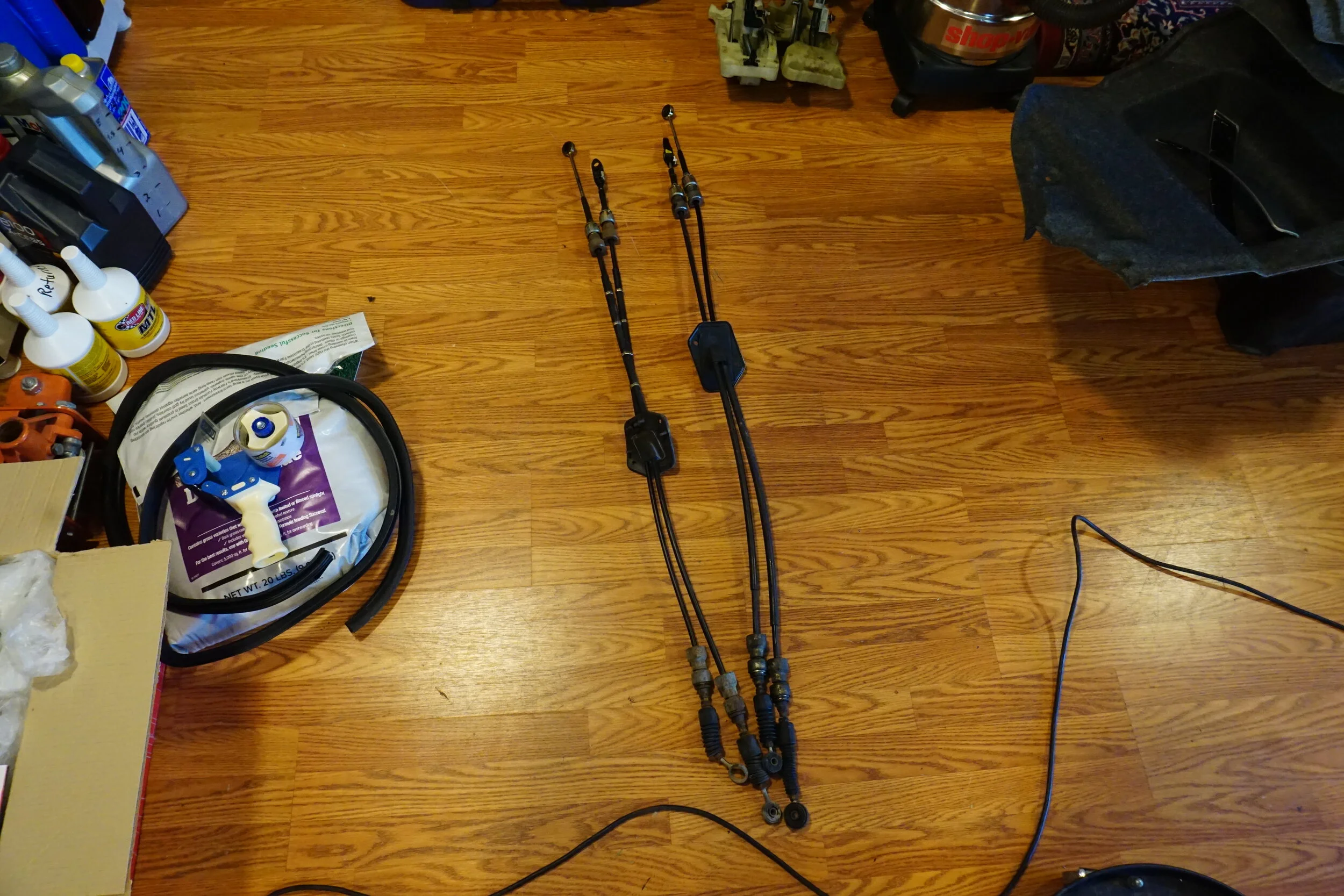

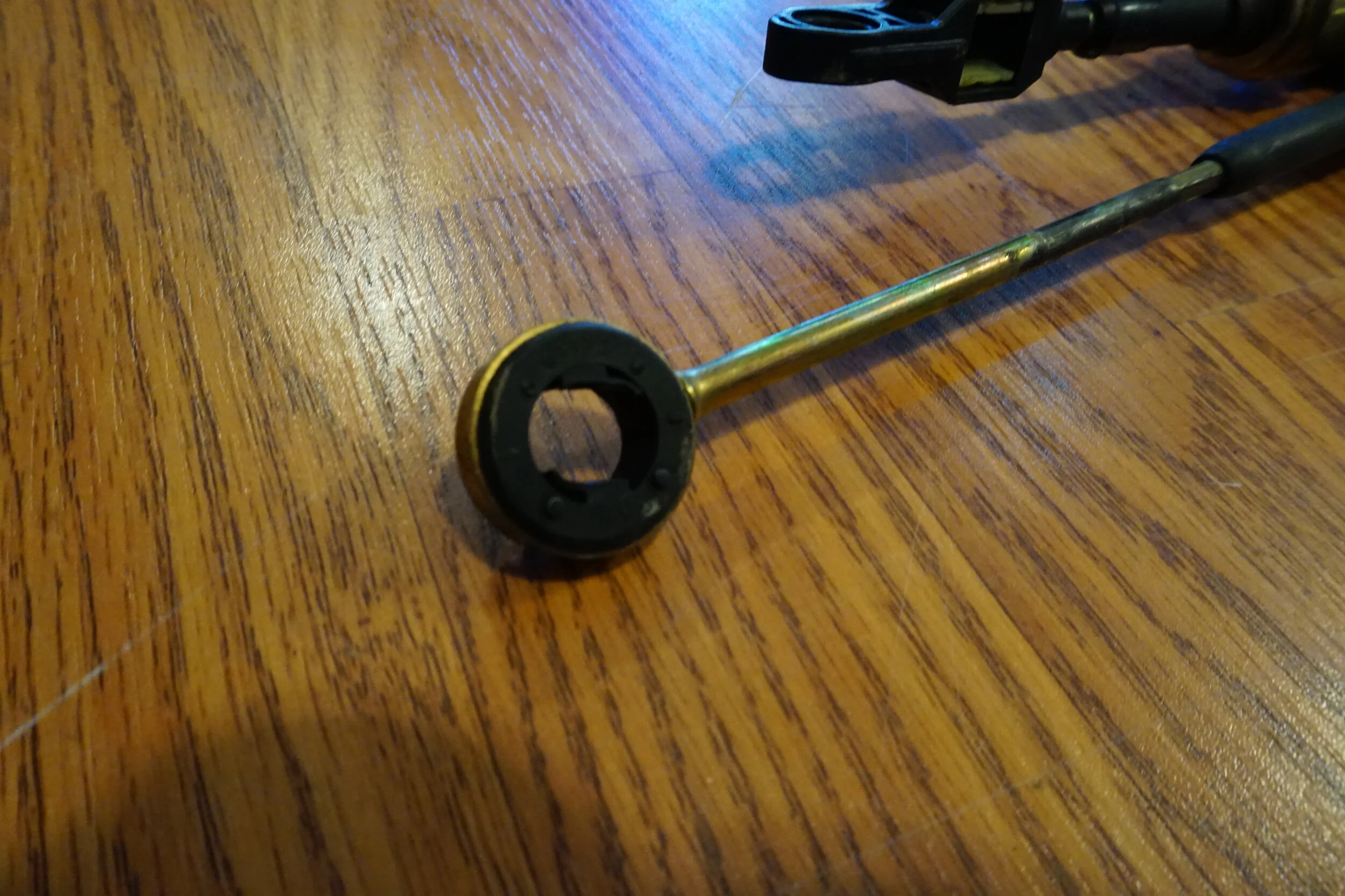

I've got some questions about the 6 speed swap, does anyone know the answers?
-Can I use the shifter assembly and cables from a 6th gen, or only 5.5 gen?
-Can I use the trans frame mount from a 6th gen, or only 5.5th gen?
-Can I identify an HLSD 6th gen trans the same way I would in a 5.5th gen? Metal pedals and the plate on the firewall with RS6F51H code?
Edit- I did some more reading and at least one person confirmed you can 6th gen shifter parts, but it sounds like 5.5th gen fits with less work.

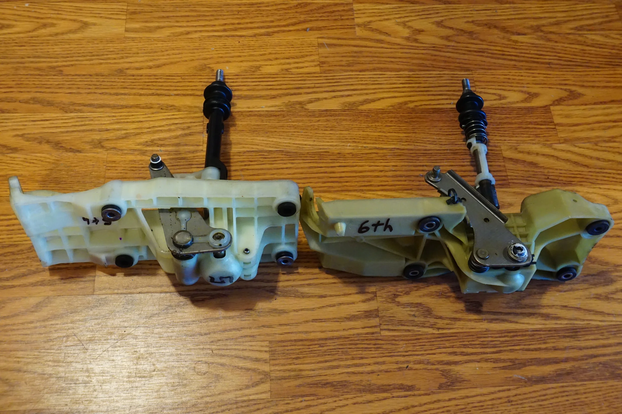

Yes. 5.5 gen shifter is the bolt in solution but there's a 6th gen shifter in my 4th gen rn.
Doesnt matter as long as you use the same chassis frame for both mount and bracket mount. Can not use 6th gen frame and 5.5gen bracket for ex.

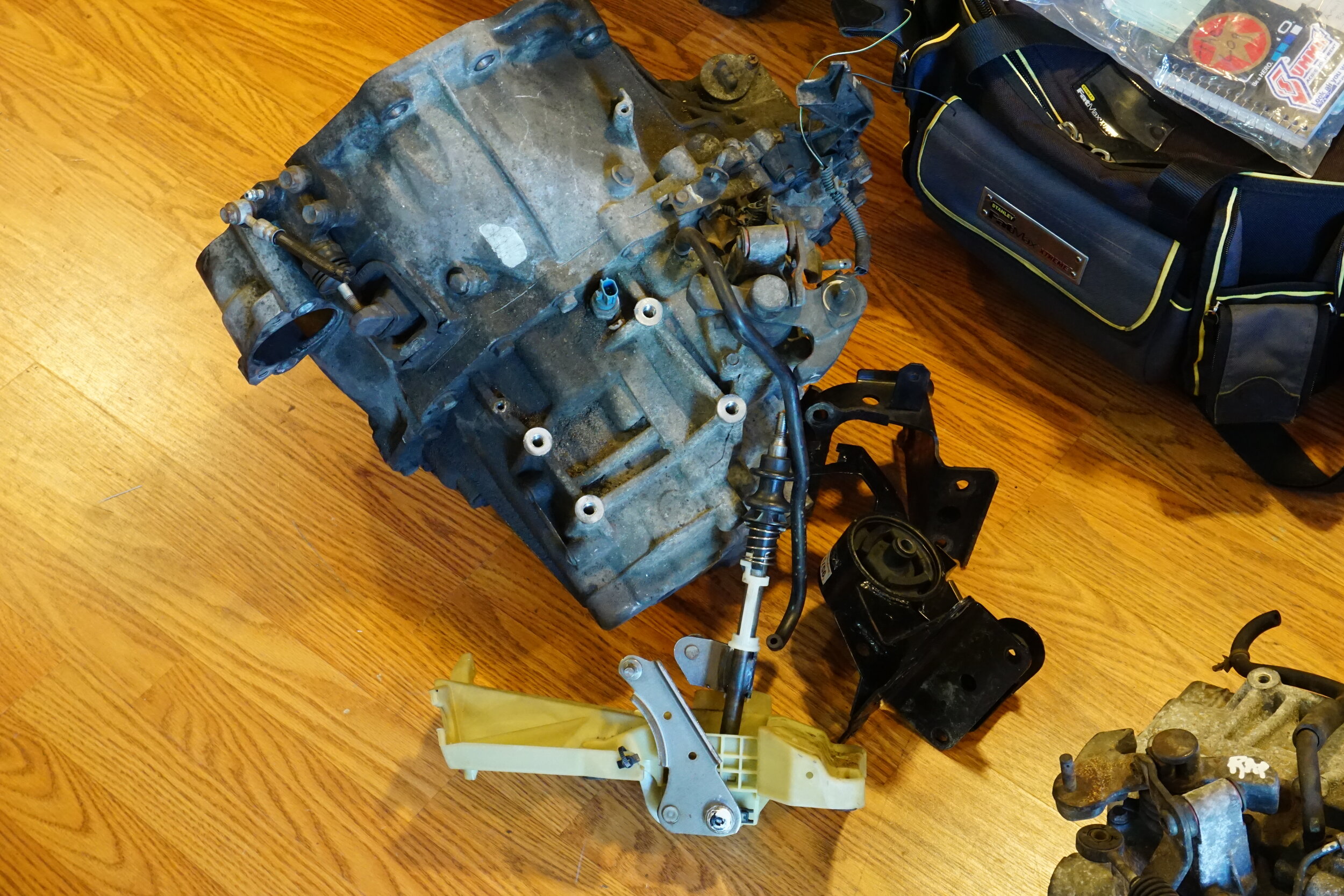

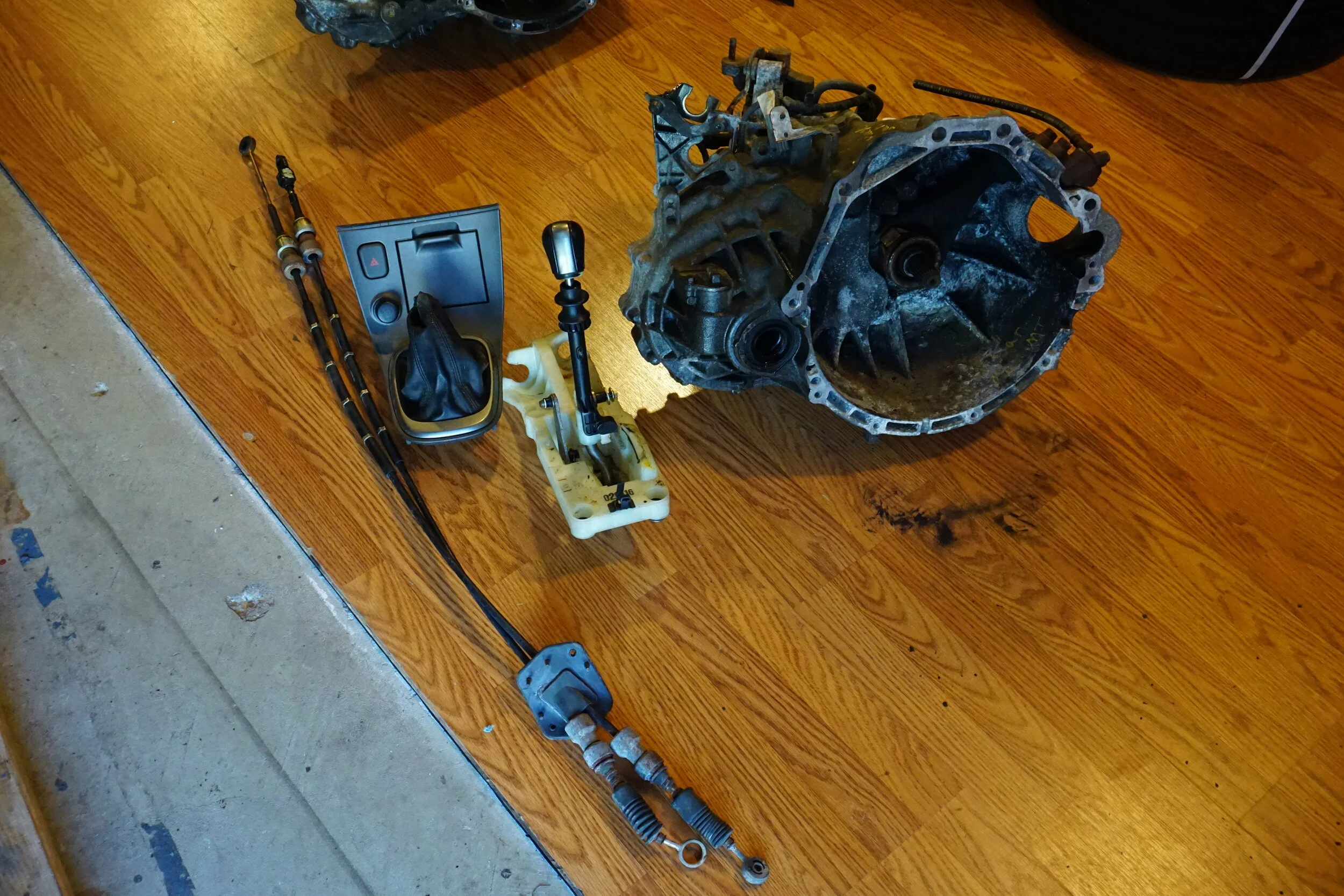

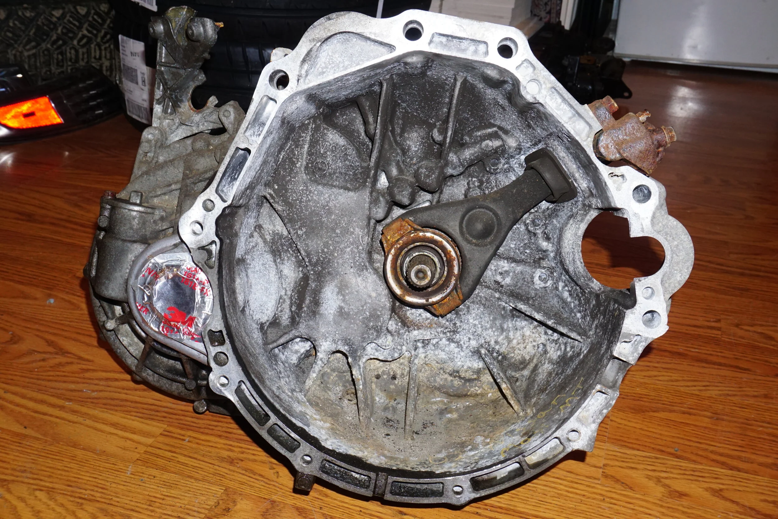

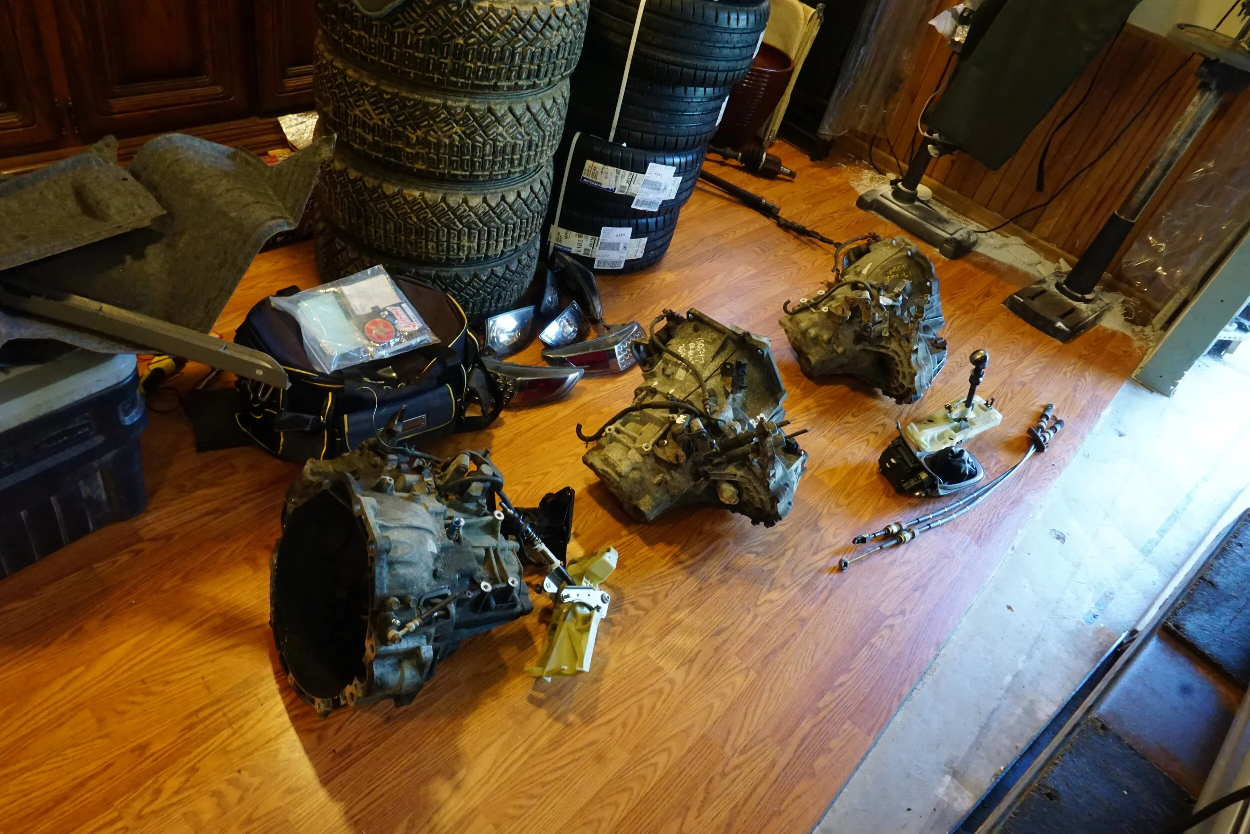

Well, I just snagged an open diff and all the accessories out of an '06 at the junkyard today
I was hoping it would be HLSD, but I can always replace it later. It was only $170 for the trans.
I really don't auto-x very often any more, so I'm not super duper concerned about speeds in gear. I'll do it again, but it's not the priority it once was. All my numbers were pulled from random threads all over the org, I'll trust yours over mine! So 04-06 Sentra FD is 4.133 but 04-06 Maxima is 4.144? Weird.

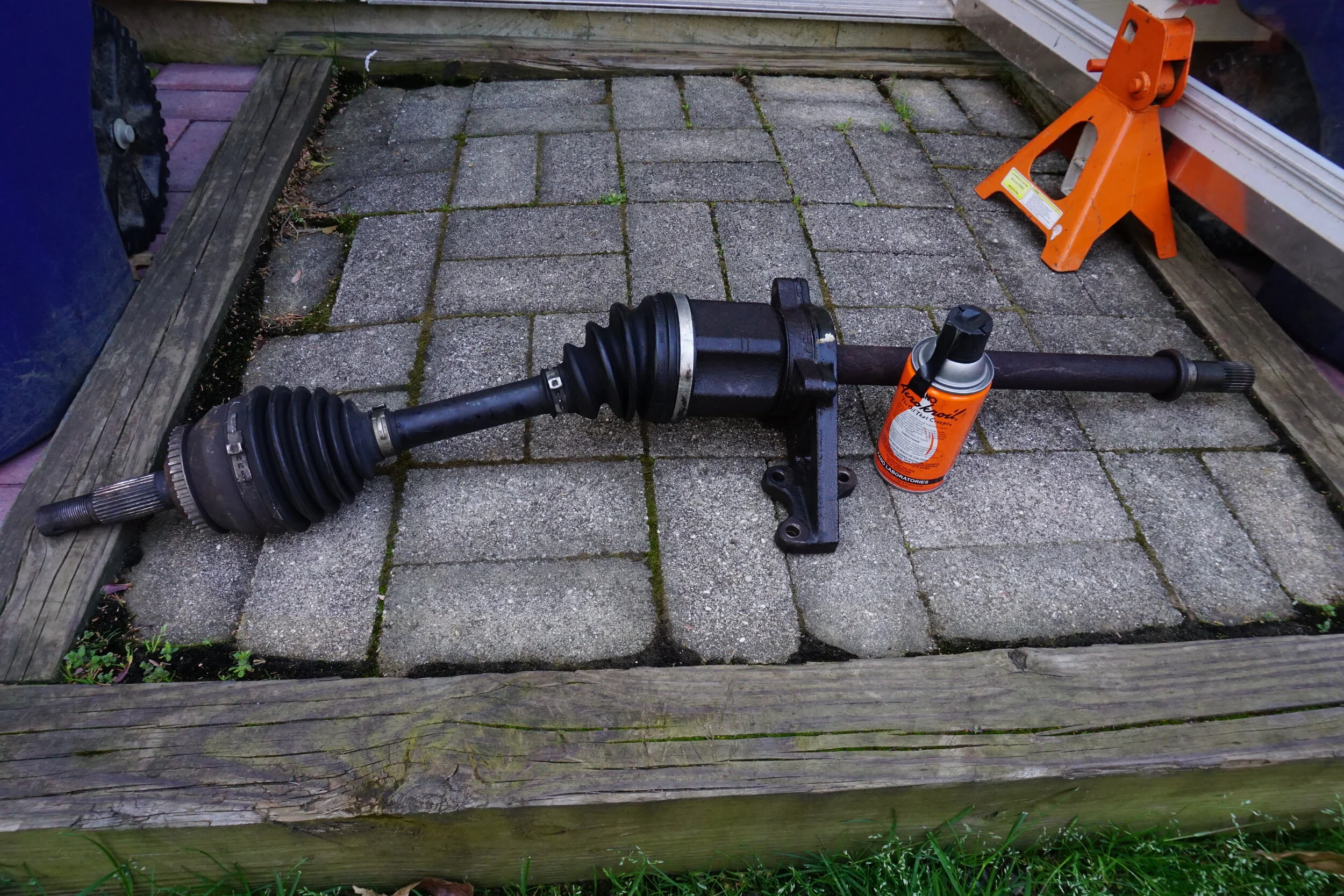

Why, yes, I do have more questions

-What's the deal with the PS axle? Why do people say that only an OEM one will be the right length?

Since you grabbed everything from a 6th gen and you currently have a 4th gen... I would make sure you have a 6th gen axle bracket?
This is one of the few parts out there that is.... SIX SPEED ONLY! I REPEAT YOU MUST USE A 6MT PASS SIDE AXLE! I would guess at some point in time in the past people have tried a re manufactured axle and ended up with an automatic axle instead of a 6speed manual axle.
.... I'm trying to fab up a custom axle bracket to use 4at/5mt passenger side axles.... but that's a slow painful process. Just forget I even mentioned it.

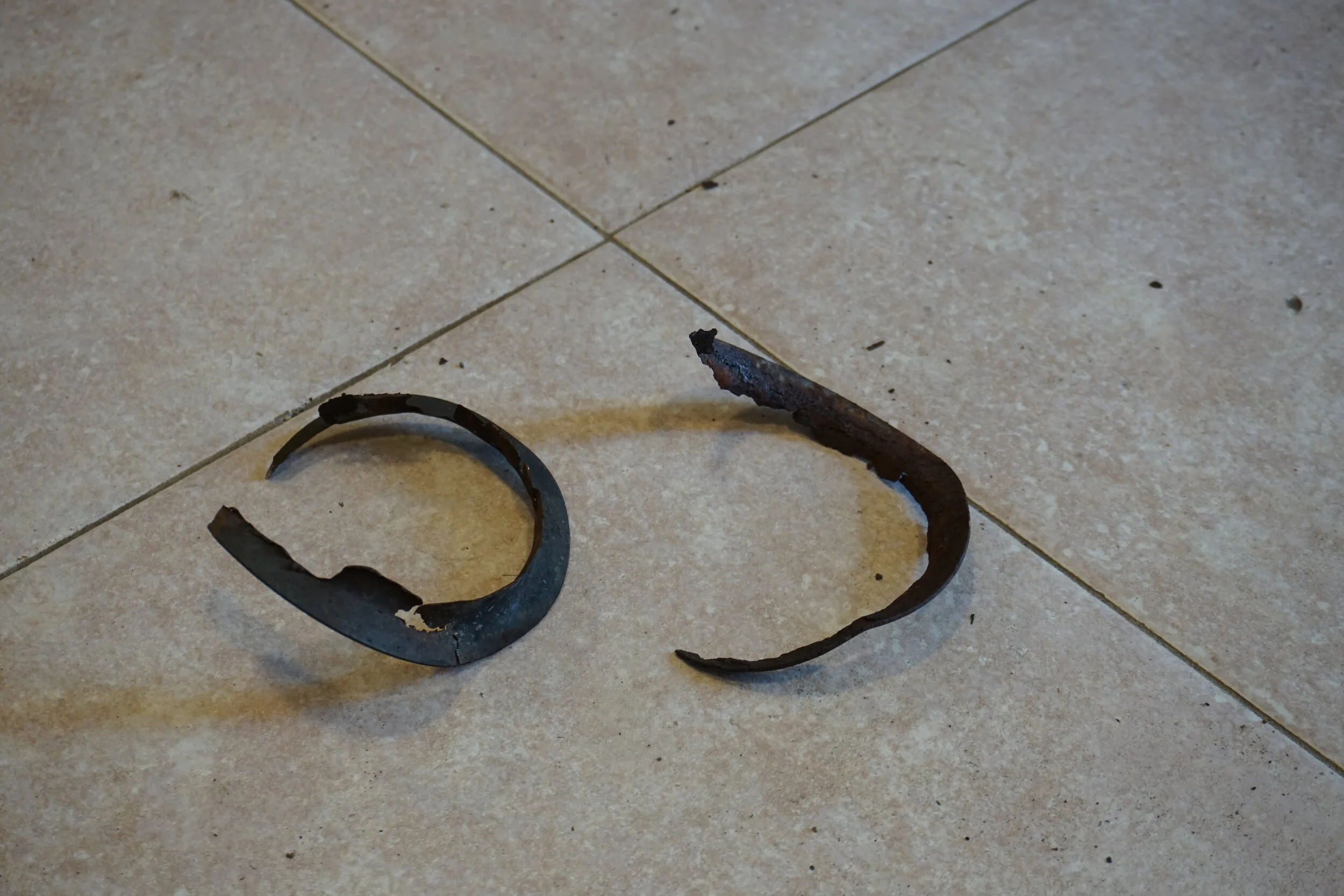

Crawling around under the car, I decided it was time to finally replace the flex section in the Cattman headers:
So I ordered a new flex section but haven't installed it yet. Then I got to wondering, did Cattman ever make a 3" version of this thing? I bet that would make some nice power gains with a 3" cat and catback....

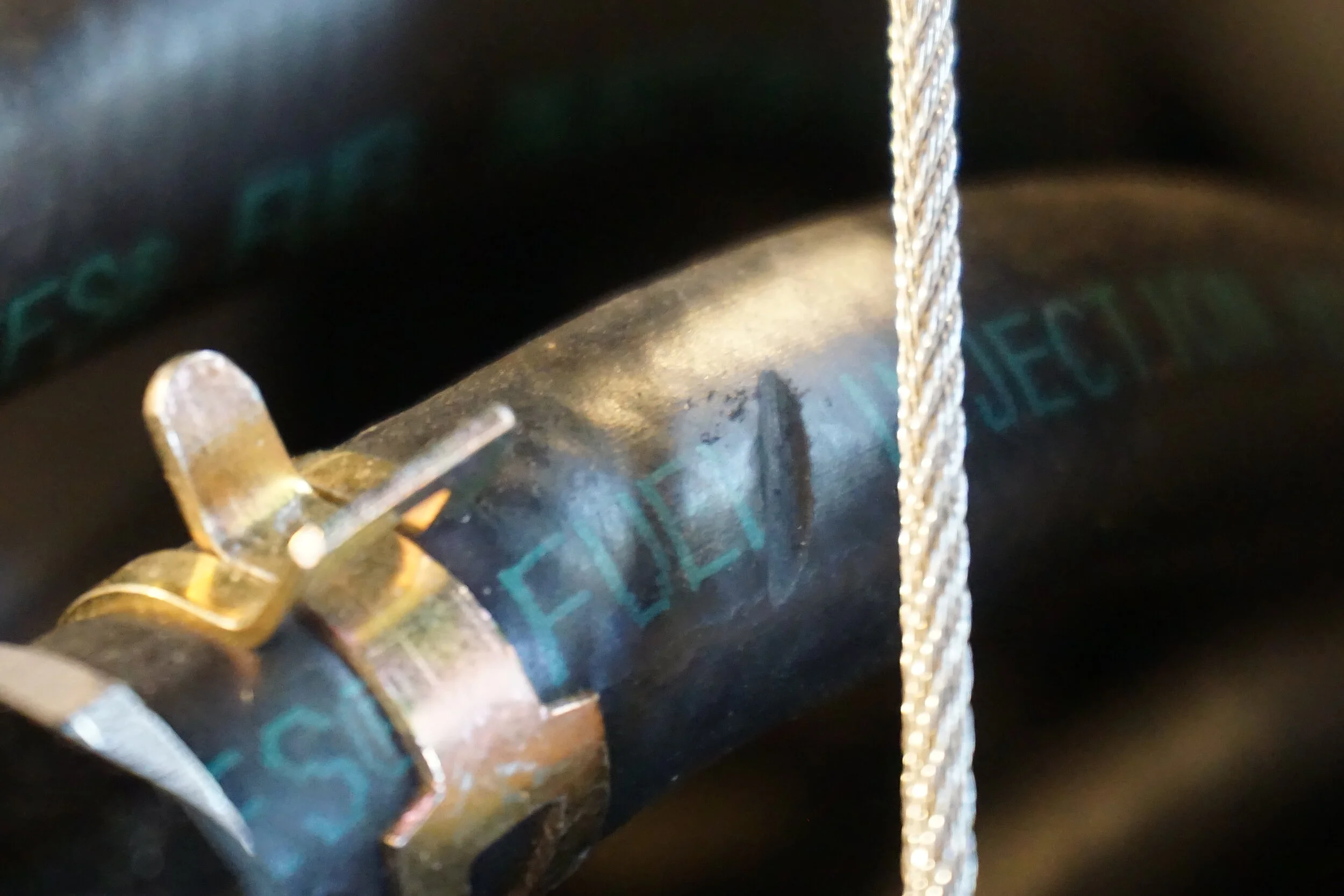

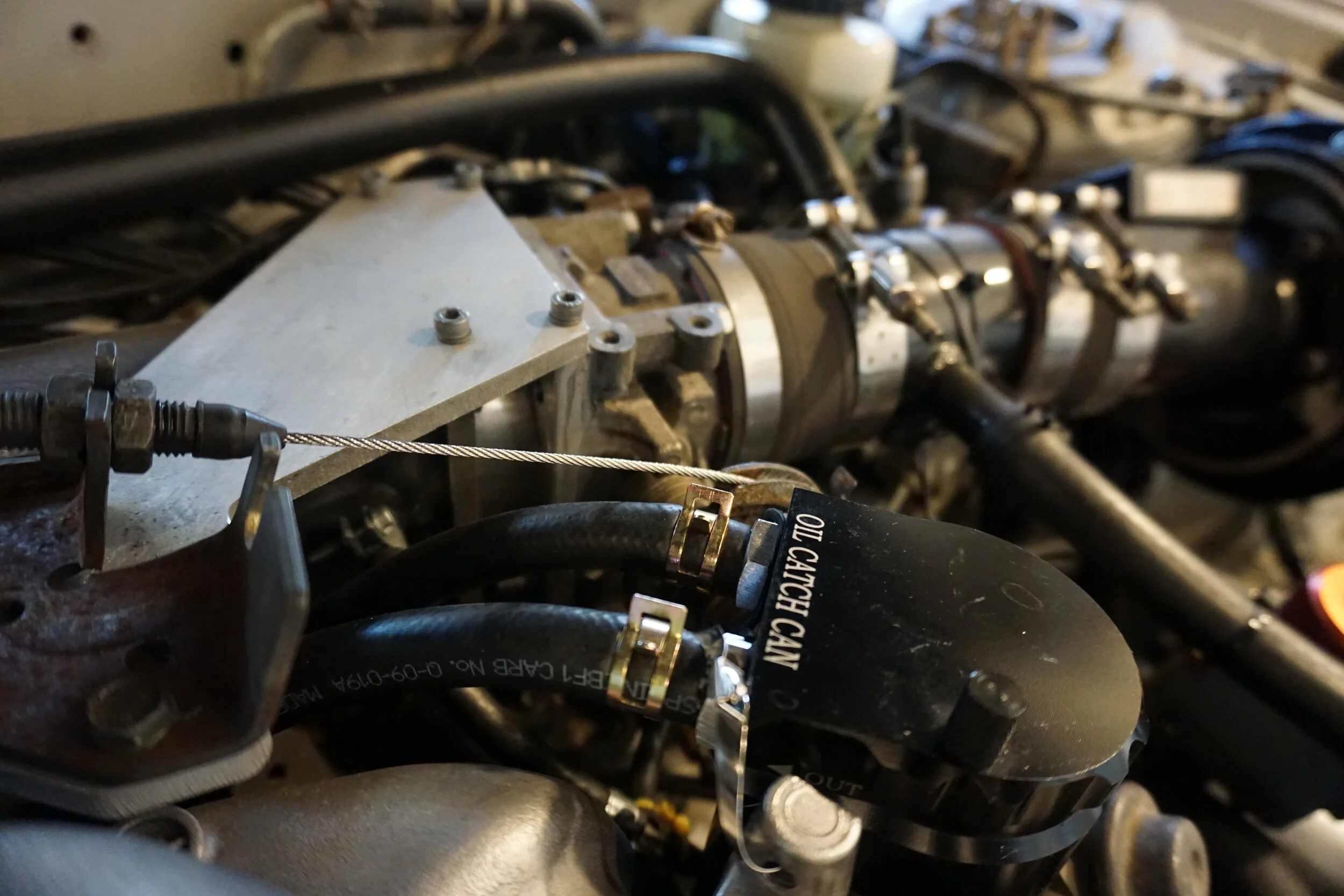

I also fixed up my oil catch can. Sure enough, one of the lines had started to rub against the throttle cable.
So I removed the little bracket from the can and was able to slide it a little lower.

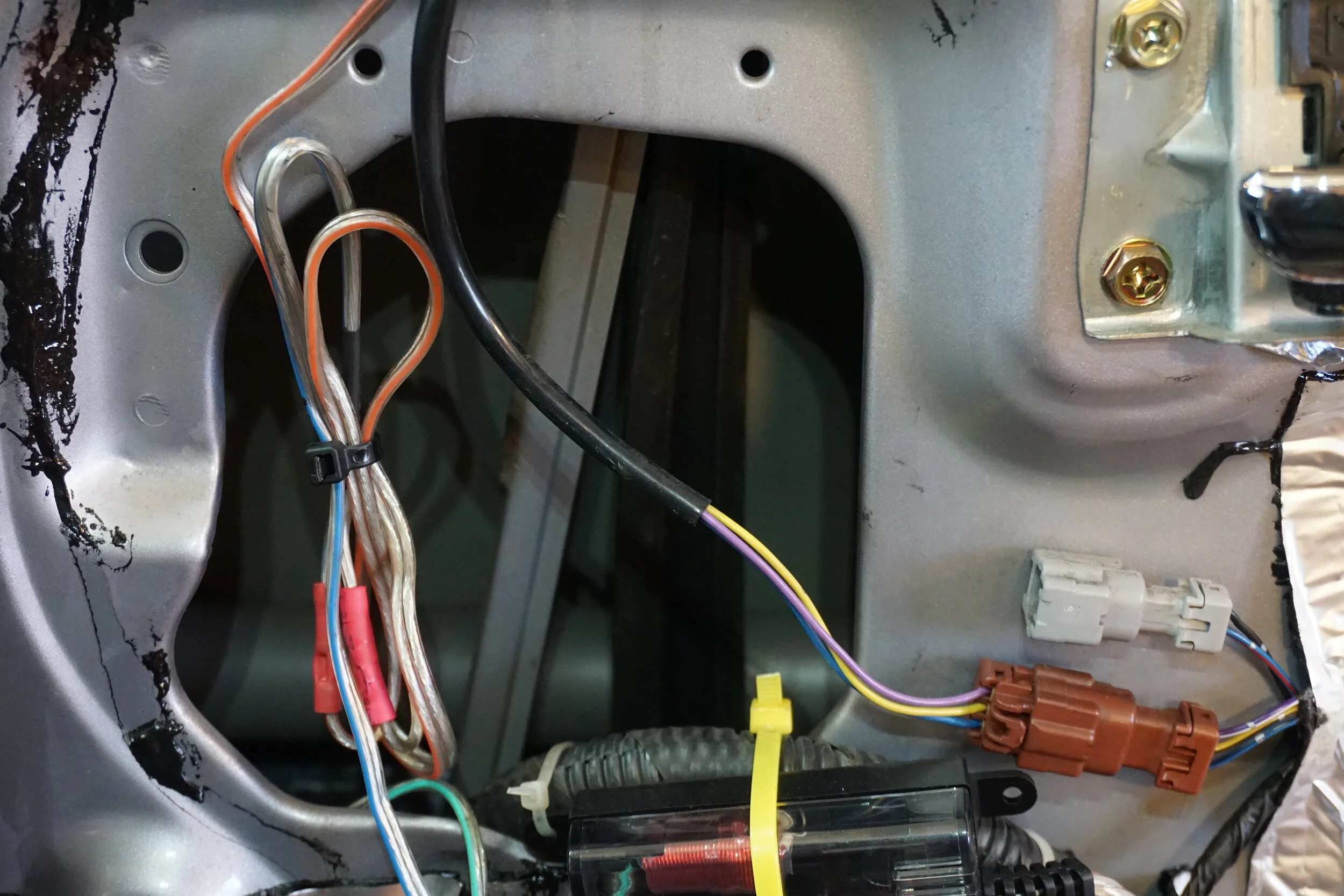

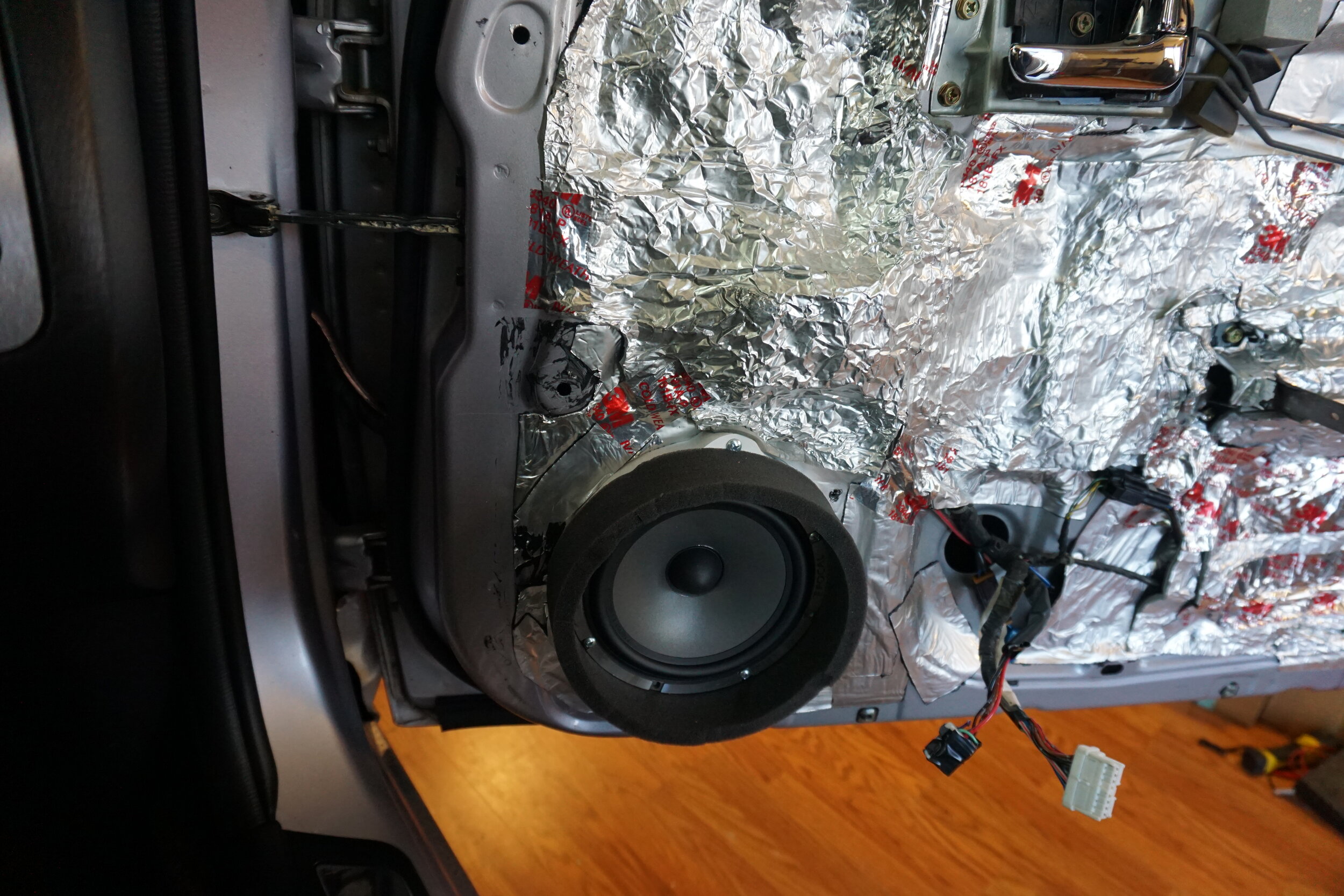

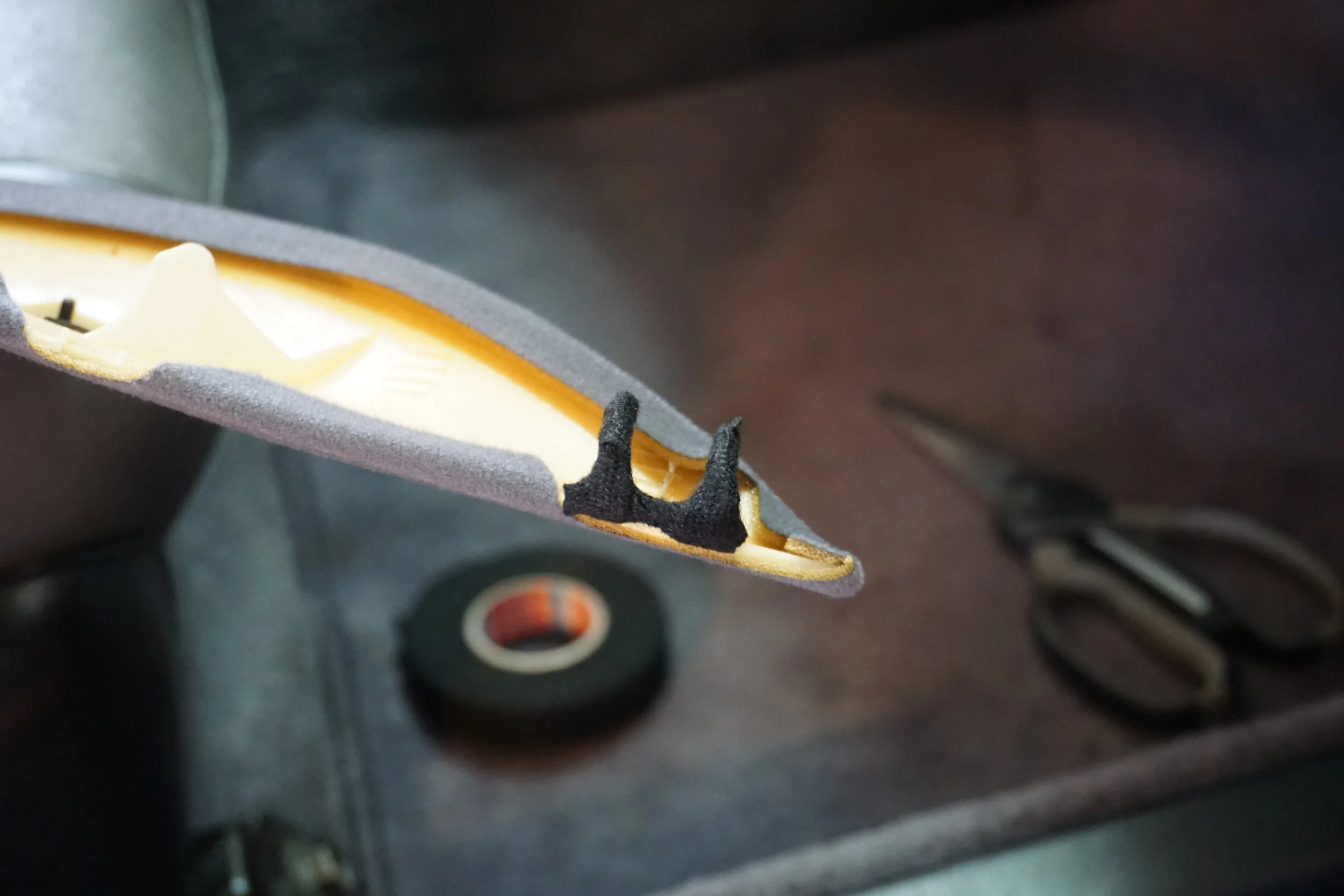

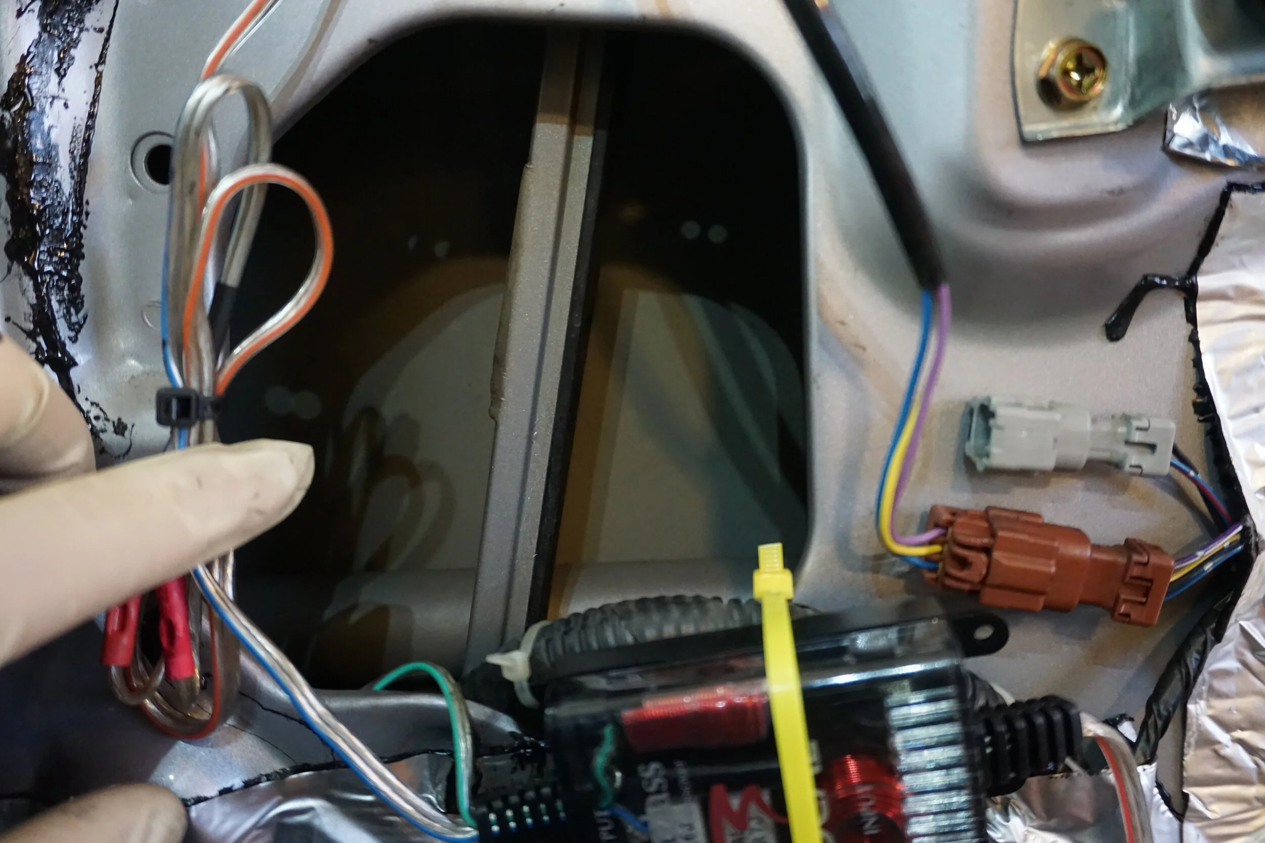

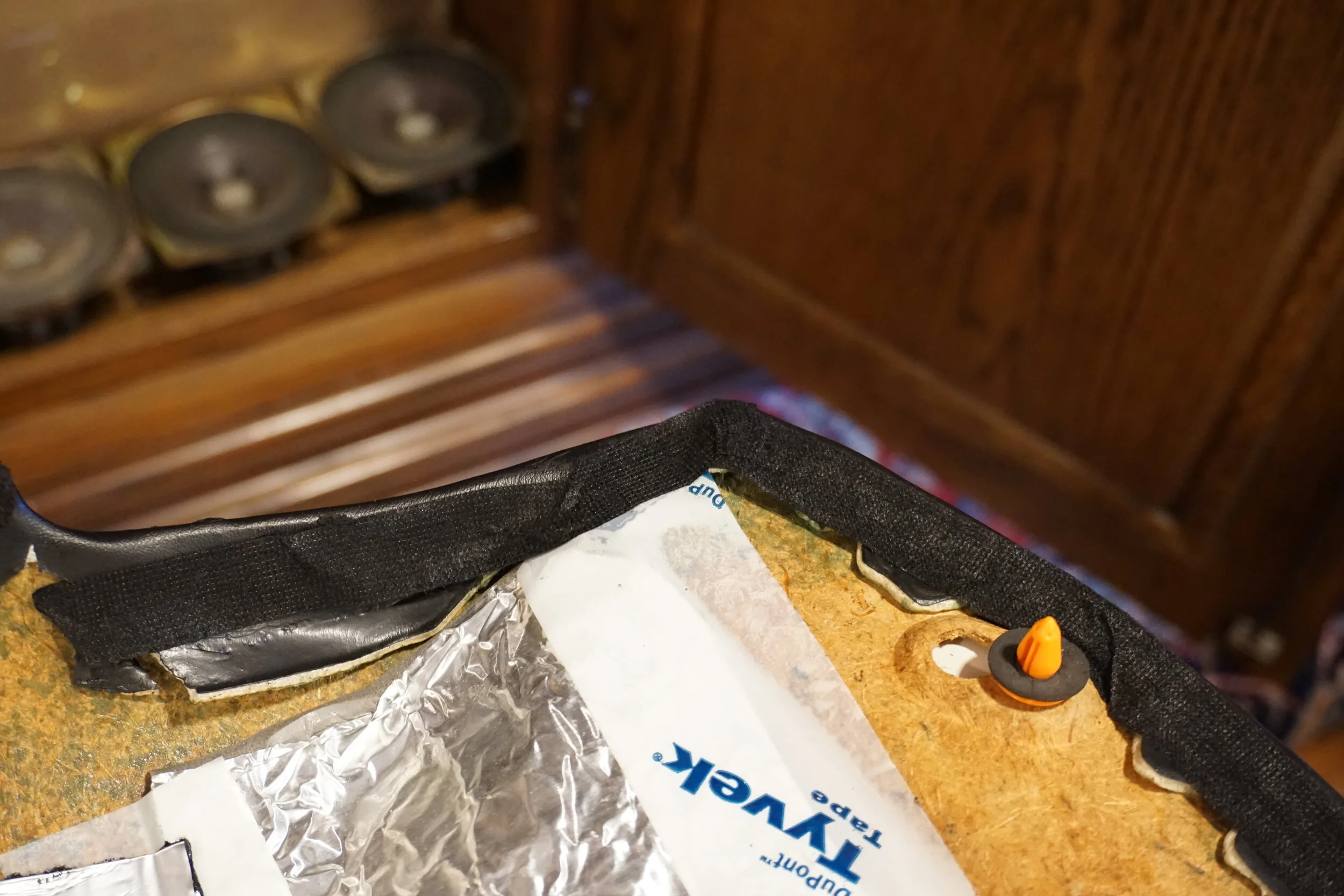

I have also been dealing with some very annoying squeaking from the passenger side door area for many months now, so I decided to buy some anti-squeak/anti-rub products:
While I had the panel off, I noticed the window rubber guide was out of its track, so I superglued it back in place. I also liberally applied some Shin-Etsu silicone grease to the tracks to hopefully keep the window moving smoothly.
I think I found the source of the squeaking: I had too much sound deadening around the holes that the door panel clips into, preventing one or two clips from clipping in. This allowed the panel to stick out just a little bit, rubbing against the dash, which made the noise. I trimmed the deadening off around the clip holes, and did some other things while I was in there. I also trimmed the foam surrounds for the door speakers, since they were too tall and were pushing the door panel outward.
I applied the anti-squeak tape all the way around the door panel to prevent that from rubbing as well. I think there was something similar applied from the factory, but it had worn smooth and wasn't doing much anymore.
I also had found that my A pillars were making some noise, so I put more anti-noise tape on them and the dashboard:
And with all that done, all my squeaks were banished (at least from that area) and I could move on to more important things.

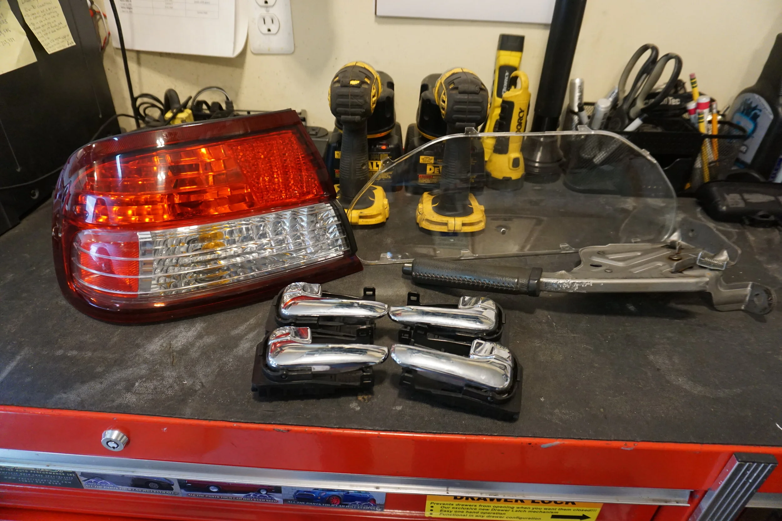

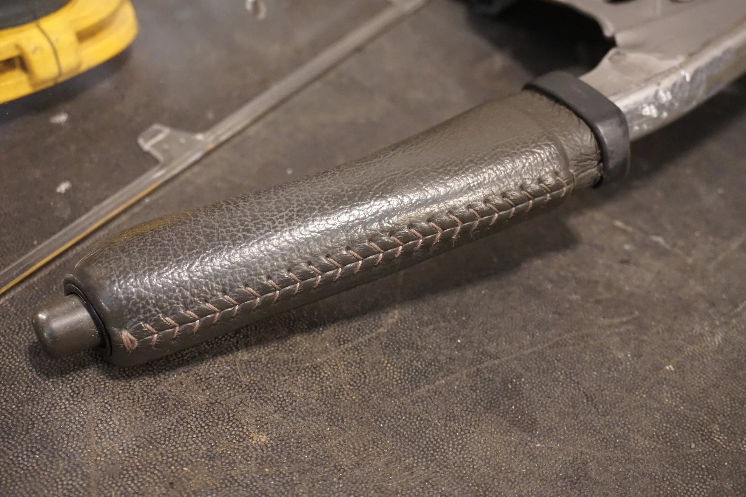

I hit up a junkyard a while ago and was able to get some parts out of a mint condition 98/99 I30 that was there.
To replace this:

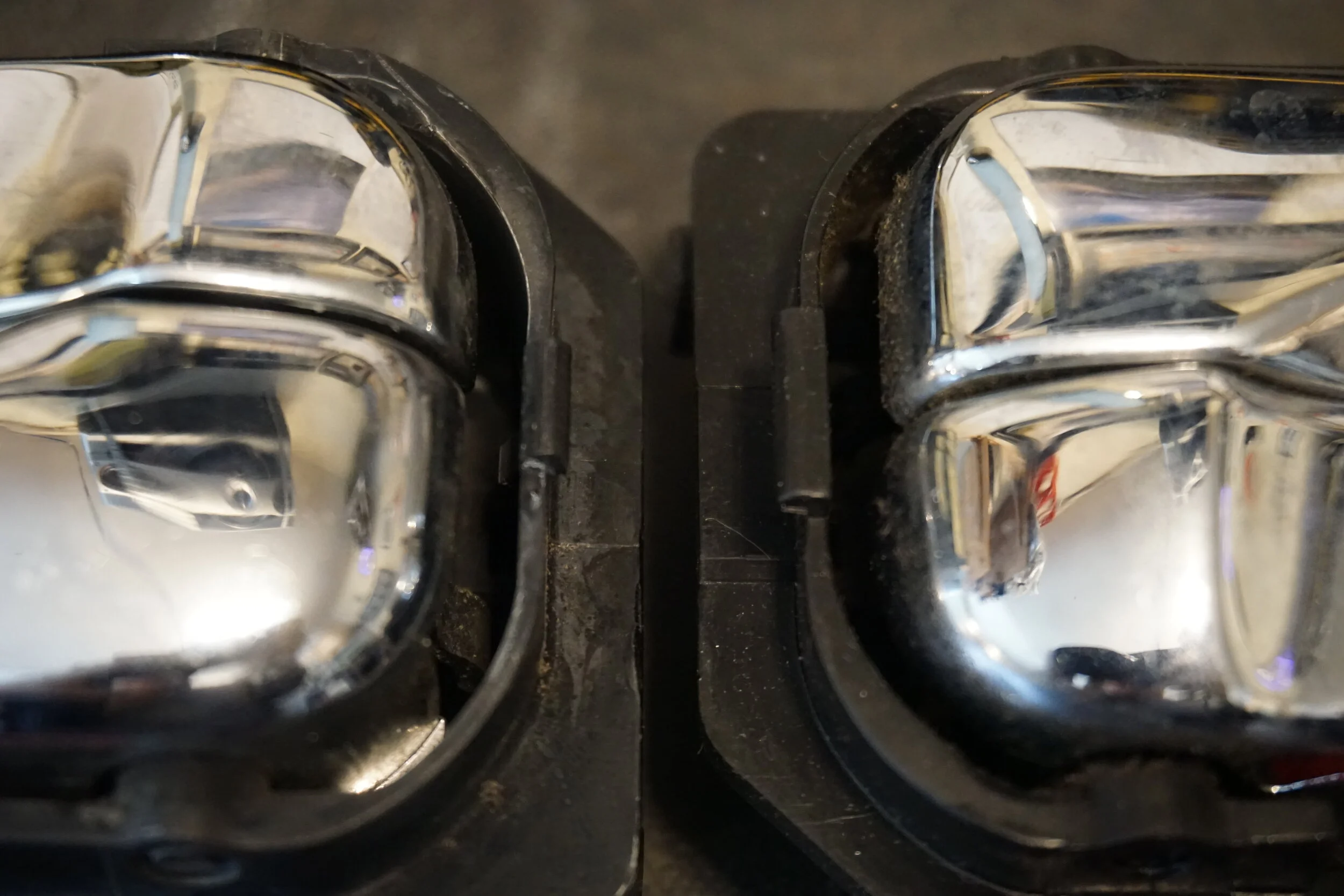

I also have had trouble getting the interior plastic door release surrounds to stay clipped in. Since I've seen a number of the chrome I30 handles start peeling, I always grab them when I find them in good condition at the yard. On these, I noticed that the little clip area was much larger (right) than the ones I had in the car (left), and sure enough, that fixed my loose trim problem. The surround clipped in nice and tight and solved another stupid little issue.
To replace this:
So last week I went to a pick and pull junkyard and scored a 2006 Maxima 6MT with 160k and an open diff for $170. I also picked up both axles, the trans mount, and all the shifter stuff for another $100 or so. Then on Friday I went to another yard that had an 02 Sentra Spec-V trans on the shelf with 138k for $120. Then yesterday I drove out to WV to another yard that had a 2002 Maxima 6MT with 80k and an open diff on the shelf and picked that, as well as all the shifter stuff up for $300. Here is my bounty:
2006 Maxima:
2002 Maxima:
5.5th gen on the left, 6th gen on the right
The cables out of the 5.5th gen were pretty mangled:
But the 6th gen cables were in good shape. However, they are definitely longer than the 5.5th gen cables.
The 2002 trans, which is what I will be putting in the car with the FD and diff from the Sentra, looks like it had been sitting around in the dirt for a while. I'm going to have to do a thorough cleaning to it.

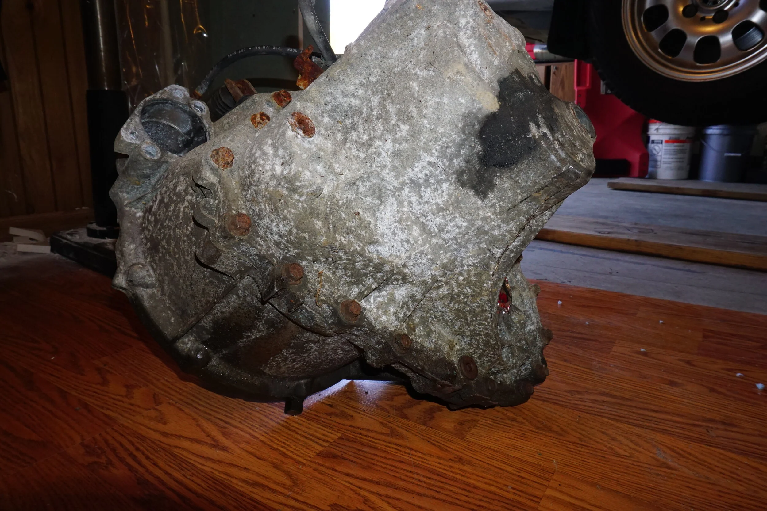

On a side note, the shop that sold me the 5.5th gen trans neglected to drain it, or tell me they didn't drain in. Thankfully none of it managed to spill out in my trunk, but it did spill all over me when I took it out of the trunk and into the garage. By the time I realized what was happening, I was completely soaked in MT fluid, and that **** stinks. Much cleaning followed....
I tried to then separate the 6th gen PS axle from the carrier bearing, but that must have been the OEM axle, because those two were seized together like you wouldn't believe. Much soaking with Kroil and whacking with a hammer got them to loosen a bit, but they still aren't apart. Much more to come! Then plan is to keep the 6th gen trans as a spare, and combine the 2002 Maxima trans with the 2002 Sentra trans to make the ultimate 6 speed!
2006 Maxima:
2002 Maxima:

Do you have a link to the flex section for the headers?
I like those chrome handles. I had the same issue years ago with them not holding the trim. I want another set if I could find a clean set.

Here's the flex section, it's a Vibrant 60806:

Ha, yeah, once I saw the top speed in gear numbers for all the different options in front of my face, I just couldn't help but want a 6 speed with the 4.4 FD. I have some other projects I need to take care of first before I open these things up and get busy, but this is a good start. Once the 6 speed is done and installed I plan on installing an 09-14 Maxima motor. I was wondering, has anyone done one from a 2015+ yet?
Yes, it's been done. In MY opinion it's pointless. Just get the 09-14 and buy a 15+ Manifold. not worth doubling the motor purchase price.
So when I build my super 6 speed using mostly 2002 Maxima parts with 80k miles, is it worth replacing the 3rd gear synchro while I have it apart? Or does that add a ton of extra labor and cost? Regarding replacing bearings, how many are there, three? Final drive, main shaft, and input shaft? I assume I should do those for sure?
And unless your 3rd is already crunchy I wouldn't worry about it unless the shop says it's out of spec.

Unless you personally know someone at the shop do not take un-assembled parts to it, that is my #1 nightmare when working on people's cars.
I really wish I had the time to make a step by step on this stuff, maybe one day, I am under pressure to get a lot of things done because of some major deadlines coming up that will severely limit my ability to do major projects after June.
Plus I work on transmissions under the watchful eye of an old master. I'm still on rookie status. When I graduate to feeling comfortable on doing everything without him watching I'll let you know

That's the way it goes, but you can also look at the synchros and if they're broken/worn then well replace em. Chances are if the car was stock (and NOT from the .org)and appeared to have gotten at least basic maintenance then you have a good trans. The only questionable stuff comes from us idiots
