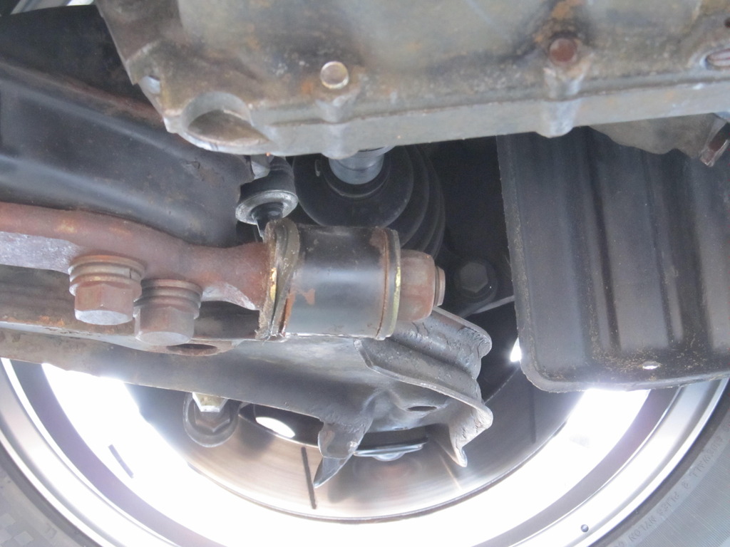

I also noticed another possible result of my speed bump incident:
What do you guys think, does that warrant replacement?

At the last BMW auto-x I blew out my poly ES control arm bushings.
New ones to the rescue!
