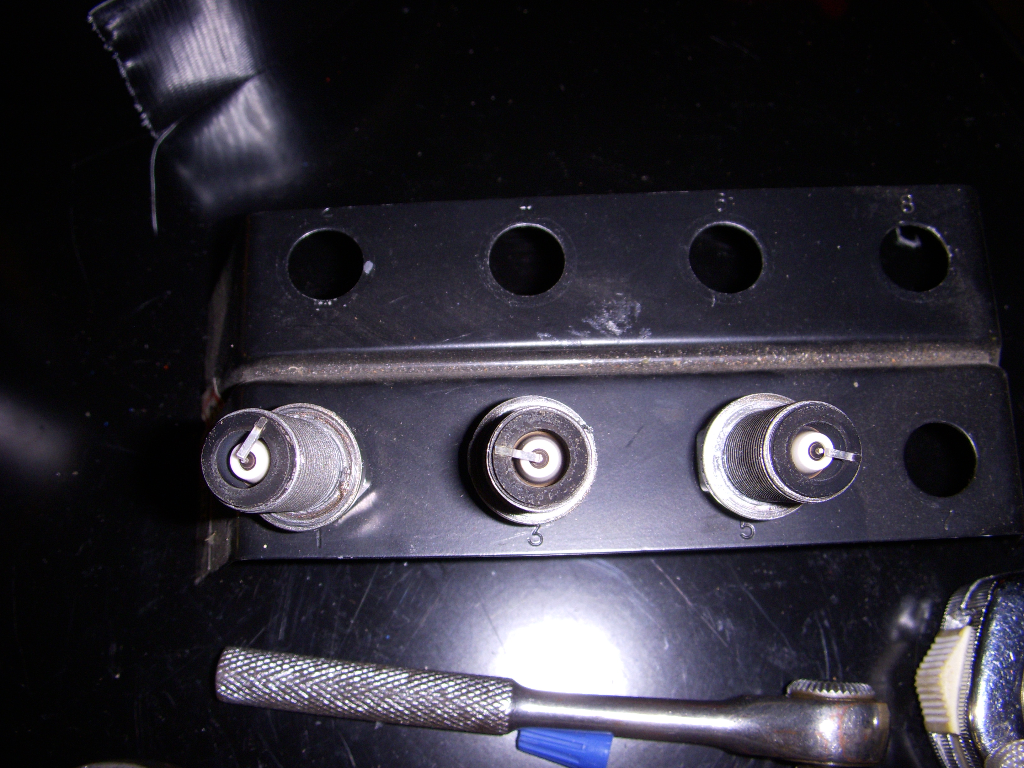

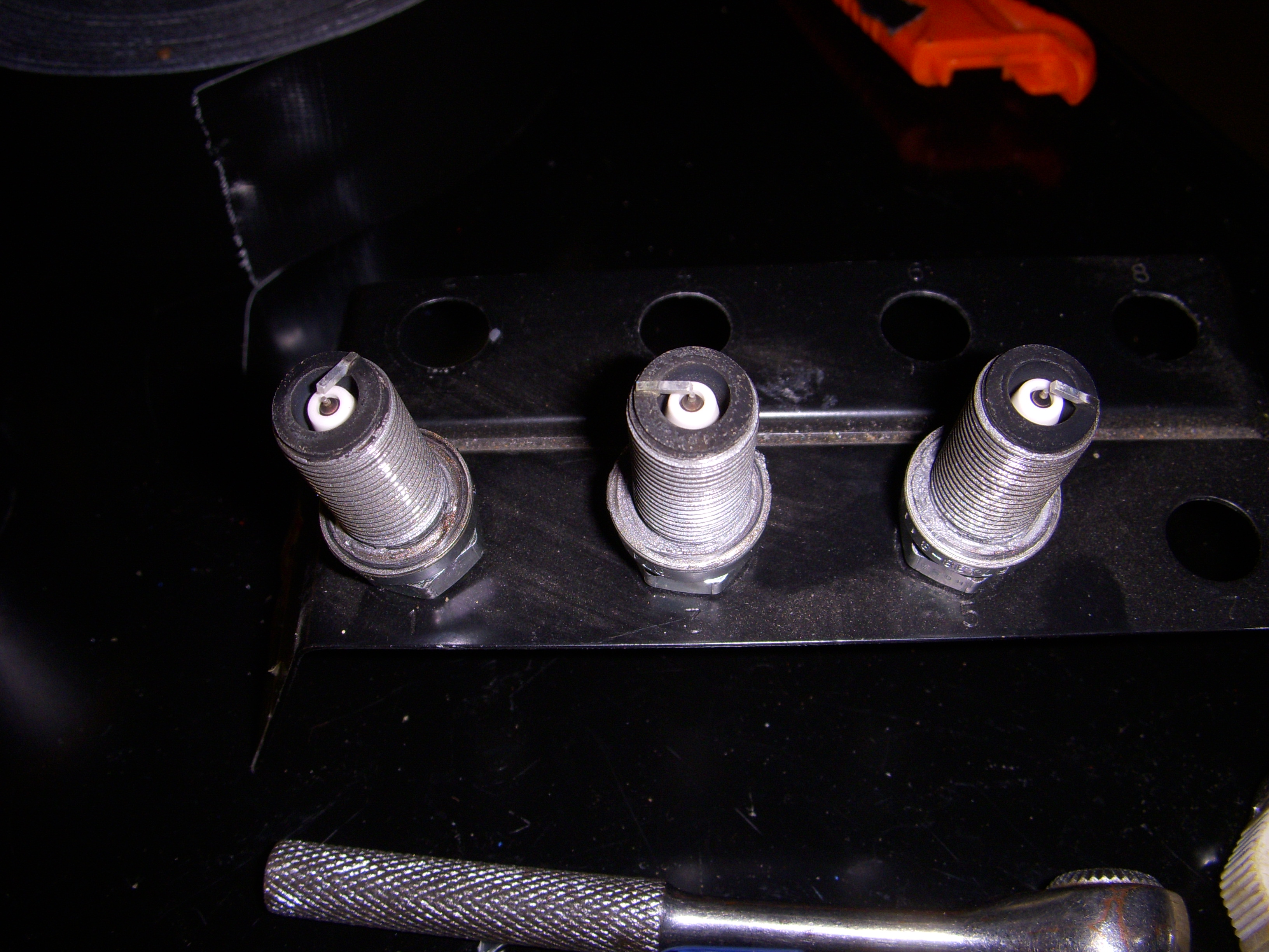

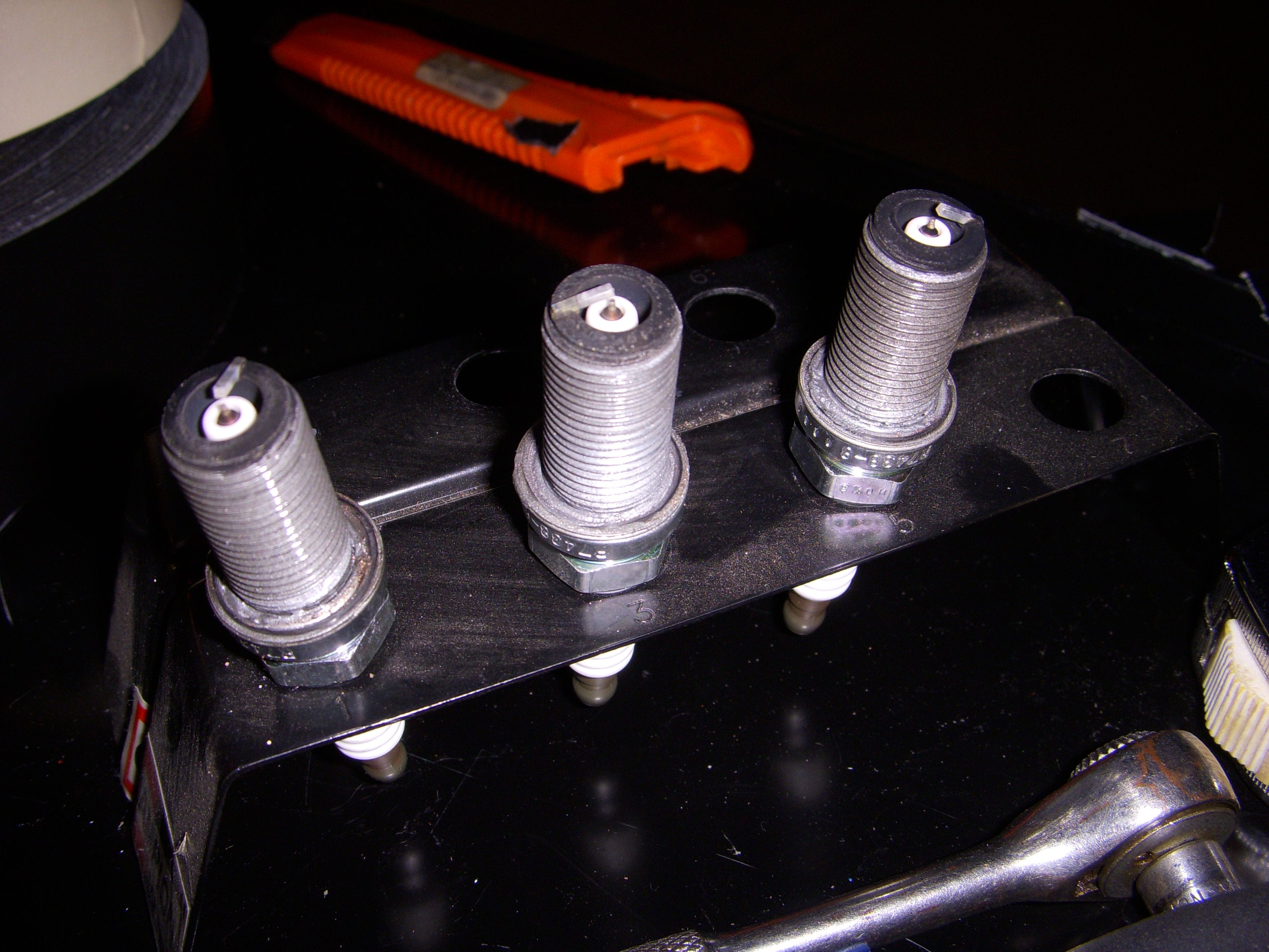

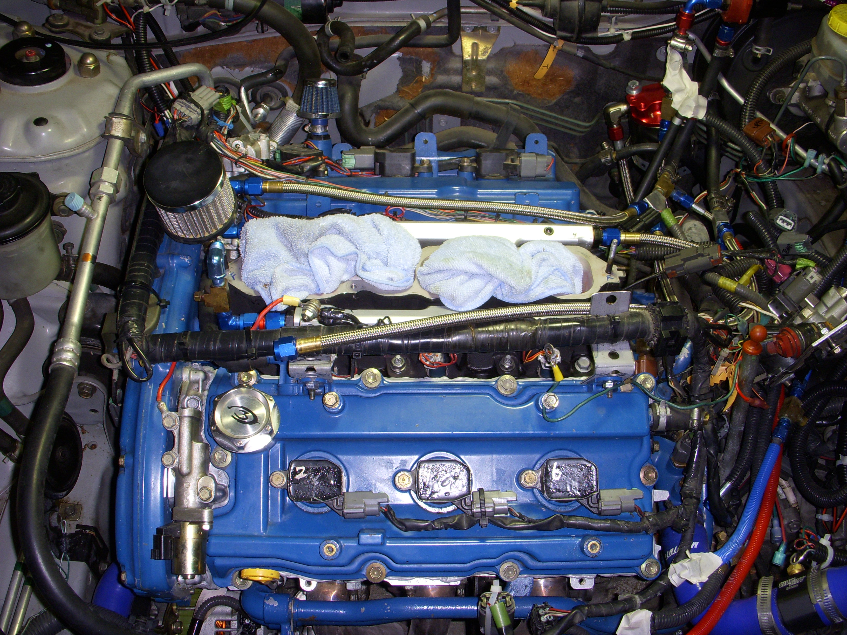

Na - no go pro - I don't seem to have time to mess with in-car recordings. Tried it once, took too much time. I am taking one of our Nikon cameras that has good video recording, 10X zoom, and a class-10 8GB chip. There should be three people there with me on Sunday, so maybe something good will happen - and get recorded. Friday will be a play-day at the strip if everything works tomorrow. I just got five fresh 15lb nitrous bottles and the three more C85 cans.
I just finished installing the new injectors, and just need to finish the UIM assembly and some minor stuff, then pour in the C85 and see if it starts.
Took pix of the front race plugs - they look very good - dark grey upper shell and good fire rings (identical) on the itty-bitty ground straps.
Upper end, ready for re-assembly tomorrow with new injectors.

These plugs have seen a lot of 150-shot runs and still look great.

I took the Shark out for a walk last night, and with the 26N-17F (150-shot) jet combination it pulled very hard through second gear. Not enough highway room for more. The lambda was .83 which is roughly equal to a gas 12.2 A/F. This is too lean for me at this point, so I'm going to step up to 26N-18F and see what happens - maybe this morning, although traffic is heavy in the morning.
We have Issac's rain coming early the afternoon. Chances are that Heartland won't be open tonight, so I can't try the car with slicks tonight if the rain sticks around. I have taken the day off work to get ready to tow to the track, so instead I can finish the fan override switch and a couple of minor chores. Need to pull plugs and look them over.
I also have thought about raising the top shot level a bit - I have some .028 jets which I can try for nitrous - just need to calculate the fuel jet. I have a bucket-o-jets.

Bummer -the rain showed up about 5PM so the Friday t-n-t event was cancelled. I need to get the Shark tuned with this krazy e/c85 fuel. I tried the NX jetting recommendations for 6 stage direct-port ( 26N 17E) and that was a total LEAN fail - same with 18E (about 1.06 lambda). I had just installed .020 F jets, but the rains began (it's STILL raining after 4 hours) so I dunno. I'm looking for a .75 - .80 lambda - about a 11.03 to 11.75 gasoline equivalent A/F. With the GT100 fuel, I had a stable lambda of 7.3-7.4 or so, so that's my goal with the C85. I think it takes more of this fuel than the jet charts know about.
So a .028 is a 200-shot? Is that with 6-port direct spray or something else? just asking... A .031 is the nitrous jet for 6 stages at 225-shot.
Time for a calculator....

If I knew that the heck is going on with the lambda reading I would feel better about the whole thing. I knew that swapping over to E85 was a risk, and I thought I had it working when the runs the first night were lambda .83 - but that may have been with a couple of gallons of the GT100 still in the tank. The stupid car still starts and drives normally very well now.
But using larger fuel jets and having the lambda go UP with spray doesn't make any sense.

maybe your pump isn't able to flow enough fuel to support e85

The pump is an Aeromotive 340, able to deliver a boatload of fuel through the completely rebuilt fuel system, with 6AN hoses on the expanded fuel pump carrier and 1/2" hard lines from front to rear, an Aeromotive 1.500 HP 100 micron filter and 6AN lines to the OBX 350Z fuel rails with separate feeds and returns. There is about 12 gallons of VP C85 in the tank. I have a fuel pressure Cyberdyne digital display on the A-column right at eye level and I see no pressure drop. I don't think fuel delivery is the problem.
I think the next step is to go back to smaller fuel jets and see what happens.

Bad nitrous fuel solenoid ?

Don't think so - a bad nitrous solenoid would make the car rich, not lean. I set up a flow test on the fuel solenoid by connecting the two fuel solenoid wires to jumpers, took off the 4AN hose that goes to the 6-way fuel splitter and added an extension hose going to a bucket, powered up the fuel pump with my small portable battery bringing up the system fuel pressure to 45psi, then jumped the solenoid to the main battery - instant stream of fuel coming out of the solenoid and filling the bucket.. No restrictions here.

Next test - I installed .017 fuel jets and went for a drive. Got room for a WOT spray in 1st and 2nd, ( lambda ~ .9) and a 2nd-3rd gear pull which read as ~.85 lambda. This is much improved, but still has reverse results. The car pulls very hard now. I wonder about .016 jets next...... tomorrow.

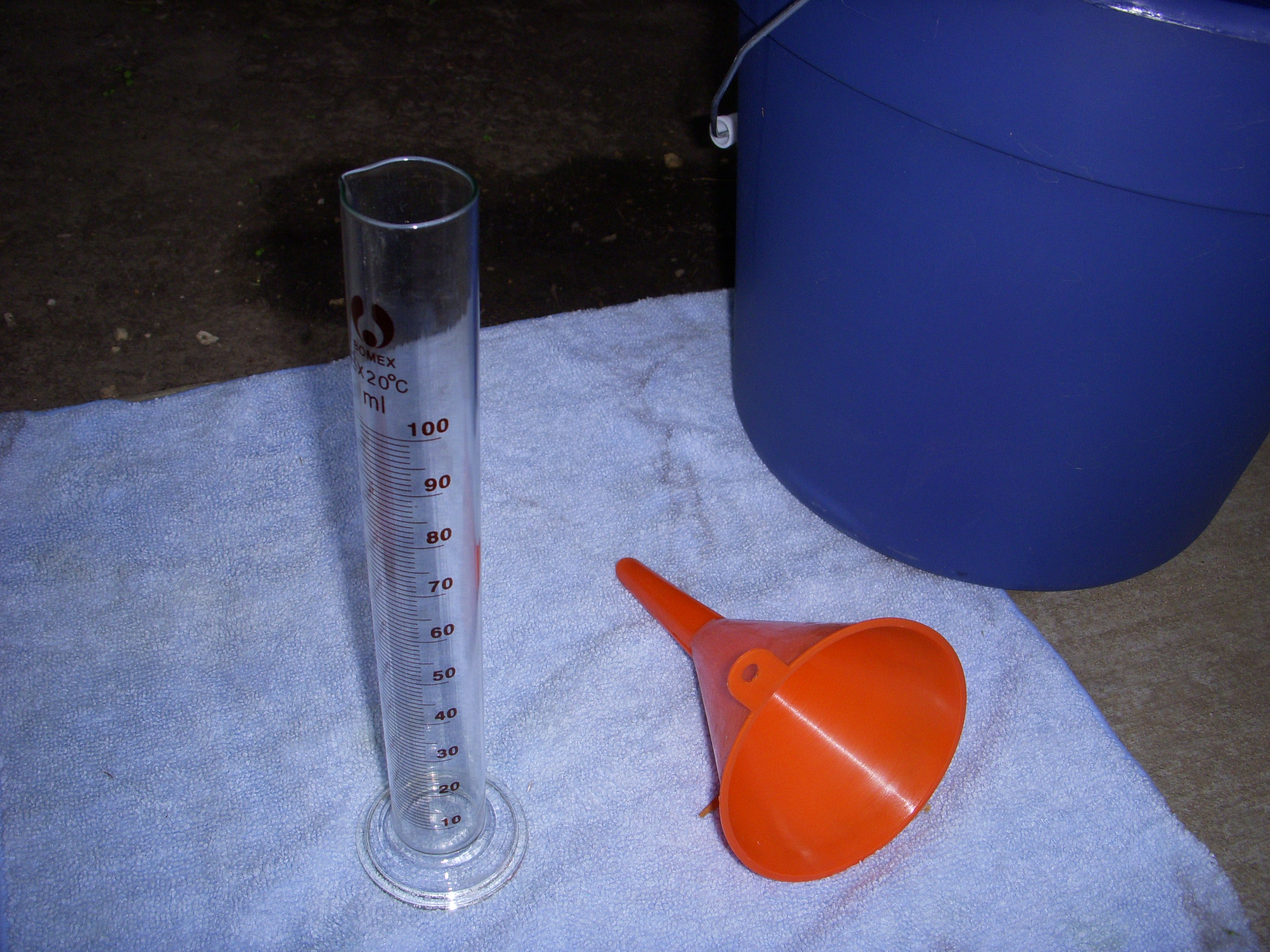

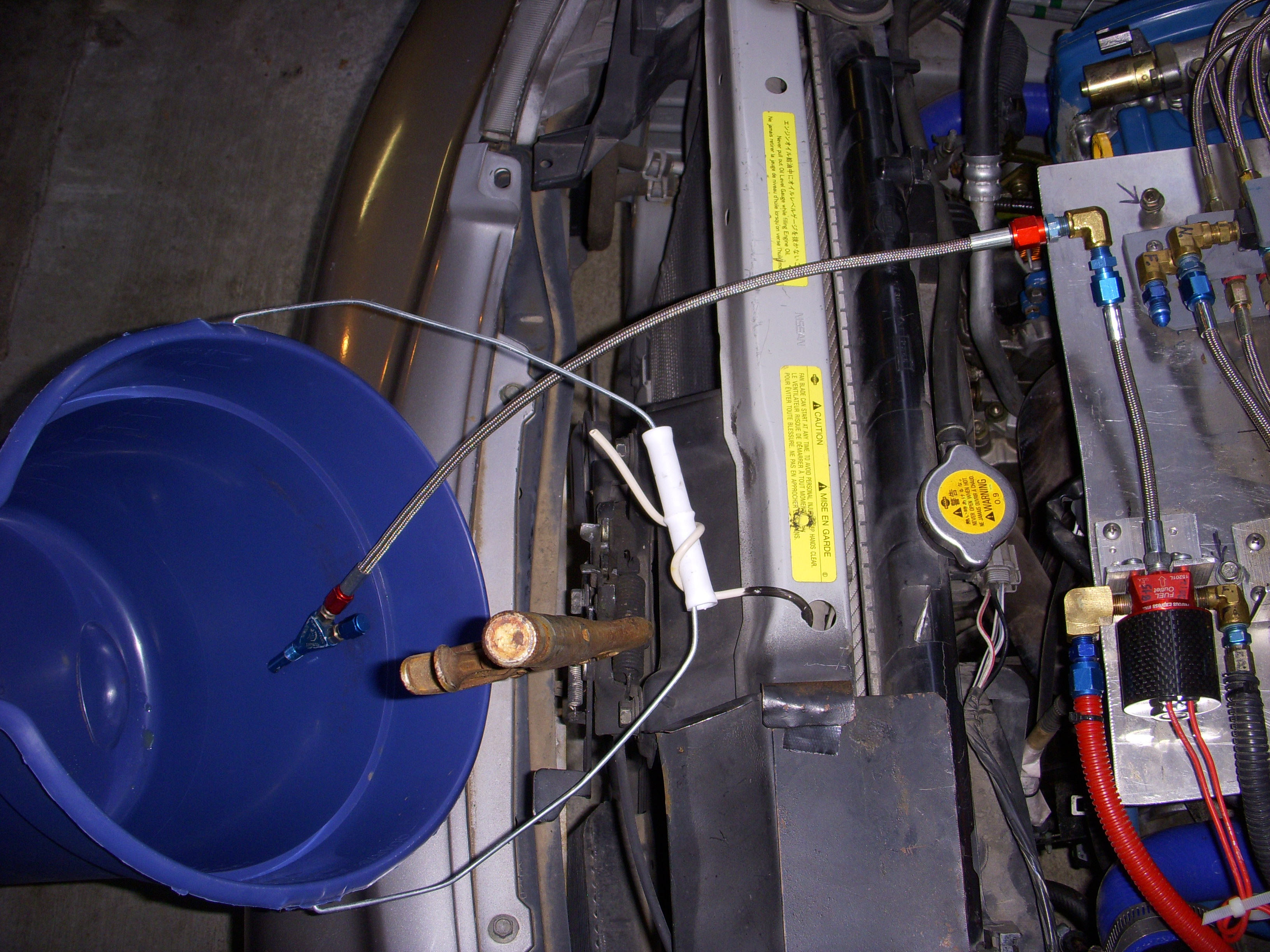

I thought some more about the too-high Lambda while spraying, and it's gotta be something dropping the pressure while pulling 40% more E85 than gas fuel. I set up a test tonight, where I would connect the fuel solenoid to a NX shark nozzle using the largest jet I have - a .062 -and spray just the fuel into a bucket for 10 seconds, then measure how much I collect with a graduated cylinder. Did just that with the engine idling, and saw a 4psi drop on the Autometer gauge on top the Aeromotive regulator, so I bumped that reading up to 48psi which dropped to about 46psi while spraying through the test nozzle.
I poured the E85 in the bucket into my glass tube and there was 343 ml collected in ten seconds. According to other sources, to make 400HWP with E85 takes 621ml in ten seconds, so this was about 1/2 that.
I left the FP at 48psi and went for a drive, cocked and locked. Same thing - pull hard thru 2nd gear with a full 150-shot and the lambda is 1.03 . Car pulls very hard, but still too lean. Hmmmm...
I saw one thing about the Aeromotive 340 fuel pump that made me wonder - the exit port on the submerged pump is OEM-sized and has a check valve in it as well. If there's a restriction, that's where it would be. It looked too small - even used the OEM hose to the exit port. EVERYTHING else in the fuel circuit is at least 3/8" ID - 'cause I installed all of it..
Maybe an external Aeromotive monster pump instead? A1000? I'll look at their web site...

OK, OK - you were right - the fuel pump can't supply enough E85 to go much over 400WHP. I need a much healthier pump for the pushin'... oh, that's a different project.
I've been going over the Aeromotive fuel pump lineup and see several good ones. The A1000 seems to get the most press, and it can mount inside the tank. Thing is, without a lot of constant flow, it could dry out and burn up - unless cutting back the voltage for normal driving takes off some of the load. ??
There are some Stealth pumps from Aeromotive, but they look like installation might be a pain. You know the Maxima fuel tank - what would go in there? Or can I install the A1000 external to the tank and below the bottom of the tank? Is it really self-priming? I could run the A1000 on lower voltage and switch to 13.5 volts when the nitrous system is enabled.
I'll keep looking - I don't want to sump the tank and there should be a better way to suck out more fuel and deliver it up front.
