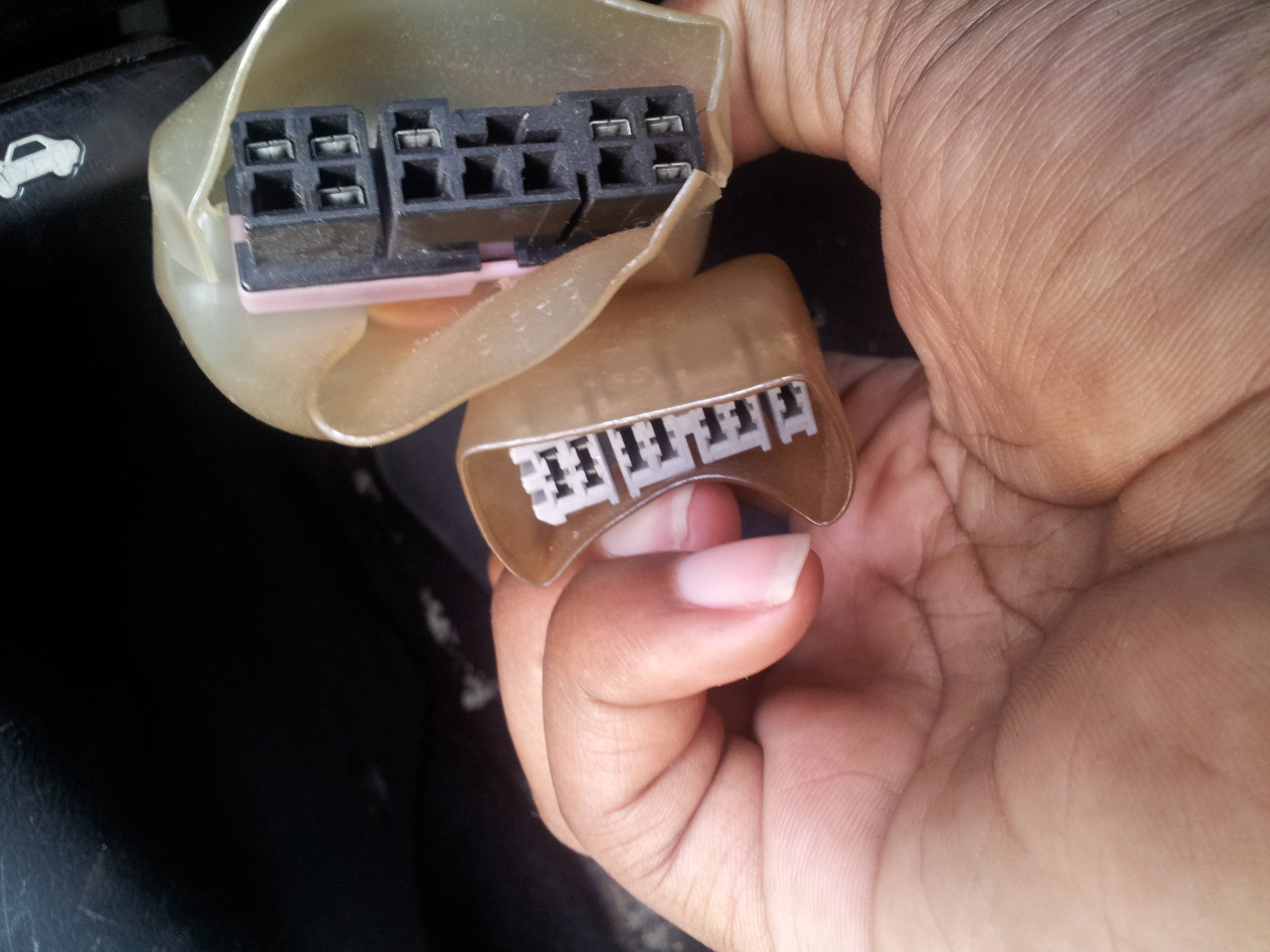

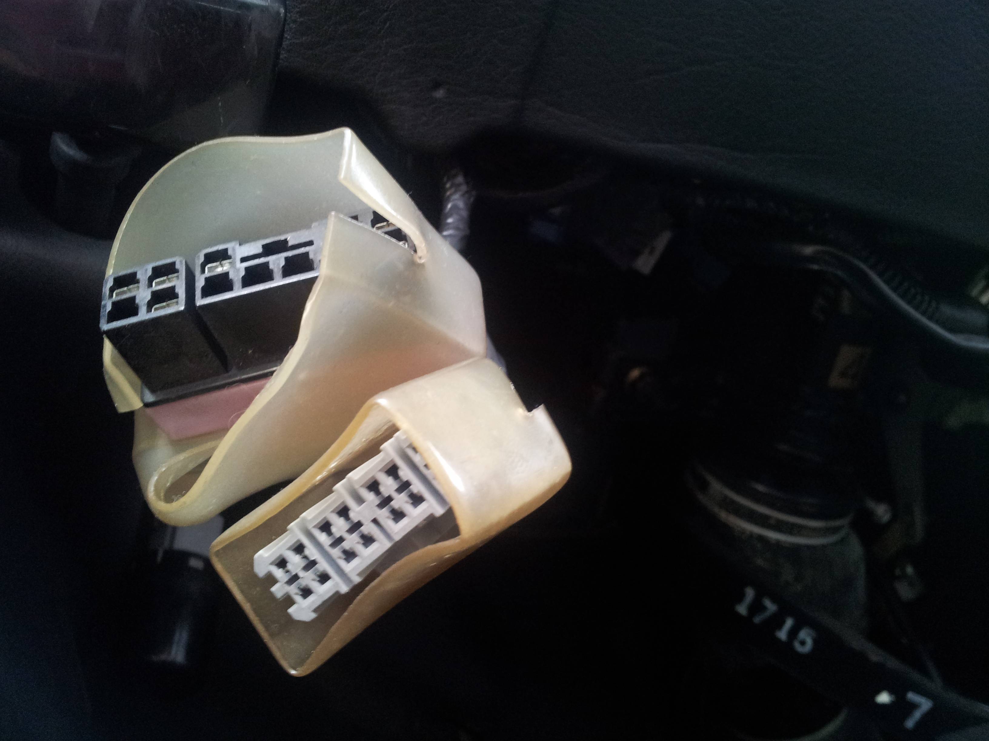

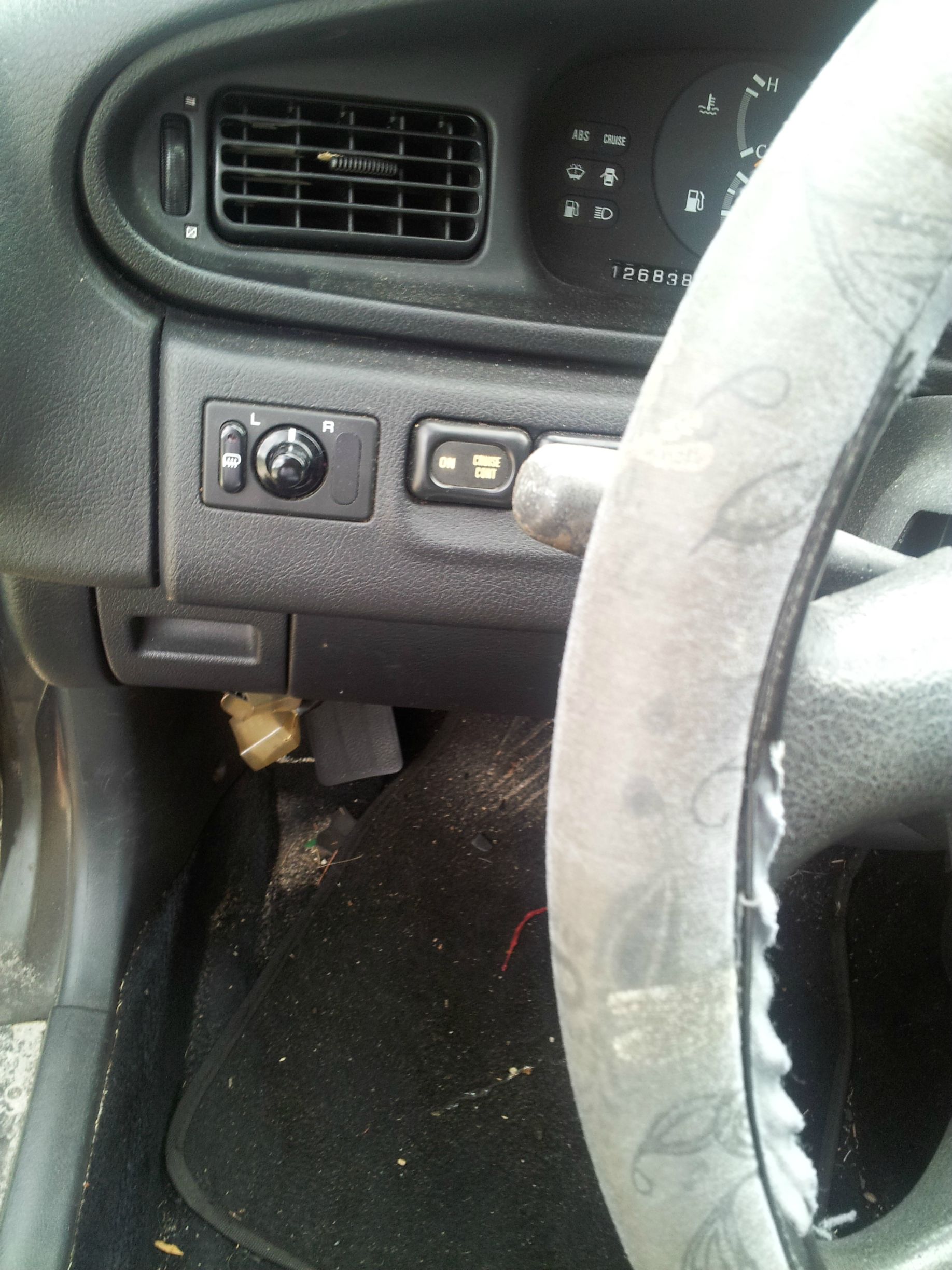

1. -removed-
2. The previous owner had the security system disabled cause the alarm would randomly turn on through the night. I noticed two wire bundles hanging from under the steering wheel on the left near the foot rest and brake pedal. Is that whats hanging?
3. The driver side window doesn't roll up or down. Is there any guides on here on how to put the window back on the track so it rolls up and down again? When i click the button i can hear it trying to work but, nothing happens.
4. The electric door lock and unlocker won't work at all. Could that be from a blown fuse? Sorry if this is a dumb question. This is my first car, and first exp with one.
