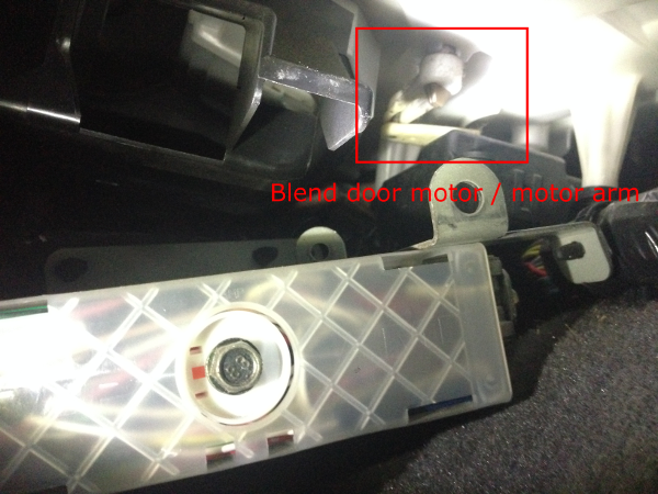

I have a 99 Maxima SE that doesn't have any heat at the moment... Searched through about 6 other threads here at Maxima.org and none of them address my specific symptoms. About 2 months ago the heat kicked on all the time no matter what. Even with the climate control "off" the heat would seep through the vents. About 2 weeks ago the heat died. Gone.
Relevant information about the car / symptoms:
  • I have an automatic climate control system in the car.
  • I pulled the FSM from Nissan and ran the car through the climate control diagnotics. No errors returned.
  • Internal/external temperature sensors looked correct during the diagnostic.
  • Radiator coolant is full / overflow reservoir is at the "max fill" line
  • Replaced radiator last fall, coolant is still clean and clear to a visual inspection.
  • Heat ran solidly (almost ALL THE TIME) until the end of February and then just stopped.
  • I never had the cooling system open to introduce air into it between the time it was working and when it stopped working.
Thoughts:
  • If the system is clogged (which is a distinctive possibility) then why did it blow hot air non-stop for almost 2 months?
  • If the blend door is messed up then why didn't the diagnostics indicate that?
  • If the system *is* clogged then which hose is the input and which is the output? (top vs. bottom) A flush seems like a reasonable step to take no matter what.
Any help would be much appreciated! And thanks to all for running these forums, I've lurked here for some time now.
Every problem has to start sometime, whether you anticipate it or not.
The diagnostic is checking the electrical signal to the various parts. It sends a signal to the air mix door motor and looks for a change in the returned signal from the PBR that is inside the motor. What the diagnostic does not check is the mechanical movement of the air mix door. I think this may be your problem - the link between the air mix door and the motor may have come off.

To verify the operation of the air mix door, get down in the passenger side footwell. It will help if you remove the trim plate that covers the end of the ECU. Then put the key in the ignition switch and turn the key to ON. You don't have to start the car if you don't want to. Change the temperature setting on the heater control panel and watch for air mix door operating arm movement.
Dennis - I finally got a chance to get back to the car last night. Replaced my harmonic balancer :P
I got into the footwell on the passenger side and saw this:
When running the diagnostic routine there is no movement in the arm whatsoever. It doesn't appear to be detached, but I'm not sure how to tell. The diagnostic checks out and does not throw an error.
  • If the motor has failed what is involved in replacing it?
  • If the motor has failed why doesn't the diagnostic report this?
Your photo doesn't work, so I don't know what you are trying to show me.
When running the diagnostic, I have never watched the motor. So maybe it doesn't move during the diagnostic. That seems strange, though. Like I said, I watch it while changing the temperature setting on the control panel.
I think you could tell if the arm had become disconnected. There would be something hanging. My photo is of a 97 Max but I would think the linkage should look pretty much like my photo.
I don't know exactly how/what the diagnostic does things. There is no "behind the scenes" description that I can find. If you had a bad motor, I would hope the diagnostic would report it, but I can't guarantee that.
As far as replacing the motor goes, you have to remove the ECU so that you can remove 3 phillips head screws that hold the motor on. Removing the ECU is kind of difficult, the wire harness is in the way of the ECU screws.
It sounds like you want to go ahead and replace the motor and see if that fixes your problem. I discourage that for two reasons. The motor might not be bad, it could be the control panel. If you read the service manual, it should tell you to measure voltages at various spots to verify if it is the motor of the control panel.
And the other reason (that you are just going to love), is that the motor is no longer available new. It is a junk yard part.
So do the voltage checking and see whether the motor or the control panel is the problem.
Sorry about that! I'm still trying to figure out the board's attachment process. I've switched the photo to my trusty photobucket account for the time being. I believe that I have found the same linkage, though it does look somewhat different.
Did this as well! My buddy was helping me and he saw nothing happen. Perhaps I can just take it in for a diagnosis...
Nothing hanging so far as I can see!
Good to know that it can be done without removing the entire dash!
Bummer that I can't get a new copy of the part. I may have to junkyard hop for it. My friend also tried plugging / unplugging the motor and it didn't seem to have an effect. Perhaps I can find a better youtube video for diagnosing this door!
Thanks so much for your advice. I appreciate that you take the time to trawl this old thread and care for us noobies
Your photo is the air mix door that we have been discussing. The difference in the arm position is probably that yours is in the full heat position and mine is full cool position.
If you decided you had nothing better to do and you would remove the dash to change that motor, you would be very disappointed to discover that removing the dash is absolutely no help. I found that out the hard way. Learn from my mistake and DON'T DO IT!
