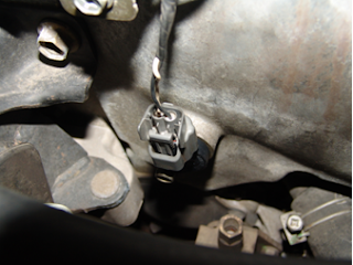

Originally Posted by DamSedan
P0340 - Camshaft Position Sensor (Phase) Circuit (Bank 1)
Ok,
Basically, the car died on me after going around a left turn from a stop light. I coasted about 200 feet, got the car into neutral and turned the key. It fired right back up but of course I had a bunch of lights flashing at me. I was right at the entrance of my neighborhood luckily. Unfortunately, I did not have alot of time to play with it that evening so it pretty much just sat in the garage. Then yesterday I ended up having to drive it before playing with it again. Low an behold at about 65mph on the highway on the way to a dinner with the wife, the car tried to shut off again. I think the only thing that kept it going this time was the speed but who knows. Once again, the TCS light and Slip lights came on and the SES light was already on. At this point be had been driving for about 40 minutes and had been on the highway for at least 30 miles of that. I mean, this is coming out of the frickn blue here!
A buddy and I scanned it today and see what it was. I then double checked the connections and wires as far as I could and they all look good. We even cleaned the connection points. I have read through the forum here and have see a few things but no real answers to the problem.
Honestly, the car runs strong. It is an 03 I35 and has about 90,000k on it, new belts, plugs, packs all checked out, just changed the oil two weeks ago, new brakes... I just don't get it. The last thing I want to do is to start chasing a problem and dumping money into it. That being the case, I would rather just buy a new car! The only performance mods, if that is what you want to call it is a cai and springs.
My car just had this problem!! Sorry to bring back an old thread! It died 2 times on my way to work this morning... How hard is it to replace cam positioning sensor? Would I be able to get one at pep boys or just from the dealer?
Thanks for the help

you can buy the sensor at autozone, same one as at the dealer and it costs less. There are two sensors the one on the timing case cover is simple and the one that fails the most, its simple to replace unplug, take out one screw pull out old sensor, put new one in, reattach screw, reconnect the plug and your done, five minutes and your done
