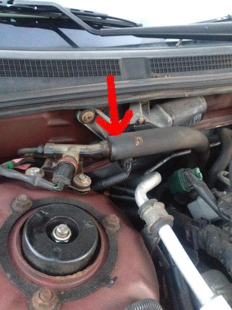

Update:
First of all thank you all for the help. I got under the car and the motor mounts looked ok. Also the strut mounts look good. Got on the engine w the hood open while the car was driven to bumps. No movent on the center nut. I did hear the noise and its definally coming from the bottom. I even put a block of wood under the oil pan and jack it a little to see if it moved but didnt. So i think the motor mounts are good. The only thing i saw that looked bad is the front part of the lca with that big nut sticking out. Dontk how its called so heres a pic. Cant really see the damage but on the inside of it looks kinda shreded. So i guess ill start by replacing lca.

Can someone tell me what this hose is? Or where it comes from / leads? I've been having problems with my car shutting down a lot lately and while searching around under the hood I noticed that there's been something leaking from this spot, not sure if its any part of the problem but I'm sure it wouldn't hurt to have it checked out and taken care of. Name:  leak.jpg
Almost looks like a A/C refrigerant line. Does it go into the firewall?

I think that is a high pressure power steering hose.
Part number :866-941-2048. Cost a little over $150 from Nissan. You can buy after market for less but from what i heard the power steering noise is louder with after market hose.

Ahh okay, power steering hose sounds about right because I have had to add power steering fluid more than often. Thanks!
