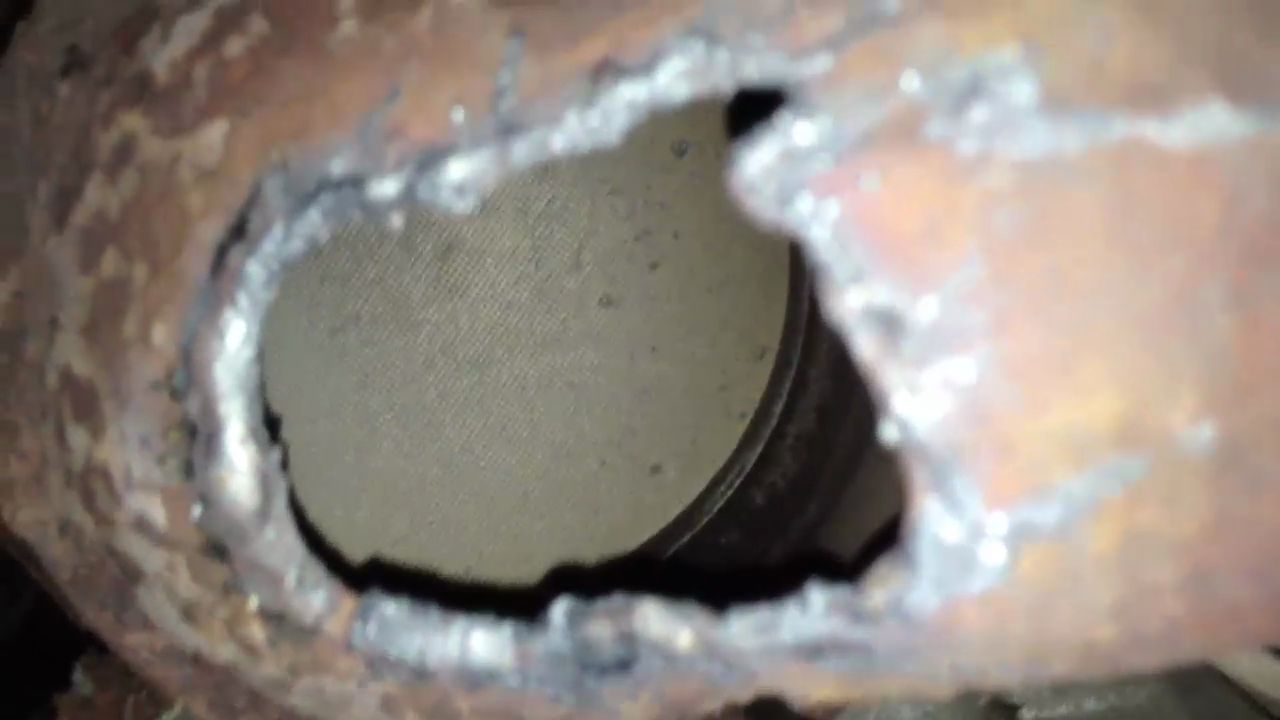

Hi! I was about to gut my front precat but the mechanic guy say its was ok no need to gut dem what you guy think I upload two vid of the front one and firewall side thank!
Front precat:http://i1058.photobucket.com/albums/...3/abdc56c8.mp4
Firewall precat:http://i1058.photobucket.com/albums/...3/825b1506.mp4

Why were you going to gut your precat?
Strong rotten egg smell the mechanic guy say its was my precat we check the main one and the inlet honeycomb mesh was half Ripped but he say we can see the light spot inside so it's good the car run pretty good just a p1147 that come and go I didn't take a pic of the main cat but if the honeycomb don't stand where is suppose to be that mean its not good anymore? And it make some rattle

That code is for a sensor, not the precat.
If the precat is shot, replace it. It's a $200 aftermarket part. I'm assuming you have an 00-01 Cali spec?
Also, please start proofreading and using proper punctuation. It's very difficult to read what you're saying. Help us help you.

Ok its a 02, sorry my English writing is not good I am French spoken I try my best thanx for the answer.

I would start with replacing the bank one secondary o2 sensor.
