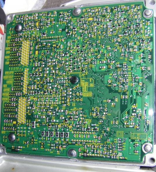

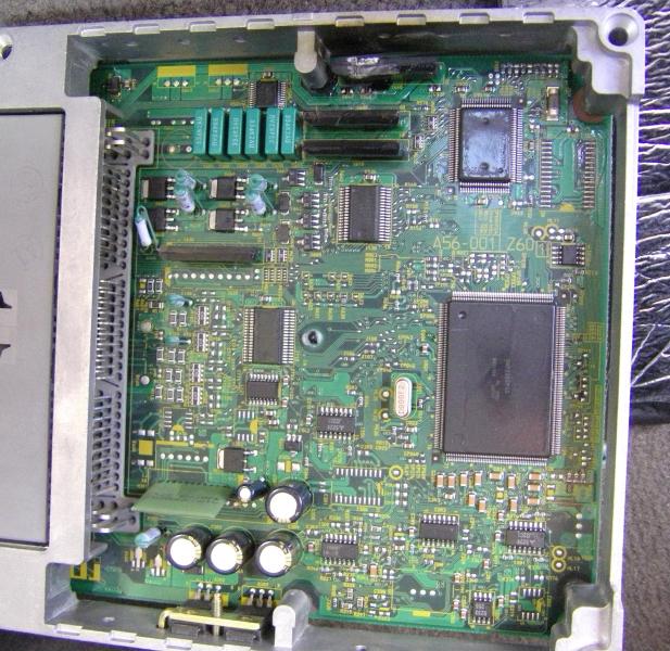

New problem? ECU components burnt but still running
Hi,
I have an 01 Maxima that just stopped and had to coast to the curb. There was an electrical smell. The car would not restart. The RAA found a blown number 2 engine continuity fuse and suspected the ECU so it was towed to the auto elec. They replaced the fuse and the car ran fine. When I asked about the RAA guy's suspicions they looked further.
The diagnosis: burnt out components in the ECU but no idea what caused it. No codes showing. Claims he can't test for shorts and that ECU's blow on their own all the time. Can't tell me what components are burnt. As the car was running we brought it home so that we could investigate further as I didn't feel comfortable with what I was being told and quoted and that the replacement change over ECU would only have a 30 warranty.
Anyway after hours on the net and in this fabulous forum I have more confidence in you guys than the auto elec who didn't even know that manual Maxima's have electronic motor mounts.
I would love some opinions on the burnt components in the ECU and see that some guys on here have had their ECU repaired in America much cheaper than in Australia (quote $480).
My man has worked out the electronic motor mount plugs and has disconnected them.
Sorry I don't know computer well and I hope the photos come up.

Originally Posted by ihk777
Attachment 4691
Attachment 4692
Hi,
The blown chip is the motor mount mosfet, so you did the right thing disconnecting both motor mount plugs. Since no other damage happened due to the motor mount mosfet blowing you don't actually need to repair anything, the blown chip isn't being used now that you disconnected motor mounts. What sometimes happens is the current surge that blows the motor mount mosfet can also damage the IACV mosfet (the one near the connector) but since you don't have any SES code and that part looks ok from what I can see in the pic, you are probably ok as is. I suppose you could remove the blown chip just to make sure it doesn't cause a problem later but on the other hand if things are working why fiddle with it!

Hi Plim,
You have no idea how happy I am to have someone who is knowledgeable take the time to have a look. It is greatly appreciated. Thanks a bunch.
Your identifying the component gives me enough confidence to now drive the car and save $$ potentially by not doing what the auto elec recommended.
What do you think of the auto electrician's comments? He said no codes came up, that he couldn't check for shorts and doesn't know what the components link to? Are these reasonable responses from a qualified auto elec who doesn't specialise in Nissans?
Thanks
Attachment 4691
Attachment 4692
Hi,
in general blown mosfets are nothing new, usually caused by and heat or cheap components.
Attachment 4691
Attachment 4692
Hi,
The ECU doesn't "blow on their own all the time" as you were told. It is either the IACV shorting out or the little electric motor on the motor mount shorting out.

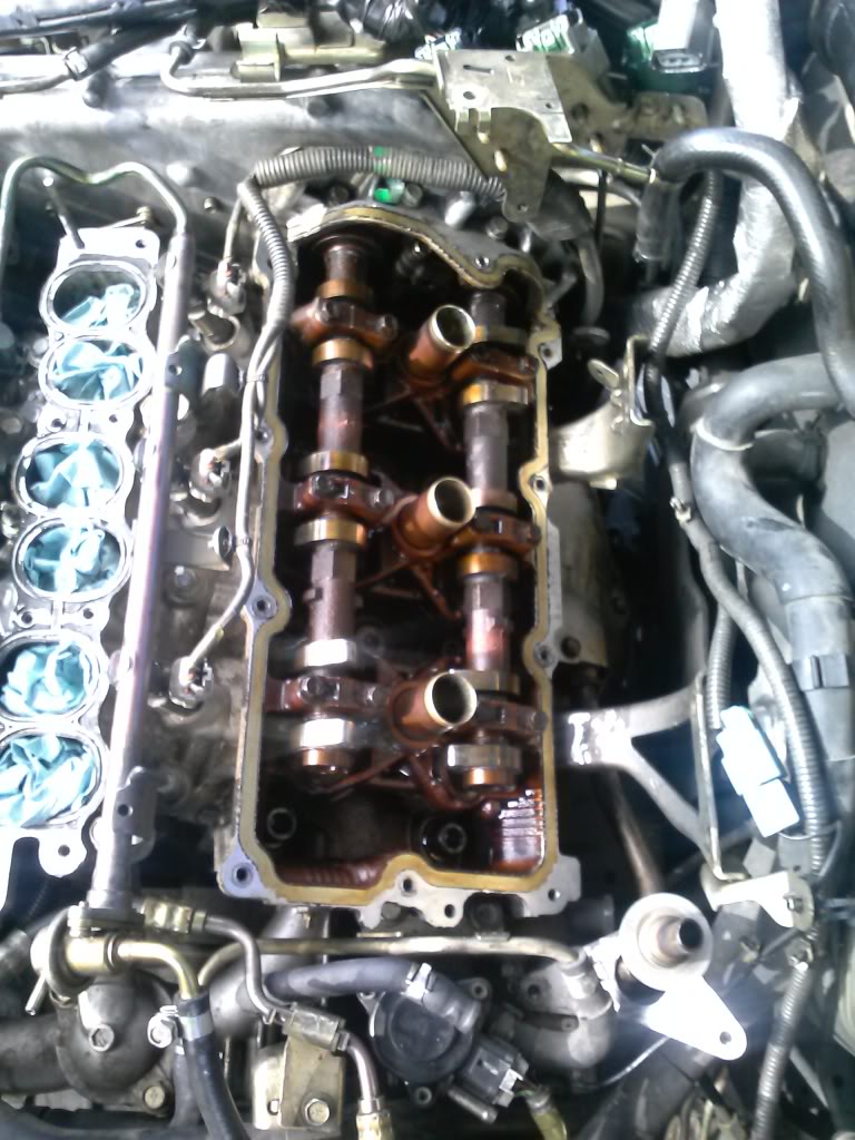

Size:  134.4 KB is my car missing the knock sensor
