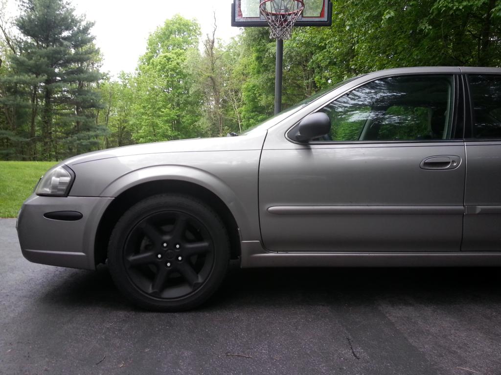

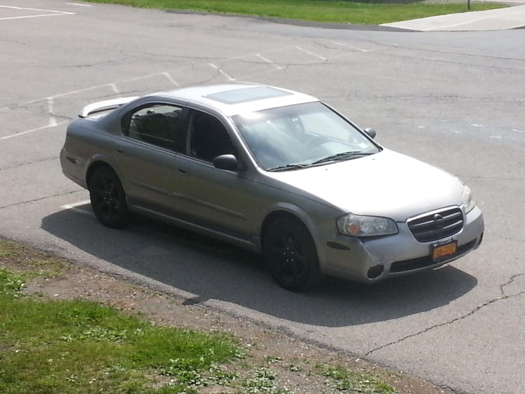

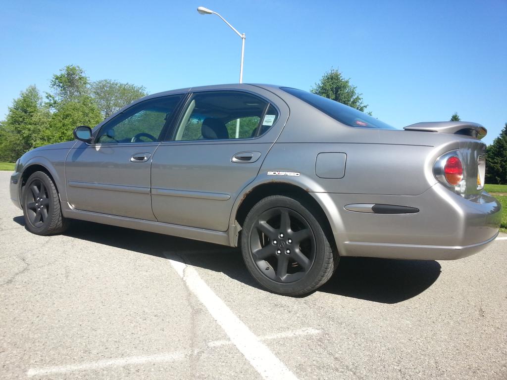

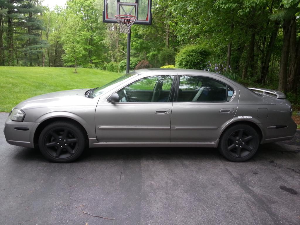

Ive seen people ask what black rims look like on a Maxima.
Well here you go...
(Pictures in order from oldest to current)

After:
I also did the grille, tinted fog lights, side markers, and side mirrors and replaced the lug nuts with white ones
