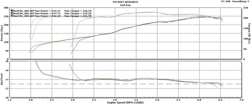

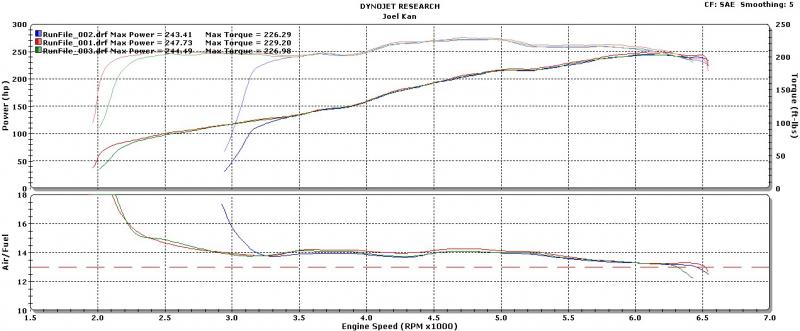

Here's DatDude20's dyno with torque, AF, etc.
Just a footnote - I'm also almost certain these runs were done in 3rd gear.
I've attached it too in case the picture doesn't come out right.

Not an expert with dyno graphs yet but isn't a 14 A/F way lean for untuned headers? I thought they make the car run rich, this is the opposite. And what's with the tq? Seems a bit on the low side.
I know I'm running rich at the moment since I'm untuned with my Cattmans, I can smell the fuel from my exhaust.

I noticed the a/f earlier too, I think he is running a gutted cat iirc too so not sure whats up with the ratio. The TQ maybe off from the gear he dyno'd in but I gotta believe he had them dyno in 4th. Also note that peak power doesn't come till 6.25K.

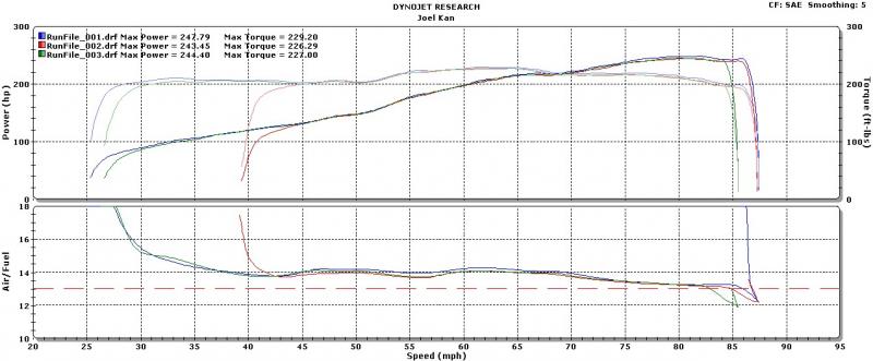

Look at the same graph below but for the bottom axis changed to Speed instead of RPM - it only hits about 87 mph at redline. If he was in 4th, he'd have hit about 115 mph at redline. Even the gear ratio numbers are nowhere near what a 4th gear run should be.

Yeah, you are right. I never paid attention to that before, I think that was the first axis I changed to rpm when I opened the file. Does that explain the tq numbers at all and the peak being so far to the right? Even with other SSIM cars Ive seen they still peak around 5.5k and plateau.

I'd think anyone with the stock IM would peak around 5500-5700 rpms or so while the SSIM equipped would peak at 6000+ rpms. At least, that's what it appears from the small sample of runfiles I have.

Where is the 52xx hp/tq cross over?

That's probably because I didn't use the same scale for the left and right axis. I can repost that later when I get home. Or I can email you the runfiles and you can do it.

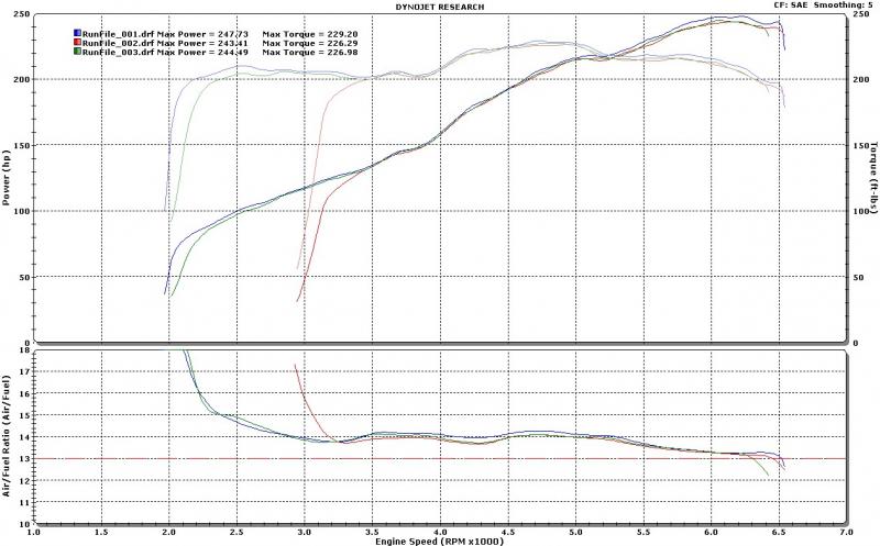

Okay, only because I like you Kev.

Doesn't the winpep software compensate for which gear the run was done in? I know that when I post my old dyno runs with the stock 6mt, and then put a new run into the graph with the 06 6mt I get a little box popping up telling me that the ratios are different. IIRC the guy who did my dyno said it doesn't really matter which gear you run in. But most people prefer the 1:1 ratio because it take a little longer for the run. A first gear run would just happen too quick. 4th gear at 1:1 or closer gives you more curve to look at

You could be right, but I didn't find a definitive answer, which is why I was holding the comparison back. WinPEP will show the gear ratio, but I'm not sure what it does to compensate, if anything.
