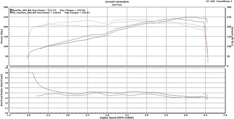

If you guys want to see datdude20's 3rd gear dyno vs. my 4th gear Cattman Gen II dyno, here it is:
His curve is in blue, mine is in red.
I'll let y'all comment first.
My mods were GAB, Cattman Gen II headers, Frankencar b-pipe, Megan Racing rear section.

The HP difference indicates a nice parallel advantage for Cattman. Torque? Can you believe the gap @ 3500 RPM? Incredible difference.
The apparent top-end advantage of OBX is very short-lived.
Advantage: Cattman.

SSIM vs Non SSIM man. I've seen TQ #s lower in 3rd vs 4th gear on a few cars too. If the Cattmans made more power great, they should they are 2x the price of the OBX and a great product from one of the most pleasent sponsors on the site. But like it or not the OBX headers still proved to make great power for the money.
Bang for buck?
Advantage: OBX

Pretty much. Everything else being equal, an SSIM-equipped motor will make less torque below close to 6k comapared to one with a functioning VIAS. Says nothing about the headers unfortunately.

Yeah, I admittedly didn't realize that until I searched and found his mod list, which is when I edited my post. Maybe I need to do some runs with a SSIM too then. Anyone got a Sawzall I can use this weekend?

he is going to have they advantage cuz i have the ssim which causes me to loose TQ ....but gave me better top end and peak power....

I wouldn't call that an advantage. You having the SSIM makes this comparison pretty much invalid. I'll see if I have someone else's run files we can use to compare against yours.

HP is a function of TQ, so that still doesn't show anything or any advantage.
Yes, the Cattmans are showing more torque and more area under the curve, but the torque loss effect of the SSIM makes yours a completely different set up. Like nismology said, we can't compare the two headers because of that.
The only thing this comparison shows is that you need to do something to properly take advantage of that SSIM.

your right.....the only things i can think of is pulley and a flywheel......but pully and ecu is next on my list of thinks 2 get....they will be here soon....
