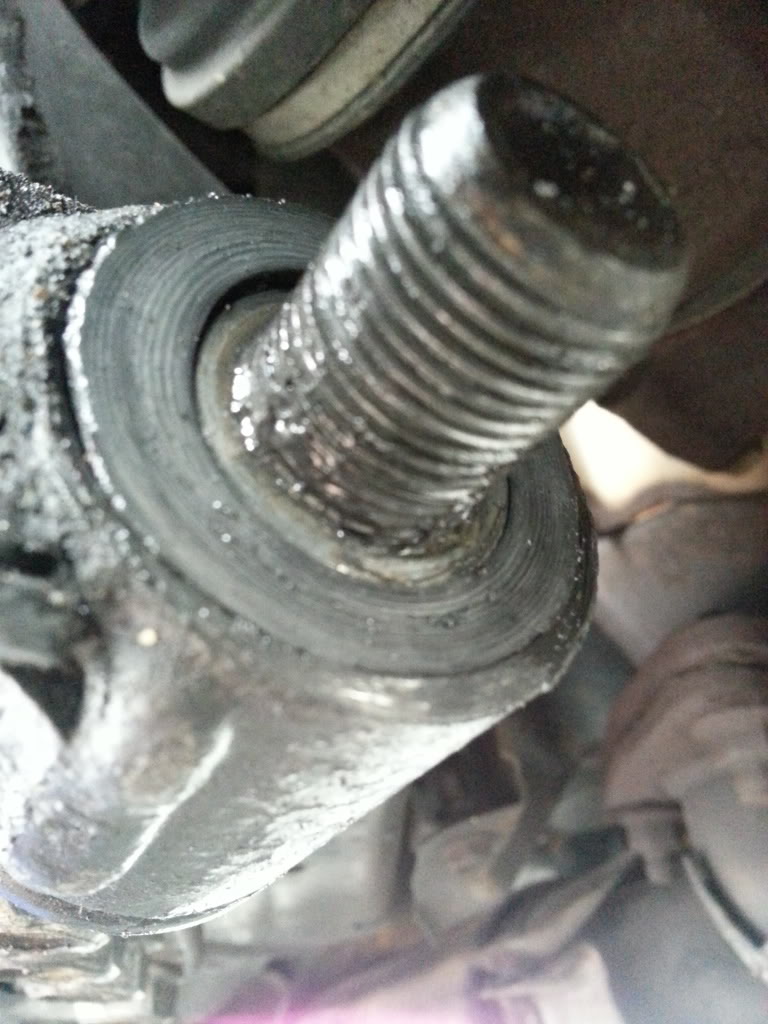

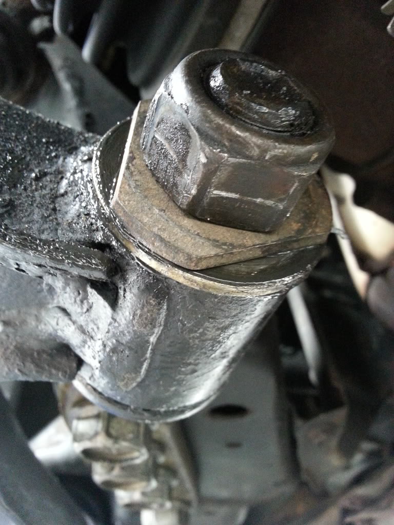

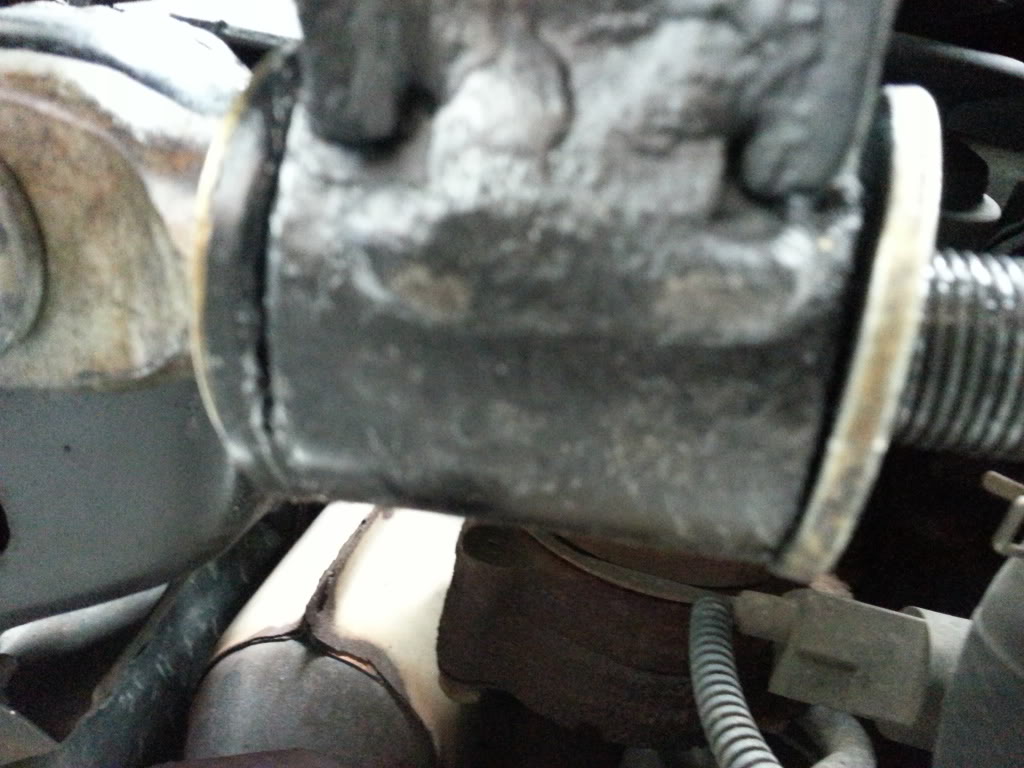

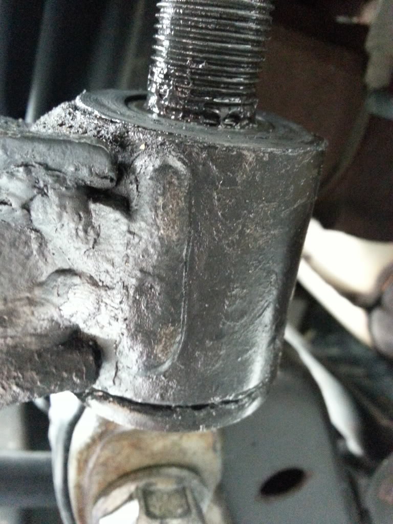

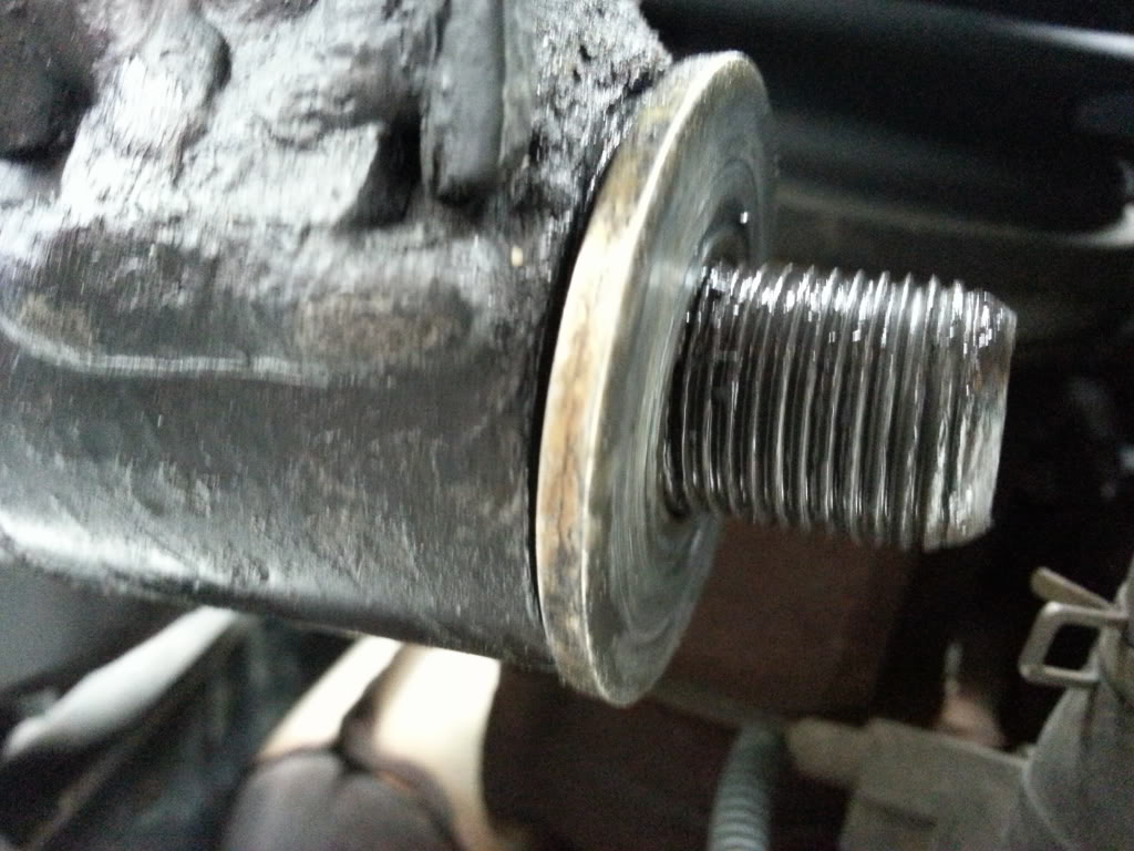

Ok i just did this and noticed something odd so i need ur expert opnion heres some pictures
The small outer lip of that bushing
came off the front part

Rear part still has the lip

Gold washer in front now touches the metal
I put the triangle washer like u said to
The same bushing on the (opposite)driver side of the car has both lips and doesnt creak.
Is this the source of my problem creaking? Is that ok and normal? what should i do if creaking returns?

So...is the creaking gone with the triangular washer? You never confirmed.
If so, then you answered your own question, no?
Where did the lip of the bushing go? Did it break off? Did it get worn down? Maybe it just got pushed in...
I've never seen this before. It's hard to believe/understand because poly is fairly tough.
If the creak is gone, then problem solved. If it's still there, you need a new bushing, or, your current bushing needs to be adjusted/popped back out.

The outer lip got sliced off clean. It seems the washer pressing against it sliced it off, funny. I just put the triangle washer today so ill see if it starts again usually takes a rain storm or two to start creaking again.
How can i get just this one bushing?
