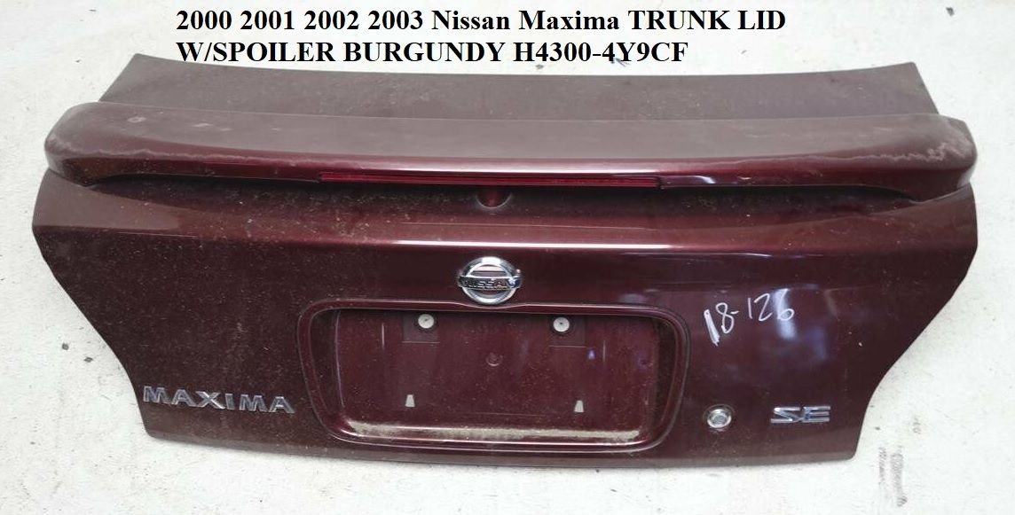

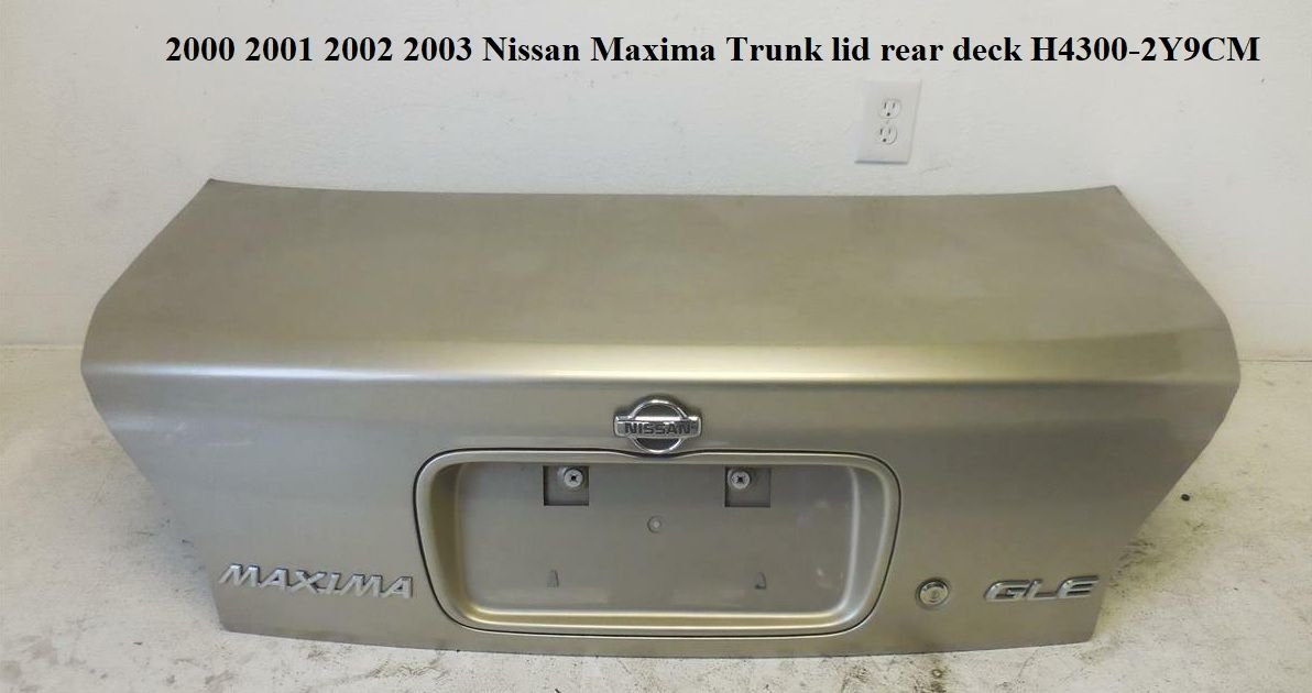

The best manner is to purchase a used Maxima GLE Trunk Lid. Usually these used lids come with the wire harness for the License Plate and other trim hardware.
On eBay is rather expensive proposition, however, visiting a Salvage Yard (one that is pretty large and has plenty of Maximas) would yield the best of what you are trying to accomplish.
A careful study of the Factory Wire Harness is what entails here from your Sport Version Lid with the Wing and that of from a GLE without Lid Wing. Like someone else who already posted, the hardness that goes to the wing, if supplied would have to be re-routed back inside the vehicle and up at the rear deck and you might as well get a used Rear Deck Brake Light assembly from a GLE.
Here are two pictures showing what is being discussed here. One with a Wing on lid with Brake Lights on the Wing and the other picture showing you a lid without.
