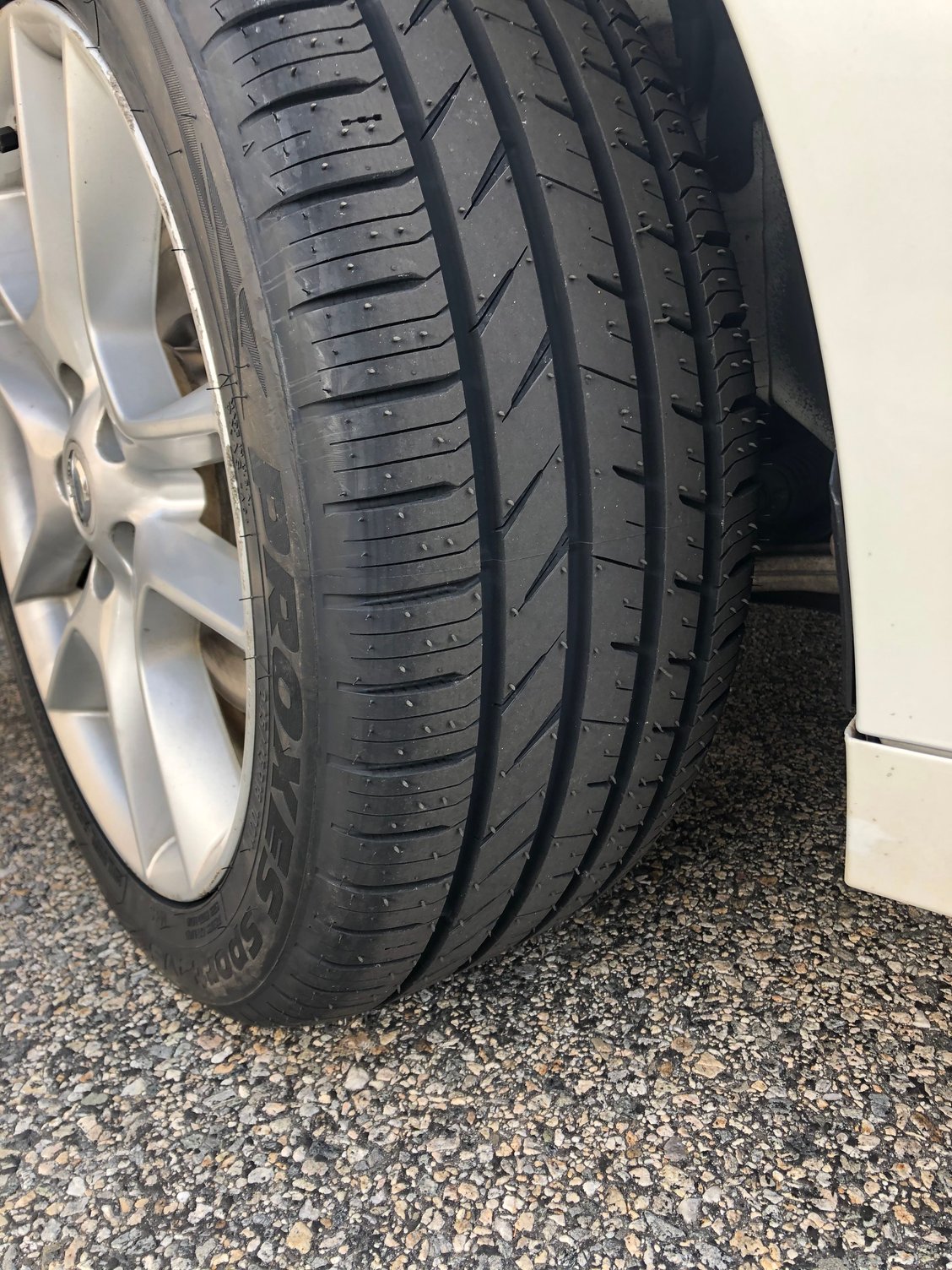

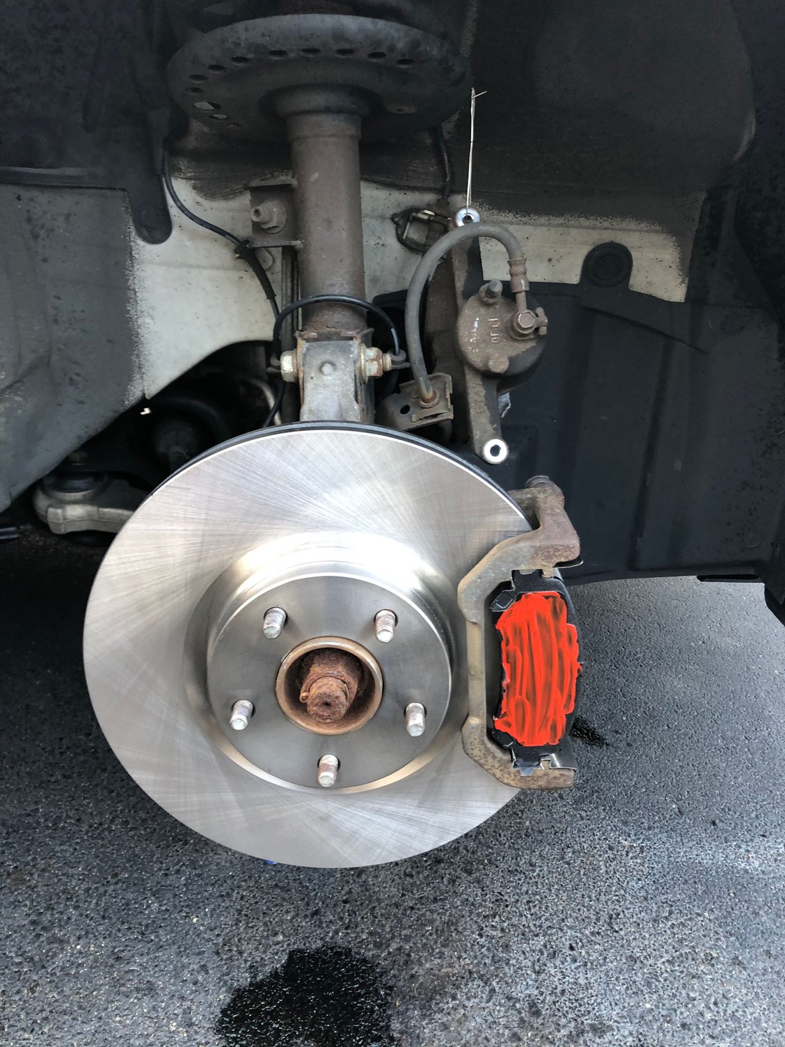

So today at 147,500 I Had drained the cvt fluid and replaced the o ring, new fluid 5 quarts of the ns2. Added Toyo proxy’s sports a/s and all new brakes and rotors all around

It wasn’t too bad last I know it was changed at 50k but it looks like it was done at at least 100k but can’t be positive so if 50k was the last time 100k is pushing it from what I have learnt. It is driving better but I’m going easy on it for the first 100 miles or so. My girl has a max also and hers feels like it has a little more go to hers than mine does and has a bit of a louder rumble to it but can’t figure out why. When I picked the car up going 60mph the front end would shake like a leaf, rotors were warped, tires were pretty bald esp the insides, so I replaced all that and 90% of the shake went away. I installed spacers and the shake was worse than without the spacers so I took them back off, I check the tie-rods they seem strong so I’m going to assume the ball joints must be worn out. I hope that’s the last fix and can start to enjoy it lol
