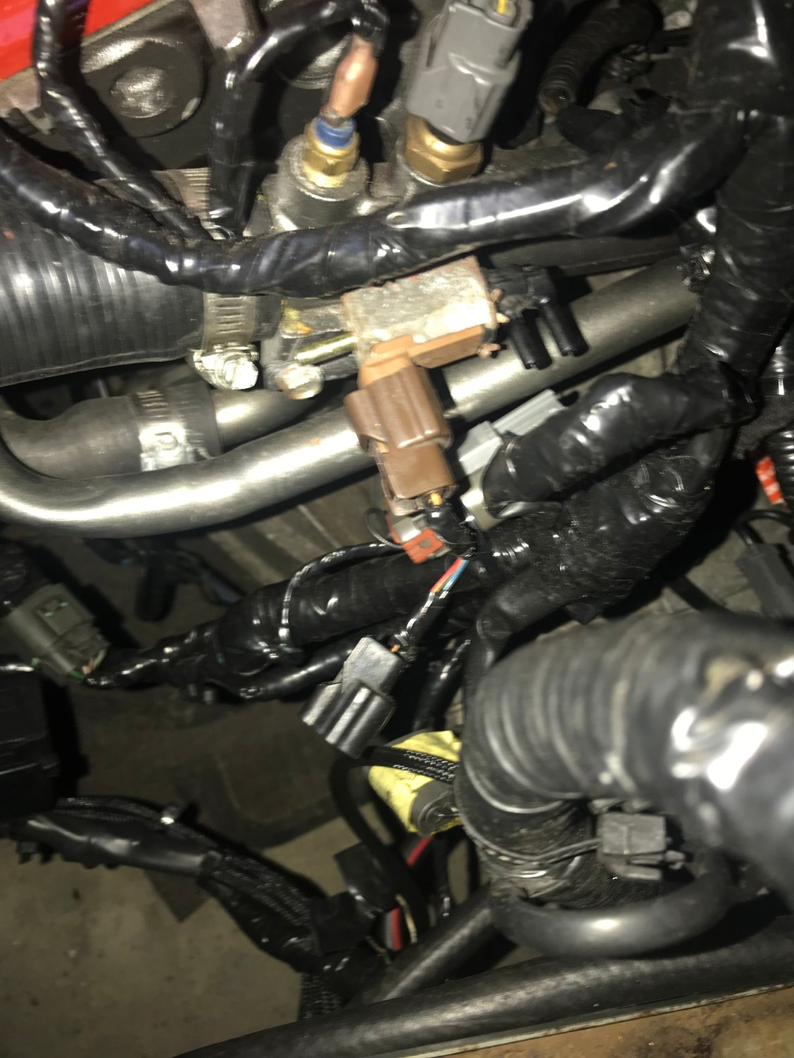

I realized 2 things.
1- the green plug is just sitting in the bay. I only have now the brown solenoid plugged in.
2- the brown solenoid wasn’t plugged in either. Now it is, are the Green and Brown solenoids the same or do similar things?

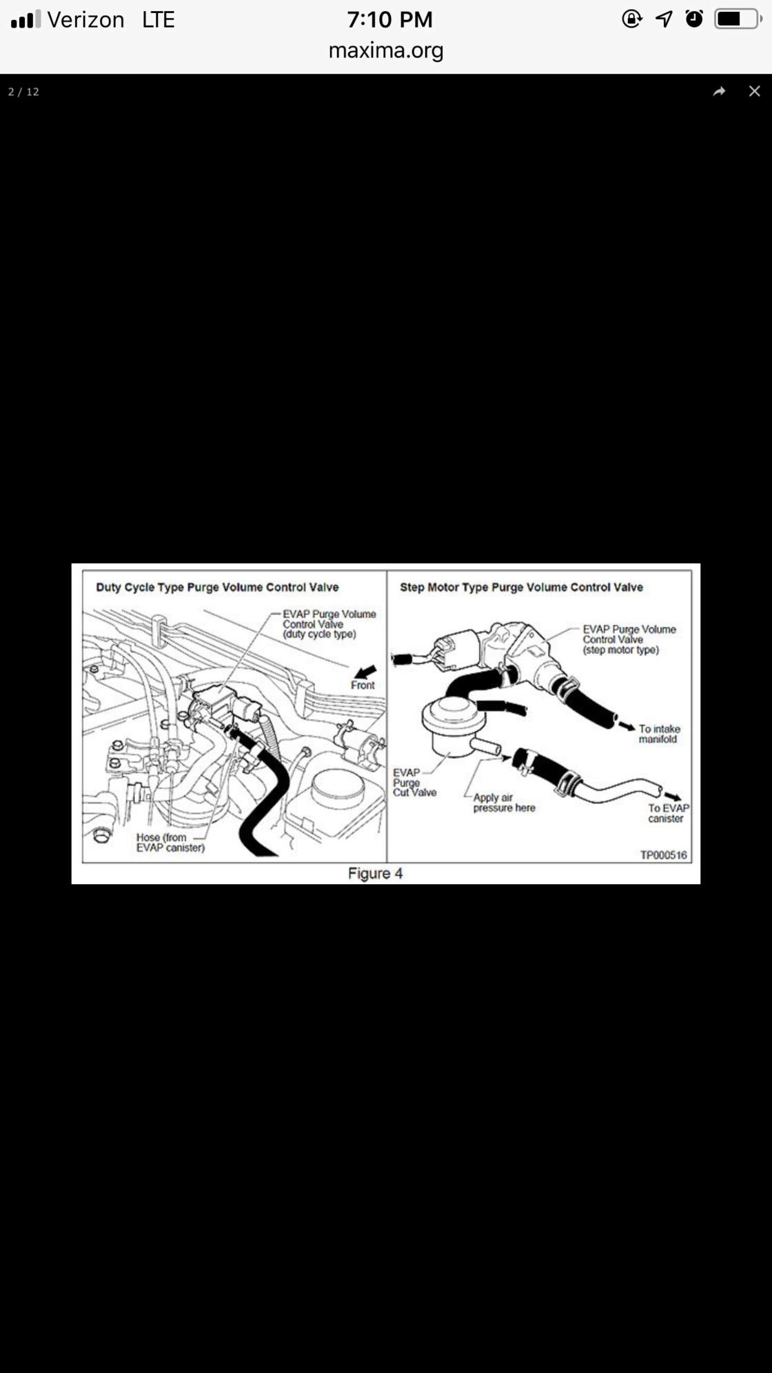

95 fed spec uses a simplified EVAP and EGR layout, no stepper motor. Less sensors and more mechanical in operation. I have a diagram somewhere.
Old Oct 9, 2019 | 08:48 AM
  #50
RA030726's Avatar
I'm nutty for Nissans
Posts: 9,311
Old Oct 9, 2019 | 08:49 AM
  #51
maxprivate's Avatar
Black Lion
iTrader: (12)
Joined: Sep 2005
Posts: 2,671
From: NJ, Down by the River
Cool let me see if you could. I’ll take a pic of my ecu and post it later.

You can trim the tabs off the solenoid to plug in the other connector. You don't need 2 solenoids on the fed spec.
Old Oct 9, 2019 | 10:53 AM
  #54
maxprivate's Avatar
Black Lion
iTrader: (12)
Joined: Sep 2005
Posts: 2,671
So the brown or green one will do the same thing? You’re saying, Trim off the tabs on the brown solenoid and plug in the green harness plug to that?
Old Oct 9, 2019 | 01:25 PM
  #55
RA030726's Avatar
Posts: 9,311
I always assumed they operate the same, just plumbed differently. They open and close, connecting 2 ports to a device depending on what the ECU says.
They color code them so they don't get mixed up and they change the offset of the tabs so you don't plug them in wrong. But that's so stock stuff for the layman. Obviously this thread isn't about being stock lol.
Test that solenoid so we don't have to guess. Also I can't tell you which connector goes to the ECU. A 95 wire harness is different and wouldn't have the extra connectors.

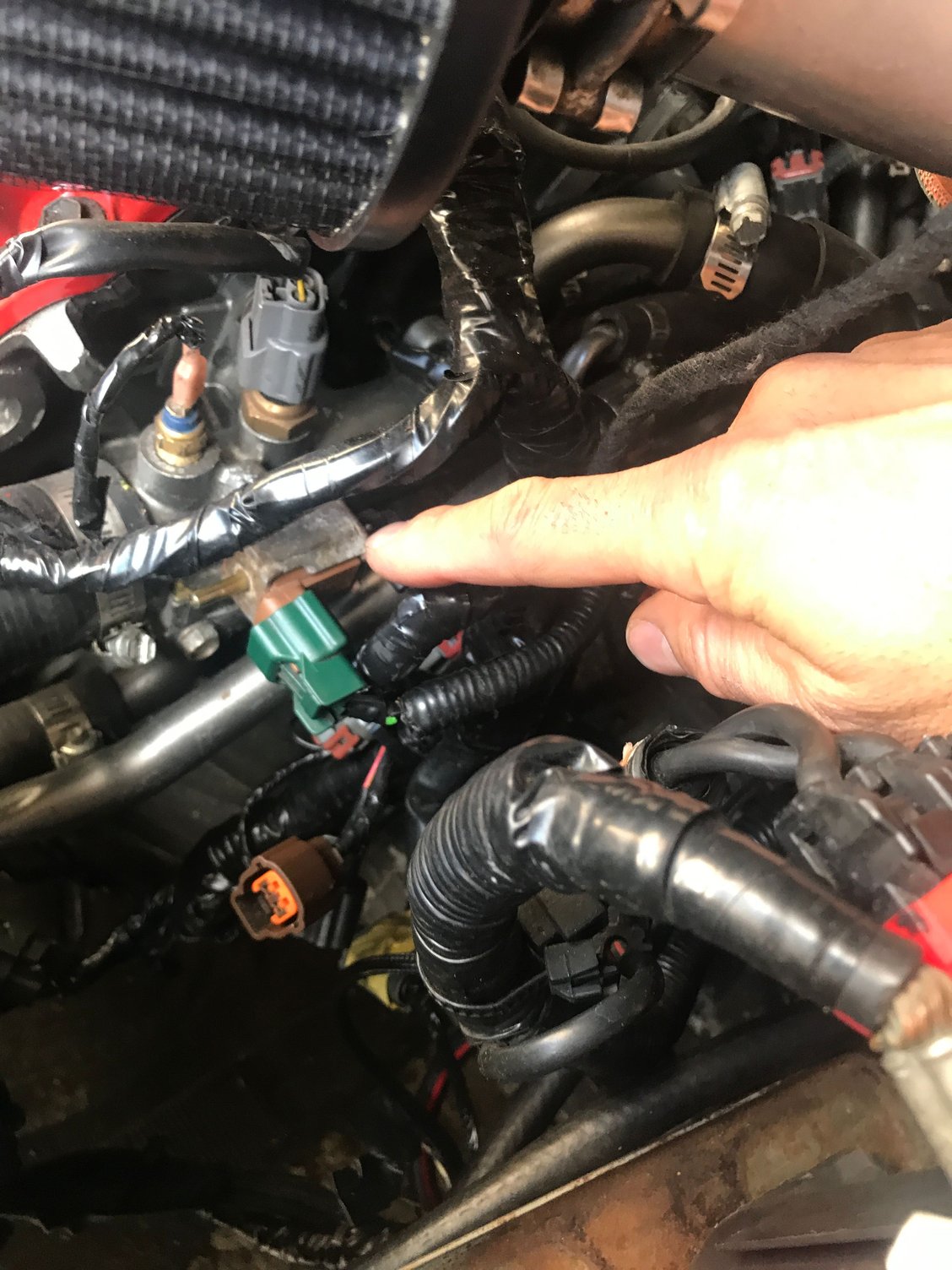

Yea lots of extra plugs left over from auto. The green connector in the photo I assume is for the EGR solenoid. I’ll check for voltage at the green harness plug. I should read something if it’s opening the solenoid. I’ll aloe sure the brown solenoid works.
Old Oct 10, 2019 | 01:51 PM
  #57
maxprivate's Avatar
Black Lion
iTrader: (12)
Joined: Sep 2005
Posts: 2,671
Green plug in brown solenoid
tested the solenoid and it works. Not sure if it matters if the green or brown one is used. I had to shave a part of the plastic on the solenoid to get the green plug on. Hopefully that will do it.
Does anyone know how to trick the Egr if this doesn’t work? I heard Aaron used 2 resistors but not sure where or what was done exactly.
