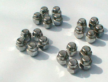

OEM Acorn lug nut: 0.074 lbs each
OEM 3rd gen open ended lug nut: 0.060 lbs each
Drag Aluminum lug nut: 0.046 lbs each

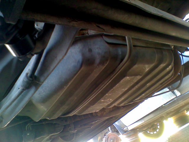

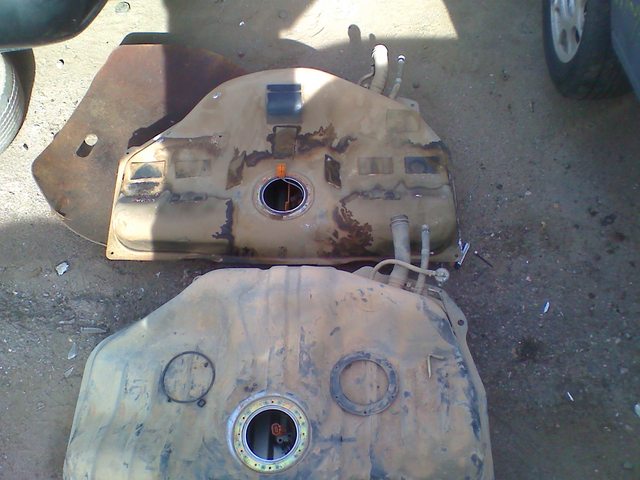

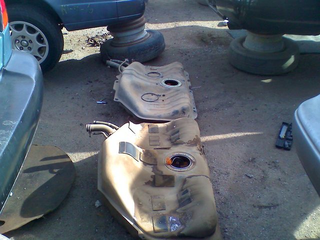

I've been kicking around the idea of a smaller fuel tank. Checked out a 13.2 gal B14 gas tank.
Hoses line up just fine, though I just realized I forgot to check the access cover once I had the B14 tank 'mounted' on the A32. Oops.
B14 tank bolts to the unibody around the perimeter of the tank.
A32 tank uses two straps running underneath the tank.
The fuel tank strap on the driver side bolted up without much hassle. The passenger side strap wasn't so easy.
A32 FSU has one more sensor than the B14. I'm doing some FSM diving to see what it is. I'm thinking fuel temp. Due to that, the B14 FSU has one less pin on the fuel level sender connector.
The return line on the B14 FSU is connected to a hose whereas the A32 just has a tube going into the tank.
B14 FSU
A32 FSU
B14 top
A32 bottom
Hoses line up
At this point I was just tired of messing with it. The tank was hitting the exhaust heat shields and possibly the evap stuff too. So a custom mounting soultion would be needed to mount the tank level.

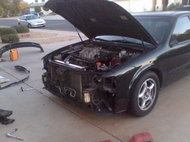

Hmm I'm not a fan of the new front bumper, but I'm assuming you're doing this for MPG purposes?

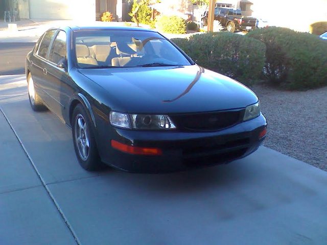

Its going to take some getting used to. I am going to reinstall the clear turn signals soon.
MPG is the reason behind the 95-96 bumper. My old bumper was done, peeling clear coat, fading paint, bondo from an accident 15 years ago was cracking. So its time for a change that may help with the sleeper look I'm going for.
Snagged this one up in pretty good condition for only $20 with the grille and AL bumper support.

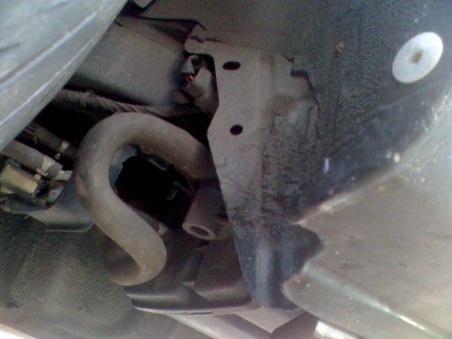

Upper radiator hose just blew out on me
Original equipment?
Didn't leave you stranded, did it?

Yes and yes. Pulled over as soon as I saw smoke coming out of my hood. Popped the hood and was greeted with the classic cloud of white smoke and coolant all over the place.
The timing sucks though since I also need to replace the water pipe gaskets on the front and rear heads, but Nissan is closed today so I can't get the gaskets.

Funny you say that. It happened on my way back after dropping him off at his friends house last night.

Much better

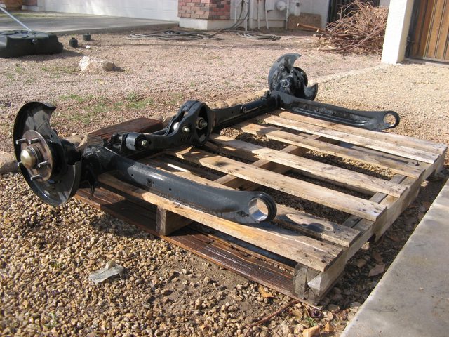

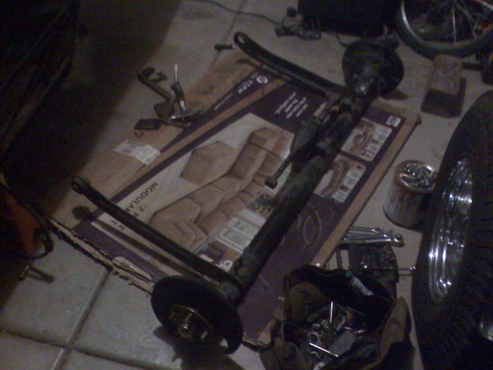

Rear beam = 74lbs
Progress RSB w/ all mounting hardware = 16lbs
With half of the RSB weight being unsprung, that's quite a bit of weight. Makes me curious as to what the FSB weighs.
